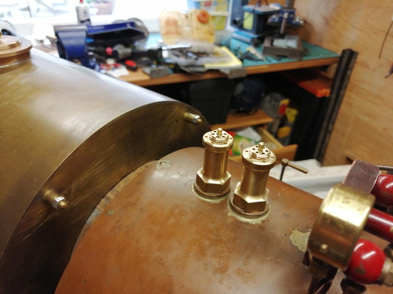

New safety valves will also be ordered from Blackgates as the current valves fitted appear to be home made and not up to the job as to pass the steam test I had to set them to blow off before 80 PSI so they could release enough pressure with the blower on full whack.

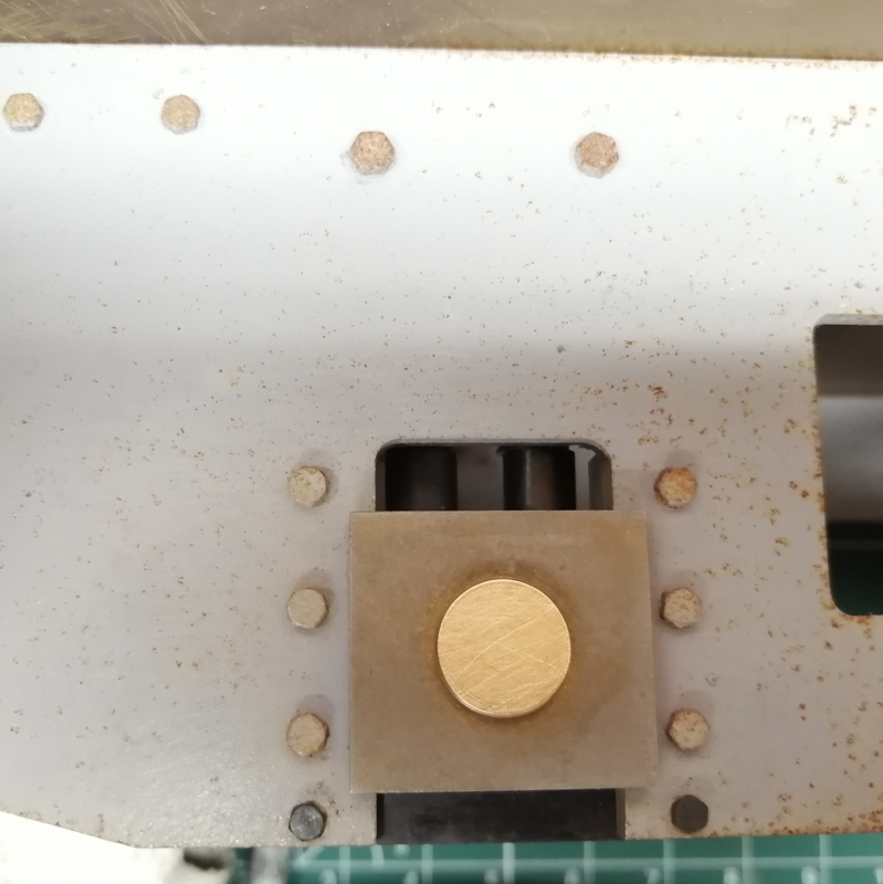

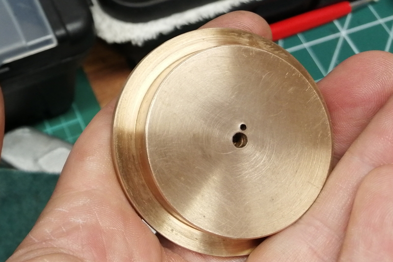

The plug for the saddle tank is so well made that the seal it creates is too good and when the loco is hot it does not sit properly due to pressure. I have drilled a small breather hole that you can hardly see:

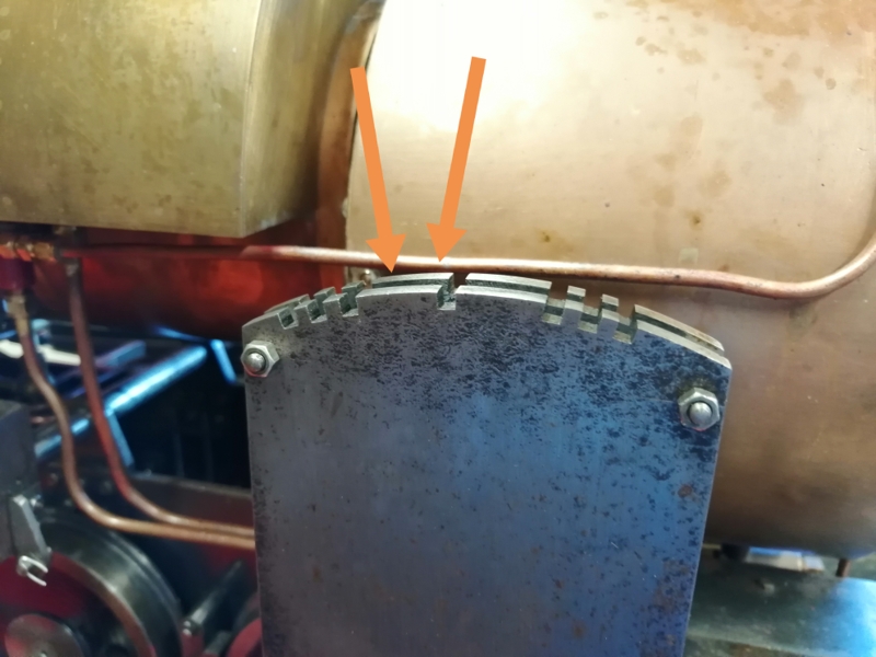

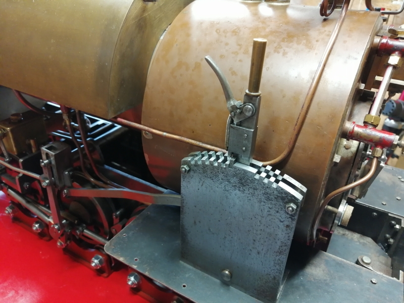

The reverser frame needs more forward gear notches as it runs so well:

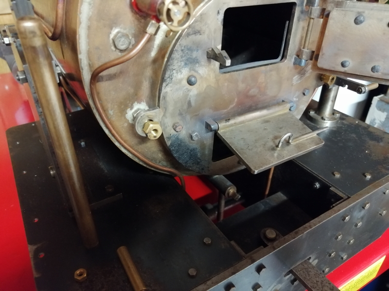

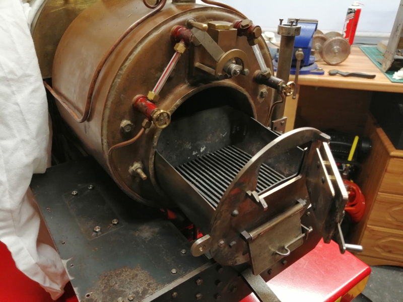

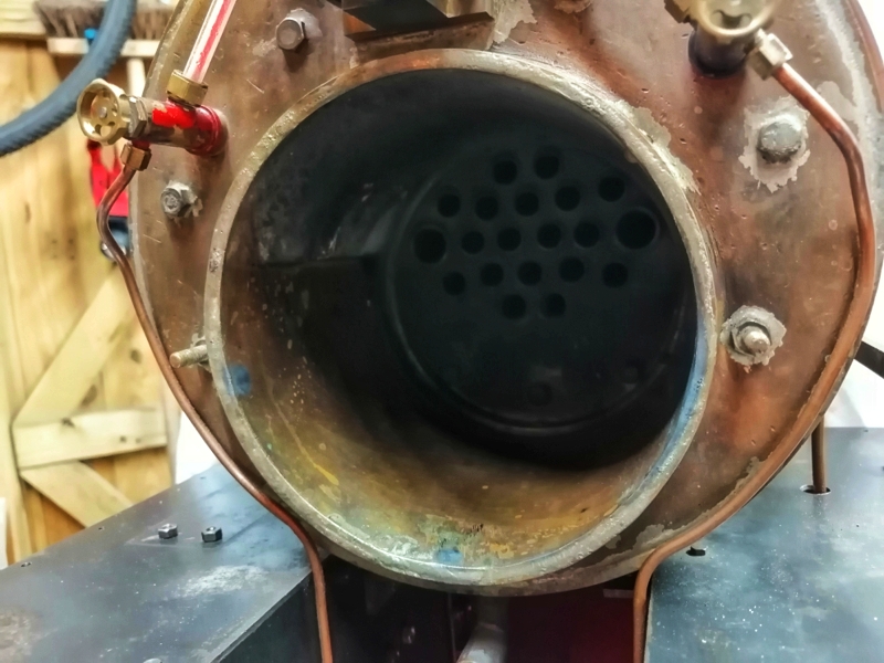

And finally, the firebox needs nuts that can be turned by hand incase it needs to be removed quickly (also an ashpan required to sit in that space where the drain plug can be seen):

You can expects a few things need doing after the first real runs especially when the build was initially not your own. I suspect some of things things you would have done differently. One thing I dont quite understand why would you need to remove a firebox quickly can you not simply drop the fire?

The Sweet Pea boiler design isn't a conventional locomotive type boiler, it is based on the Bagnall drumhead design, which has a marine type firebox.DonW wrote: Sun Sep 22, 2019 8:19 am One thing I dont quite understand why would you need to remove a firebox quickly can you not simply drop the fire?
You can't drop the fire into the ashpan like a conventional loco boiler, as the firebox is cylindrical and surrounded by water. The only way to remove the fire from the boiler is to take off the dry backhead and rake the fire out the back of the firebox.
ps. This Wikipedia article describes the marine boiler type that the Bagnall boiler was based on....

Thanks for that. It would be a bit awkward simply dropping a fire in a boat.

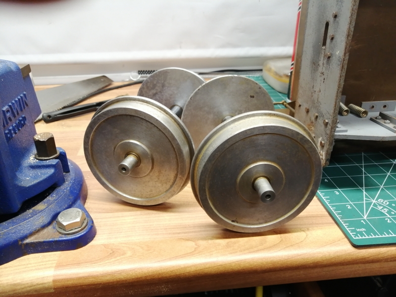

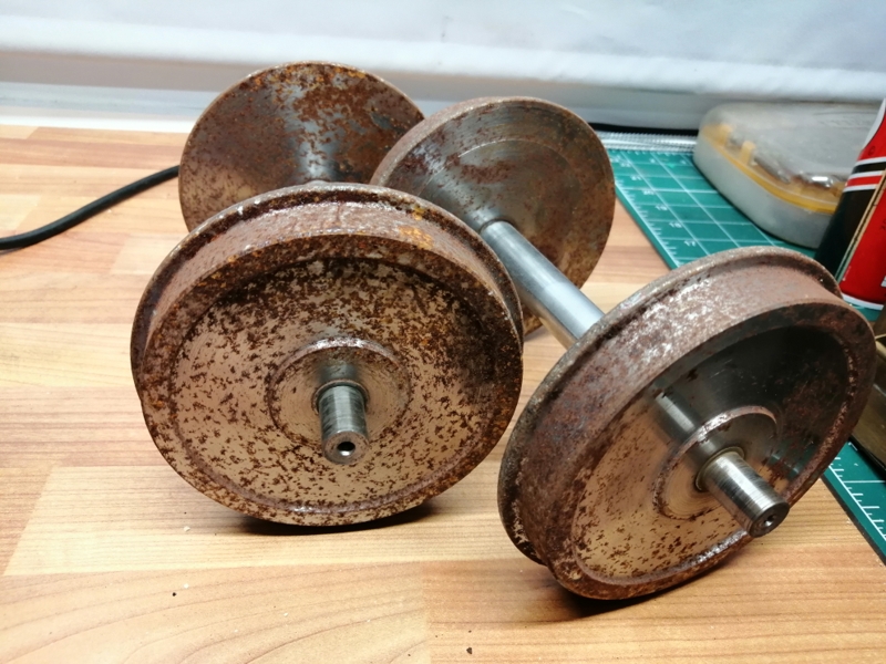

Did you spot the wheels in the last post?
These are for the tender and as you can see they need a clean!
I have tested removing rust using white vinegar (soaking the parts overnight) and it's proven effective so far, hopefully it will work on the wheels.

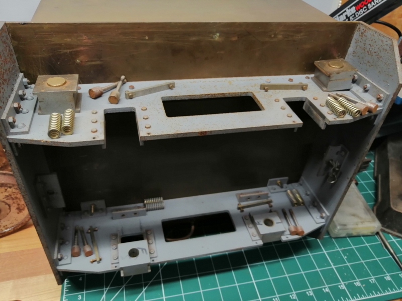

Here's the underside of the tender (paint needs stripping and parts cleaned up):
I don't know if I will ever use it, however, I am restoring it to test out my chemical blackening ideas for the loco.

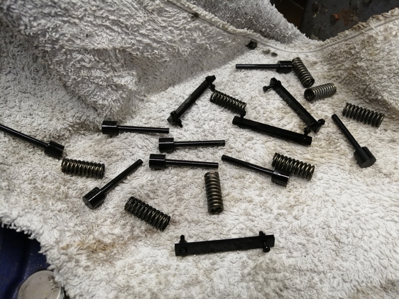

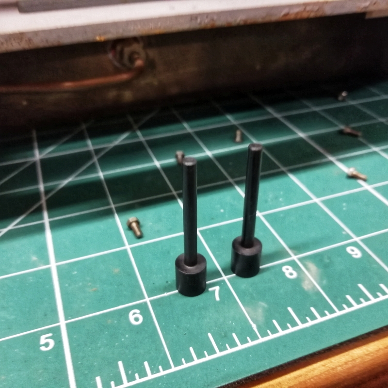

First go using a proper four stage chemical blackening process, these parts are for the axle boxes on the tender:

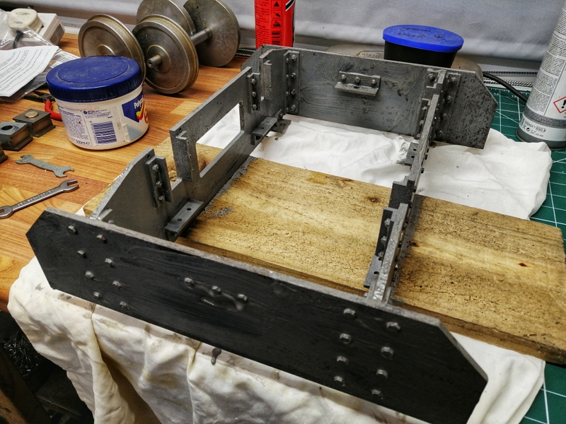

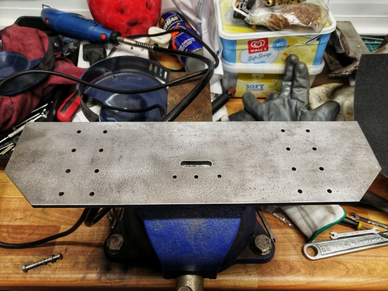

The tender frame was undercoated with grey primer before I owned it to protect the metal although surface rust had developed. I applied paint stripper over the frame and left it for 24 hours:
To aid grinding the chassis back to metal I dismantled it and got one of the buffer beams cleaned up (not a great picture, the metal is brighter than shown):

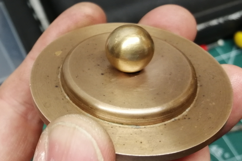

On the loco front, new commercially made safety valves by Blackgates Engineering have been fitted and steam tested. These are 'progressive lift' type which means they don't blow off violently like pop safety valves but still close quickly once pressure has been released:
Each valve has a locking ring so that once set to blow off at the desired pressure they cannot be tampered with unless the ring is unscrewed.
Also, the reverser has been refitted after extra notches were added:

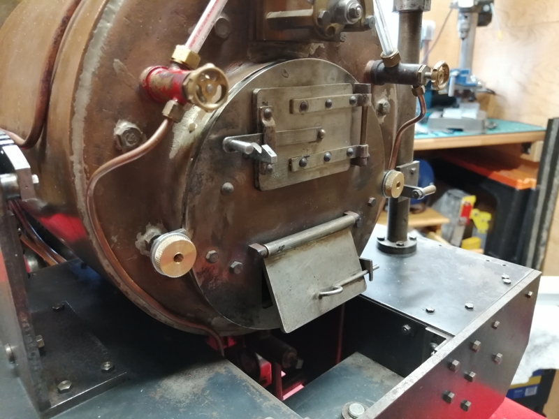

And the firebox nuts have been replaced with knurled nuts so they can be easily undone by hand (with gloves) if the fire needs to be removed from the boiler quickly:

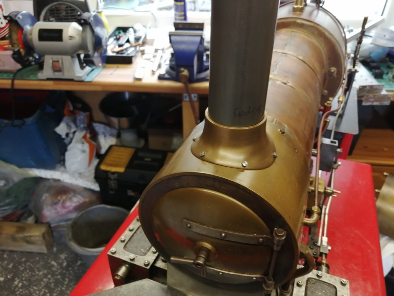

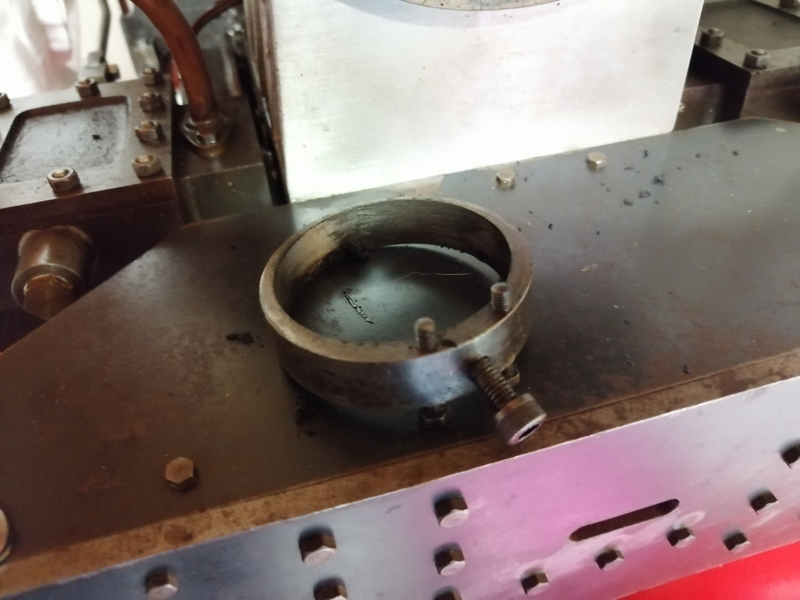

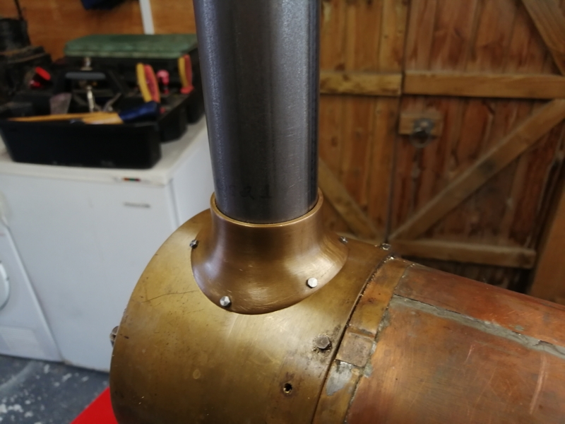

The chimney as supplied was secured to the smokebox with this clamp (the clamp attaches to the bottom of the chimney inside the smokebox):
In practice, with the fluctuations of tempature and the movement of the loco on the track this clamp did not hold the chimney securely.
So, the smokebox was drilled and tapped to take BA bolts:
