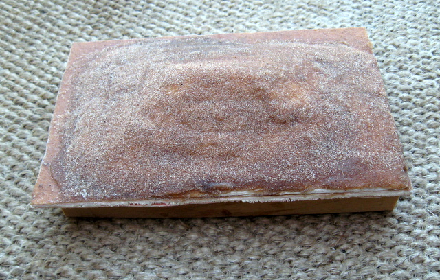

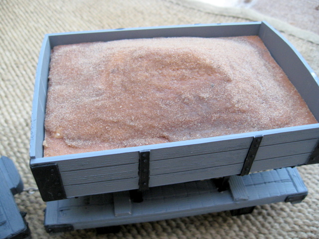

One point, are the loads sand glued to inserts or some other miracle from the Rik workshop ?

Piece of ply with either a sculpted balsa block or a piece of foam packaging suitably crumpled and covered in sand. Nothing fancy. Removable so I can run the wagons empty Down the line and loaded back up.

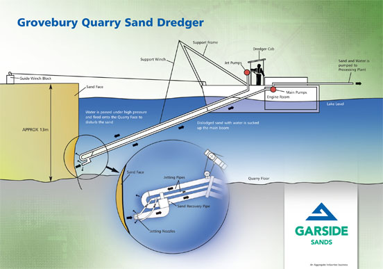

Just had a quick look around to see what I could see regarding sand loading and came across this little gem from Leighton Buzzard. Now you could build a dredger and divert your stream to fill a quarry....! (I'll get my coat)
DREDGER 3422 GARSIDE BOARD. By kind permission Garside Sands.jpg (64.33 KiB) Viewed 13170 times

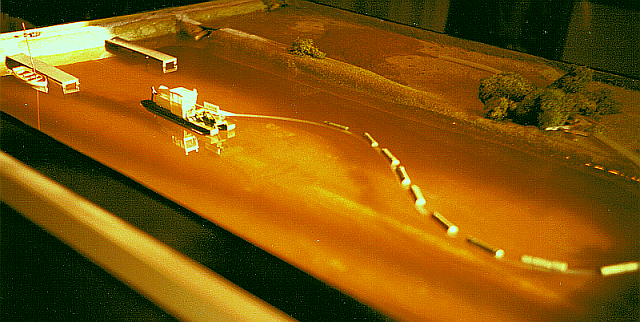

Actually, many years ago I was commissioned by a dredging company to build a working 4mm suction dredger almost exactly like this, for their trade stand at industry exhibitions. They specialised in dredging rivers and ornamental lakes, etc.

That does look interesting. I wonder what sort of pump mechanism would be able to cope with all the abrasion?

That's something that has always intrigued me, the abrasive nature of sand must play havoc with any kind of pump yet obviously it's done regularly. Perhaps the mechanisms are just frequently replaced, anyone here have any ideas?

Well for this little model, I used a standard car windscreen washer pump, and for the sand I used N gauge brown "magnesium ballast". It did grind a wee bit but worked well, I've got no idea how long it lasted but they never complained or asked for their money back! The pump was hidden below board level under the clump of vegetetation and discharged onto the flat 'bank' area and the water simply ran back into the pool - spoil fan can be seen towards the back LH corner at the end of the pipe. If you look carefully the lighter coloured dredged trail is just about visible under the water. The dredger itself was rope hauled from side to side.

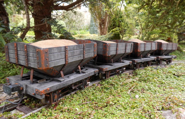

Now managed to weather four of the wagons. Slow process, but quite satisfying. Also adding brake gear as I go.

I felt a gasp in my breathing when I saw the finished articles Rik.... they are just amazing! You have mastered the weathering process with 'Honours', we need a 'how to' from you now.
Top marks... again!

Very kind of you Peter. I'm still experimenting with weathering, not sure I've mastered it yet, but it's very encouraging to have this sort of feedback.

Lovely job, all round.
Re: Sand hopper
Post by tom_tom_go » Tue Apr 16, 2019 12:19 pm
That's the first plastic wagon I have seen with wood painted that achieves that elusive silver colour, well done.

The wood looks like wood and the wagons present a most realistic appearance. Well done Rik.

Wow! Those are absolutely fantastic, well worth the effort...
