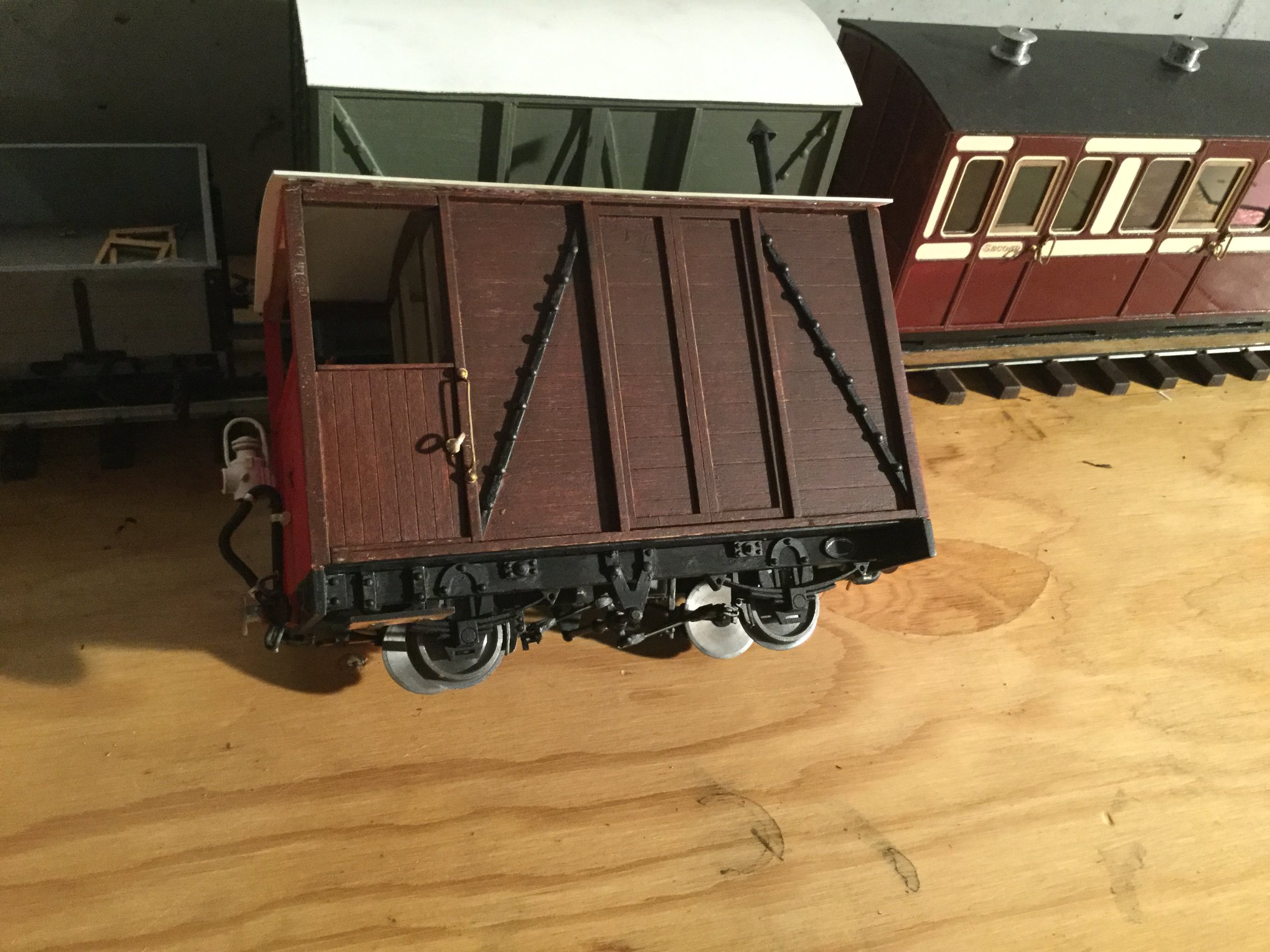

Keith S
Posts: 1668
Location: Canada
Re: Multiple small projects
Post by Keith S » Sun Mar 24, 2019 2:02 pm
Thanks Rod. Building models is a pretty solitary pastime where I live. It's nice to have the ability to share it with others even if it"s just in the internet.
I've finished the brake rigging on the guards van. It's hard to see because it's all black, but there's a Brandbright vacuum cylinder under there as well as the bellcrank and rods connecting the brake shoes to the central shaft. The rods are built up out of wire and card.
and also put some on the box van as well. This one has the flywheel device mounted under it so there isn't space for as much detail as the guards van, but I put an external lever on it from IP engineering and the central shaft in this case supports the flyywheel mechanism on one end. The brake shoes and external lever do a decent job of drawing the eye away from the protruding flywheel housing.
Haven't decided on how to colour the wheels yet, but I reckon I'll pick up some gun bluing next time I'm down south and give that a whirl.
