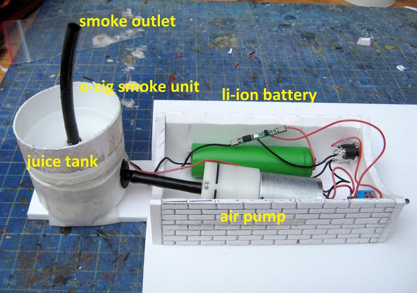

Just been experimenting with a smoke unit for the boiler house, following the excellent guidance on Dave Bodnar's website - http://trainelectronics.com/Animation_Smoke/
URL - https://youtu.be/qeKCpGfyUlE
Many thanks to Gregh for alerting me to this info.
Not quite there yet - it's a balance between getting a good amount of smoke and making sure it's projected upwards. This video is unlisted as it's onlyexperimental so far - will post a public one when I'm satisfied with the outcome.

Many years ago I experimented with a Seuthe smoke unit. I found that glycerine worked quite well but did tend to leave an oily residue on everything the smoke landed on. The trouble is that synthetic smoke particles tend to be heavy and settle quickly, rather than going up and away, and I see signs of that in your video. I'll be interested to see how you overcome that.

philipy wrote: Fri Jul 06, 2018 6:19 am Many years ago I experimented with a Seuthe smoke unit. I found that glycerine worked quite well but did tend to leave an oily residue on everything the smoke landed on. The trouble is that synthetic smoke particles tend to be heavy and settle quickly, rather than going up and away, and I see signs of that in your video. I'll be interested to see how you overcome that.
Hi Philip
Yes, I'm using glycerine as well (which I believe is the basis for e-cig 'juice'). In the final clip you'll see I've managed to project the smoke upwards, by lengthening the output tube. However, if the tube is longer, the glyerine condenses in the tube, so I'm trying to find the optimum length for the tube.
More info about the approach on Dave Bodnar's video.

Put a fan in the boiler house to blow it upwards?
You would only need a little PC CPU fan...

ge_rik wrote: Fri Jul 06, 2018 8:11 am However, if the tube is longer, the glyerine condenses in the tube, so I'm trying to find the optimum length for the tube.
The 'smoke' generated by Suethe units, etc. is actually small droplets of liquid suspended in air (an aerosol), rather than solid particles like smoke, so any surfaces it touches will end up wetted with whatever is used for the working fluid.
The fog machines used for special effects on stage and screen have an internal heating tank and use a small fan to blow the resulting aerosol out of the exhaust. Here in Oz, Jaycar sell a small 400w unit for under $100. From memory they use a glycol/water solution as a working fluid.

The unit I've built, following Dave Bodnar's guidance, includes a small air pump to simulate the sucking of an e-cig, except that it's arranged to blow over the heating element.
