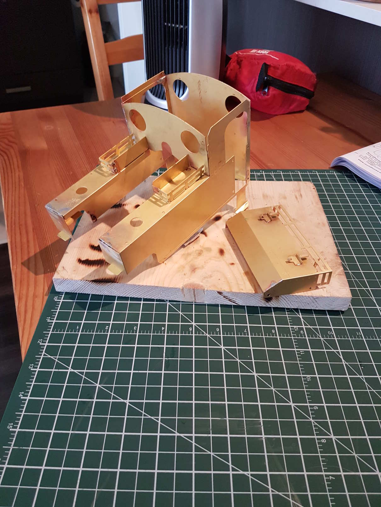

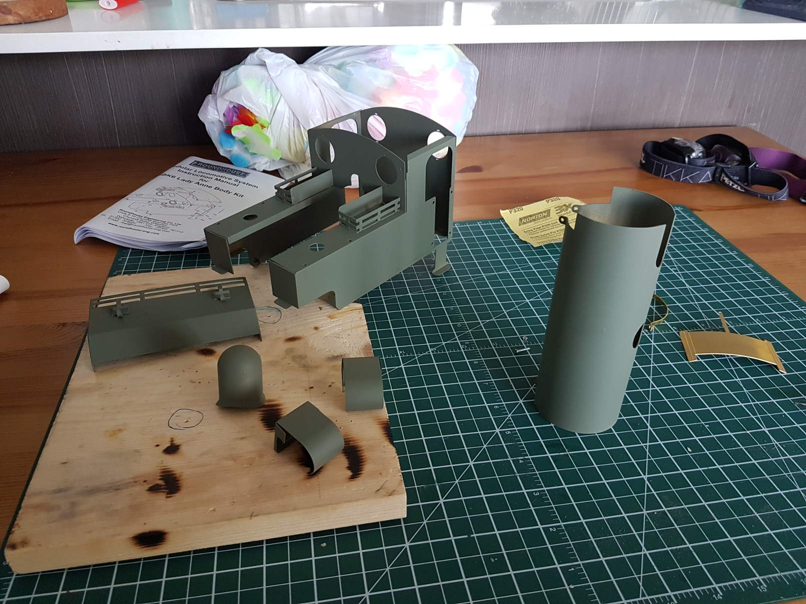

A bit more progress. The plan was to paint the boiler wrapper and than proceed with the build so that I can steam test the loco. However, I realised that the fancy 2K paint has a pot life of only 8 hours or so once you mix the components, so I'd be wasting a $35 can of paint just painting the wrapper. Much better to bite the bullet and solder up the body so that I can top coat everything at once.
The gaps at the front of the tanks are a little larger than I'd like, but I don't think I can get it any better as, due to the design of the body I couldn't quite bend the fronts to 90 degrees. This meant that I had to clamp it as tight as I could to hold it in place. Trying to 'fill in' the gap with solder just resulted in the joint popping off. Still, the joints are all pretty tidy, at least from the outside! And all etch-primed. Maybe it's a WD loco...!
I've not decided whether to do the the cylinder covers black or the same maroon as the body yet...

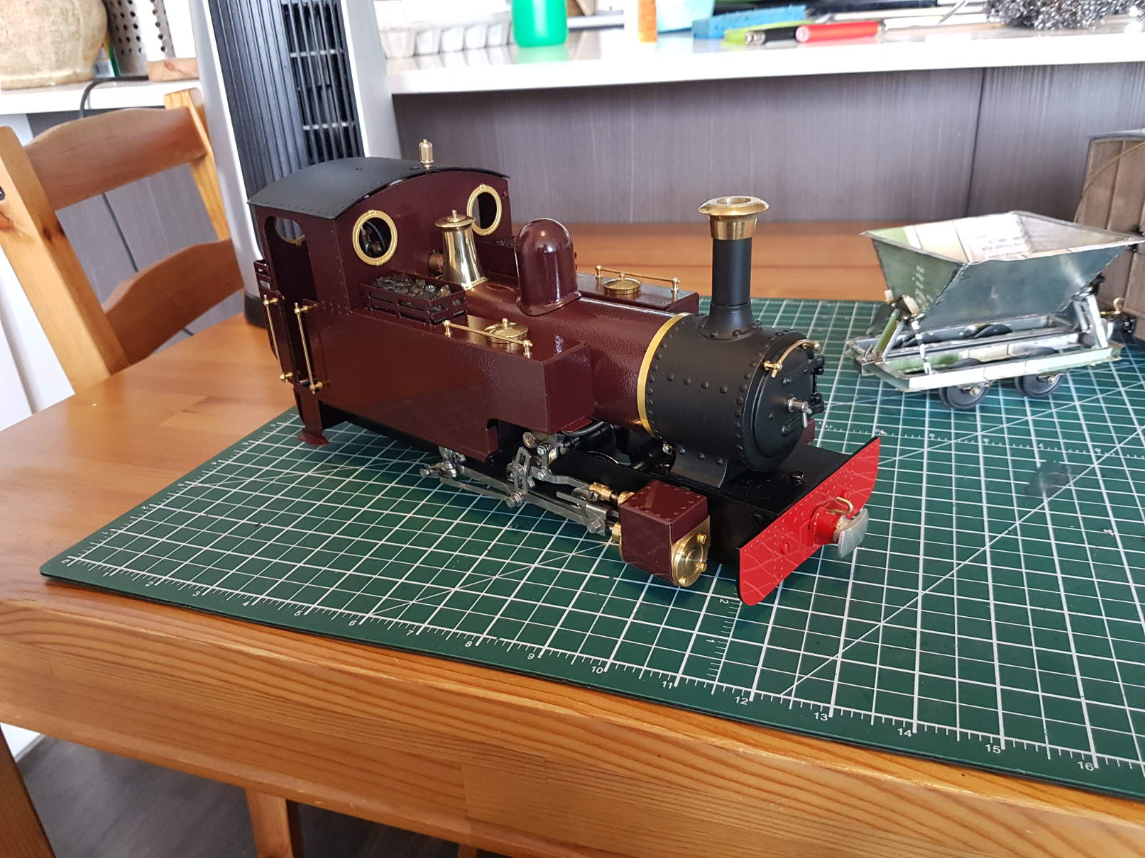

Ta-da!
Now all I need to do is test it and start the fettling/adjusting process. I might get the chance to run it on blocks this afternoon or one evening this week. Unfortunately I wont be able to run it on rails until at least next weekend.
Pretty pleased with it. Bending up the pipework in a way that still allowed the body work to fit over was pretty tricky. I think the copper was thoroughly work-hardened after my numerous attempts at getting everything to fit properly. I did try re-annealing it with my blow torch to soften it again, but it didn't help much. Any advice here would be appreciated?
Can't wait to run it and see it in action!

That is a nice looking job you've done, you should be well pleased. Hope it runs as well as it looks.

Grant is right, that's quality workmanship. I LOVE the livery!

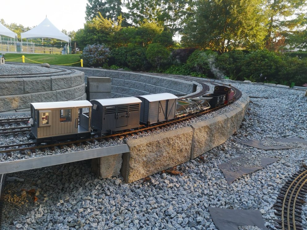

A very pleasant afternoon yesterday running at a local garden centre layout, which is very generously open for public running. Attempting to share via Google pics in light of changes in photobucket policy:
https://photos.app.goo.gl/YHslRa9wAbkbP1052
In other news, a passenger was spotted sniffing around the station whilst the R&S LR was in service. Being prone to getting over excited and putting the horse before the cart, the director of the R&S LR has ordered that passenger capacity be greatly increased, and, as reward for generating such huge public interest, the director should have his own coach. As a result, the R&SLR rolling stock department have made great progress on the two outstanding Brandbright coach kits in the last few days.
Re: The Reading and Squamish Light Railway Stock Thread
What a great build and brilliant videos, the photos of it running at the garden centre are brilliant too.
Although i was a bit worried about those people putting their hands over the steam, did they think it was artificial..

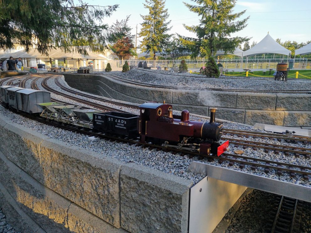

Dusting off my old thread!

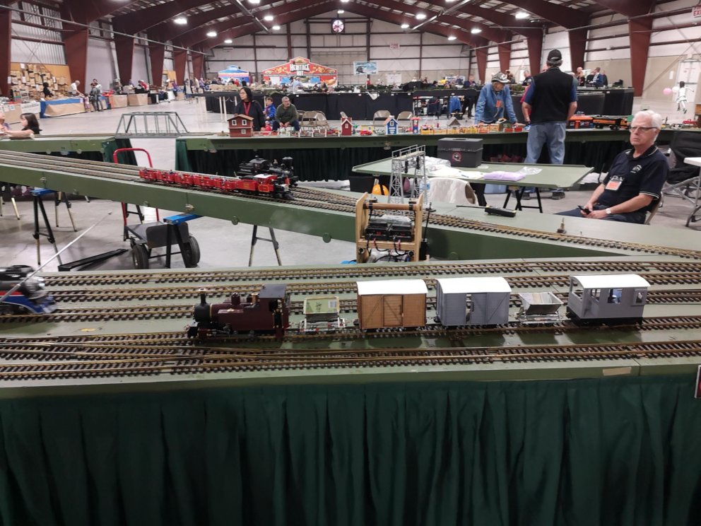

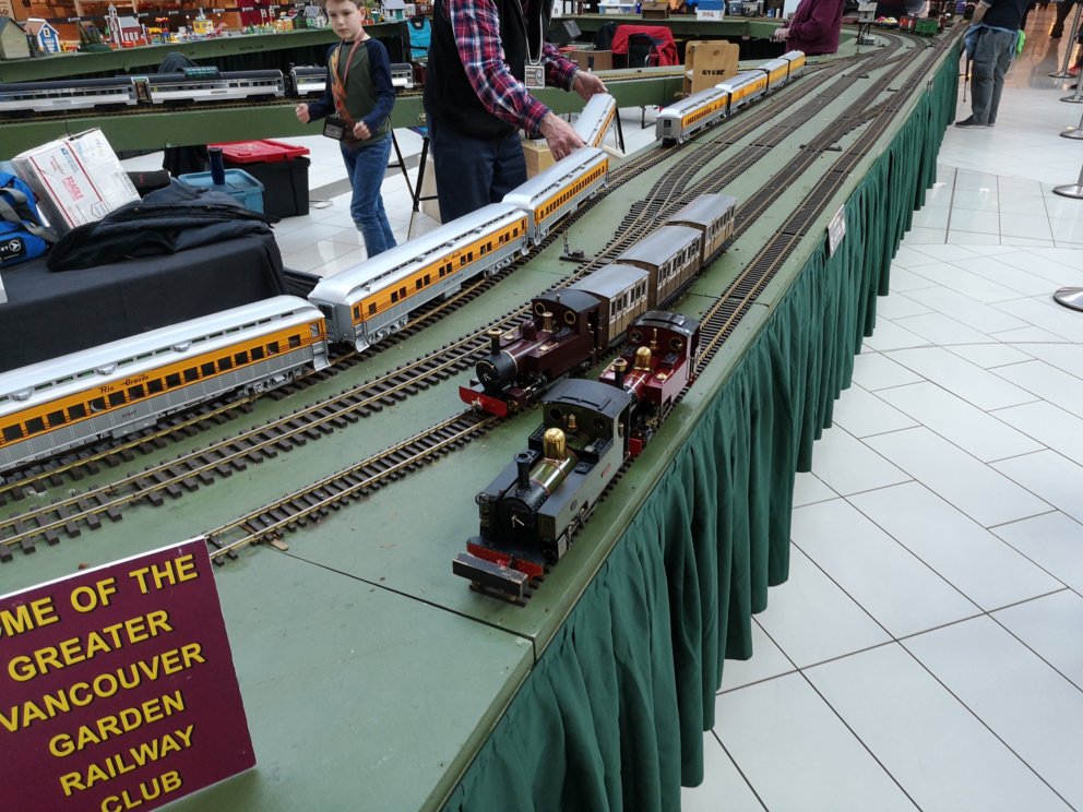

The Reading and Squamish Light Railway has grown considerably since the last update. I had originally told myself I would limit my stock collection to what would fit in two plastic totes. Needless to say, that day has come and gone and I now have to plan ahead regarding which stock to bring with me when visiting railways.
Some photos taken both on a local travelling modular layout, and on the permanent layout of the local model engineering club.
Glad to see 'the loco that was built in an apartment' is still going strong!
Great photos Ted.
That modular layout is HUGE.......
