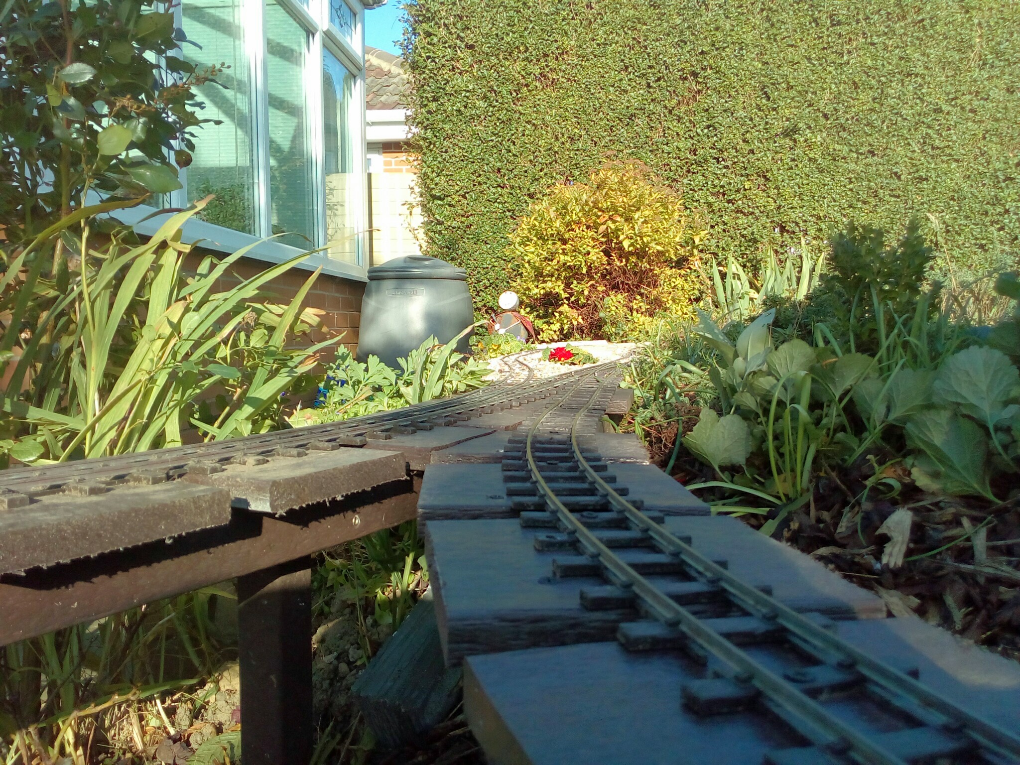

A little further! I need to sort out ordering more Filcris before too long but the lads have cracked on regardless and all 3 roads are connected up and secured on temporary battens. It wont be too much of a job to pop the top deck sections in place, and then re-jig and secure the track at a later date. I may ease the curves a little bit at the same time but will wait for a nice day when I can get a loco in steam and do a few run throughs beforehand. Starting to all come together a bit now, the Gaffer will be pleased!

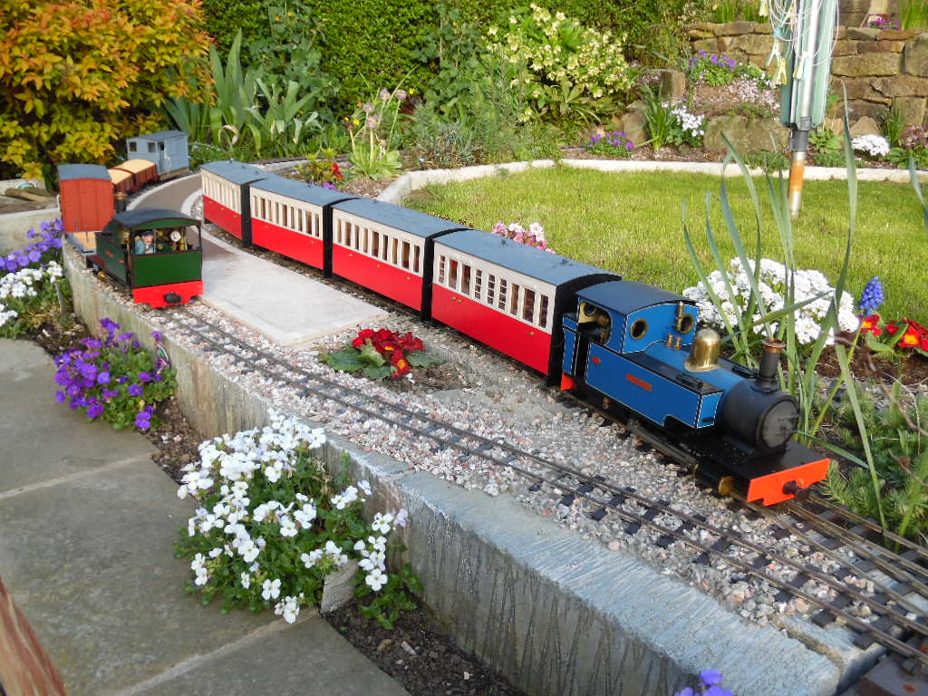

Thanks Tom and Daan, I've done quite a bit in the garden since I moved in a year ago, always mindful that I wanted a railway, as it happens, it's all happened quicker than expected! I had a cat until recently (he was just short of 21) but know what you mean about dogs, and I'm very watchful when the grandkids are visiting, love em to bits but......!! Welcome to the forum Daan, I'm sure you'll find as much help, inspiration and knowledge as I have. A couple more piccies to hopefully whet your appetite....
The afternoon Passenger gets underway from the (very) recently laid Hollycross platform, as Albert waits to follow with a Goods train, providing of course he manages to get some pressure up...
Looking the other way, you'll see the recently documented steaming bay and THAT tree in the distance, so get an idea of the general layout of things. Cheers for now!

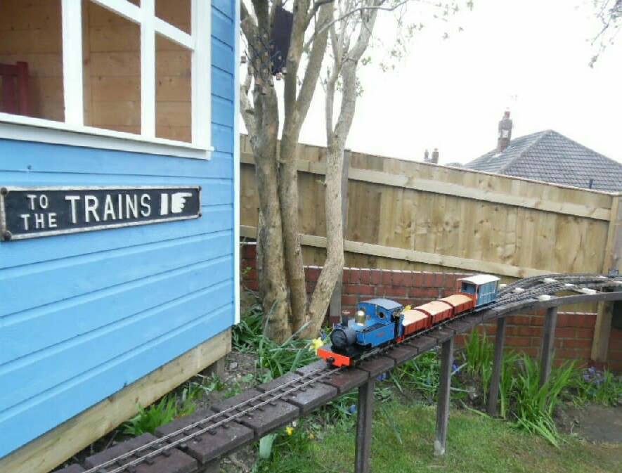

Well, a very bright, sunny day yesterday turned thoughts towards raising steam, so the gap between the two sections was bridged (very!) temporarily to allow NOBBY to have a trundle round with a few wagons. It wasn't long before inquisitive neighbours turned up resulting in an Easter egg! and quite a few free plants for the garden. Nice one!
And guess who had to get in on it all!.....

Even the very temporary bridge looks solid , apart from the clamps that is.. :lol:

As I've said elsewhere, I just tend to get stuck in without too much planning then just 'make it work'! The temporary bridge is a bit of spare floorboarding bought for the roof of the summerhouse I built. It does look a bit precarious but was actually also resting on some screws too so sits quite stable even with the train rattling across it. When I do the bridges 'proper', they'll be a lot more secure! The crossing is shown in the very first photo back on page 1, or at least the relevant breeze block is shown. Then scroll down that page and you'll see that any stones I dug up were thrown either side of it as hardcore for the path that followed. I laid the flags on a sloppy cement base, tapping them down to be 'as near as' level with the track railhead either side. I then simply threw cement into the gap between the flags, covering the track, smoothed it off with the trowel, ran a screwdriver against each rail to form the flangeways, and waited for it to dry off. When it was nearly set, a damp sponge and old paintbrush tidied it up and the result is as seen. Easy really! As the ladies in the BOOTS advert say, Ta Da!!
