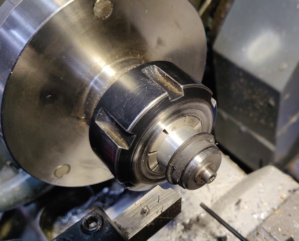

I did actually try turning some of these plastic wheels. The surface finish left a lot to be desired. The form tool has clearances but no top rake, not very sharp, so probably not ideal for plastic. This was with some matte black filament though. Turing the grey stuff seemed to go a bit better. Might give it another go this weekend. If the wheels are painted black before turning, the turning will expose the grey on the treads and flange, might look a bit nicer for not much effort as well.

I use the G1MRA coarse profile, which is pretty much the same as the SM32 one you use. I use a simple rounded tool to turn the tread and form the flange root radius, then a file to chamfer the back and round the outer corners of the flange. Form tools and I don't get on well.
I've never machined any printed plastic parts, but FDM prints are effectively sintered plastic, so I wouldn't be surprised if they won't machine all that cleanly. I've seen solvent used to smooth out the surface on FDM prints, so see no reason why it wouldn't work to smooth out the tread of a printed wheel after turning.

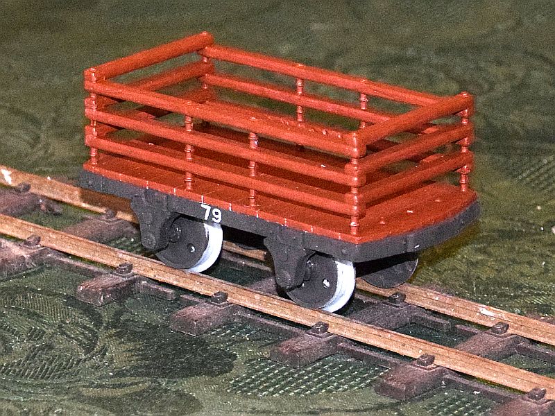

Interesting idea to print wheels in grey plastic and leaving the tread unpainted. The only plastic wheels I use are Binnie curly spoke type on timber bogies. The wheels are moulded in black, so I paint the treads a metallic grey. They look good for a while, but the paint inevitably wears off.

I tried this once, using the resin printer rather than FDM, and wasn't over happy. The resin is a bit paler grey than many filaments, and the black is only crudely applied, but it doesn't look realistic to my eyes.GTB wrote: Sat Jul 02, 2022 4:13 pm

The light grey looks more like aluminium than steel. In the distant past there were aluminium wheels avaiIable in HO, which were all I could get at the time. They looked awful and I rapidly changed to blackened brass........philipy wrote: Sat Jul 02, 2022 5:49 pm I tried this once, using the resin printer rather than FDM, and wasn't over happy. The resin is a bit paler grey than many filaments, and the black is only crudely applied, but it doesn't look realistic to my eyes.
Treads need to be dark grey, metallic if possible and I now use Humbrol #53 when I paint log bogie wheels. I tried Humbrol #27003 'polished steel' from the Metalcoat range, which looked good when newly applied, but wore off too rapidly to be useful when run regularly. The bogie in the first photo was done with Metalcoat, but I couldn't find a closeup of a more recent build. The second photo shows wheels painted with Humbrol #53, but out on the track.
Paint sort of works for rolling stock, but I'm not sure I'd use it for locos. I think it would be gone the first time the wheels slipped.
