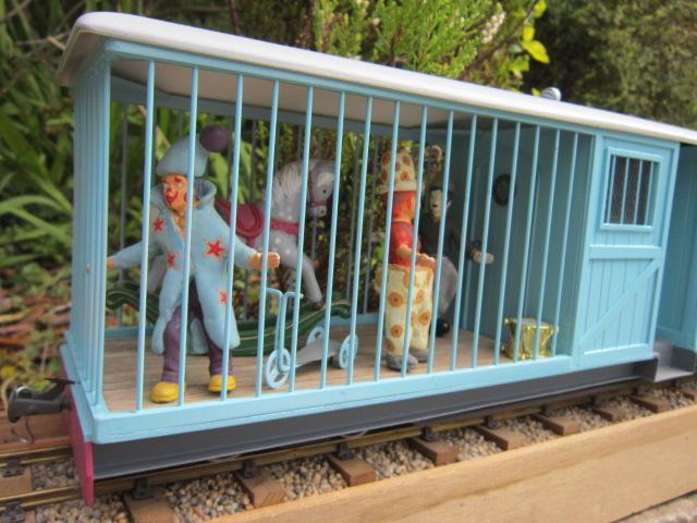

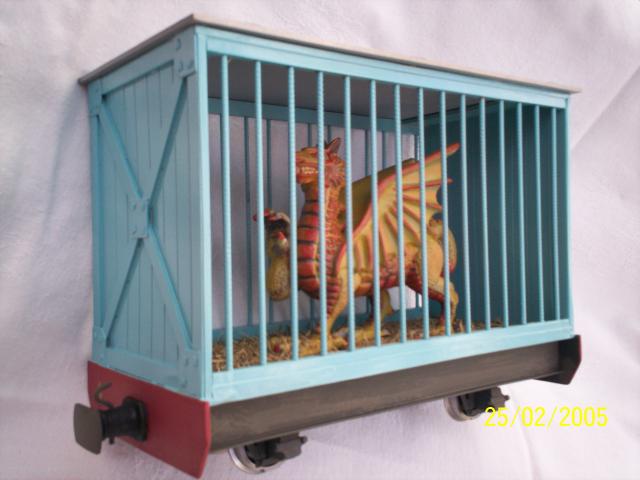

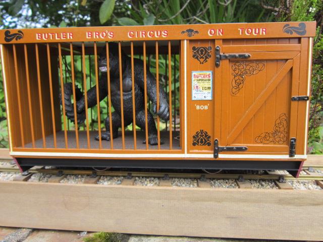

I have to plead guilty to inspiring Keith to build a Circus train.
He saw my 'Dragon Wagon' at one of the meetings and set out to search for a suitable dragon.... preferably Welsh! During his searching he also discovered other animals which were deemed appropriate also figures which could be turned into clowns etc.
My own Circus Train was sold off many years ago but here are some pictures taken of individual items...

Looks like a lot of fun. I think I need a clown car like that for my kids!
- Posts: 5731
I hate clowns really but they are an important part of circus performers. The figures were just kid's action figures which I altered with modelling clay and painted features and costumes. I also built an elephant wagon which I used to load test a bridge on my railway...

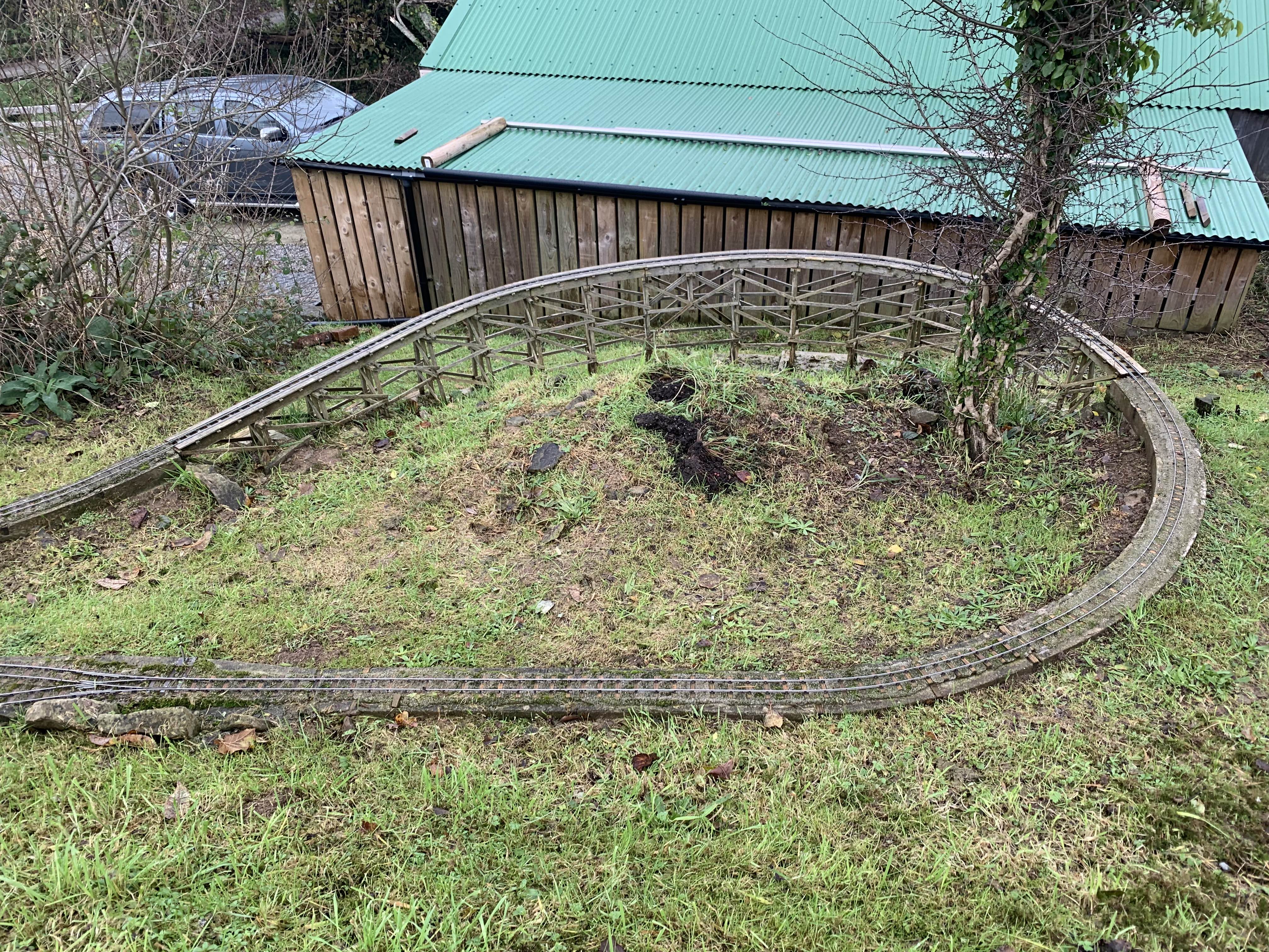

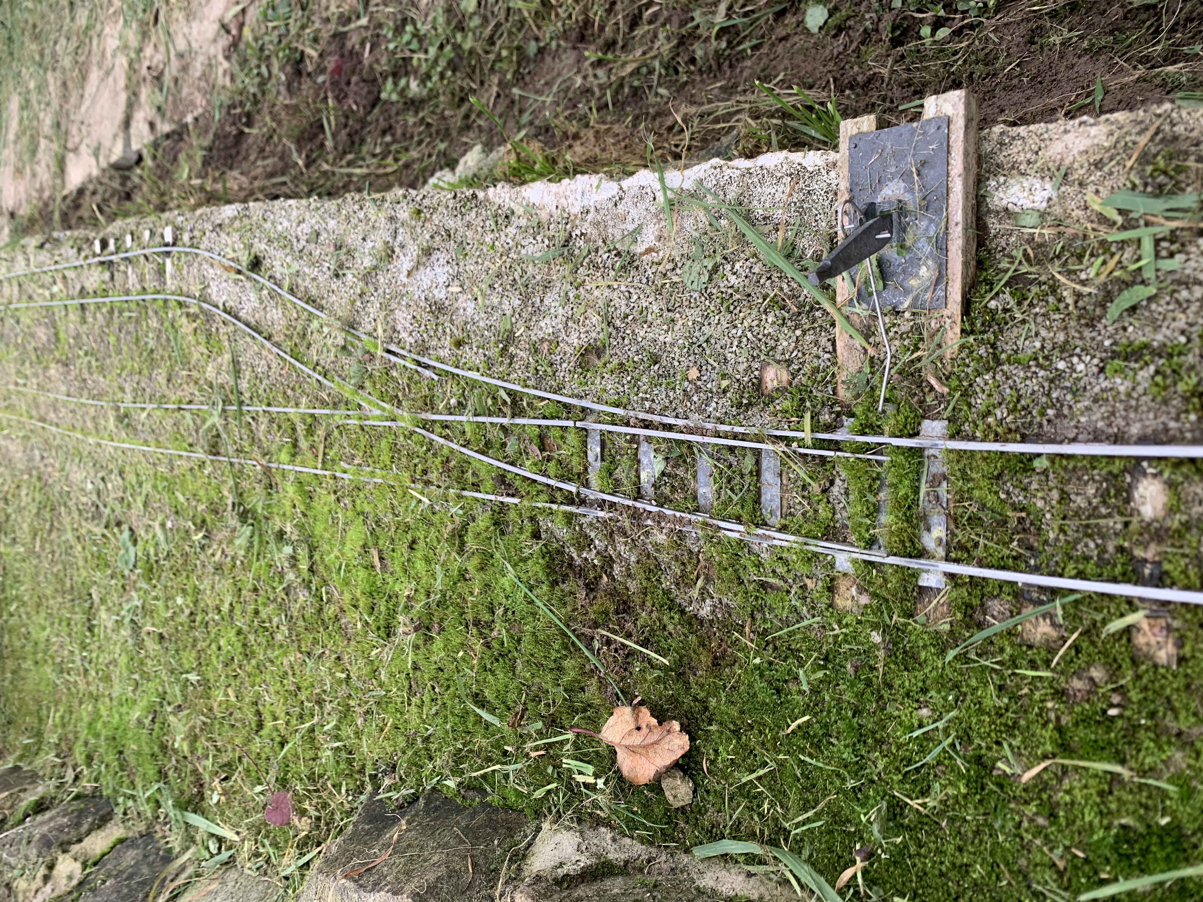

I have found the railway again!
After an absence of almost 2 months I came back to a fairly overgrown garden. It took 2 days of strimming to uncover the railway and get most of the grass down to a mowable level. The next problem was the amount of moss growing through the track. You can see in the following photo the effect. Each point required the flange ways clearing with tweezers. The moving blades were also jammed solid with the moss:
The worst of it has been removed with a wire brush and of course the tweezers where necessary. That has allowed trains to run the full length of the track - ready for Phil's visit on Monday. So the immediate problem is solved, but something needs to be done for the long term.
An internet search has identified that the moss can be killed (and other plants left unharmed) with sodium bicarbonate, mixed 2 oz of bicarb to 2 gallons of water. So a watering can will be able to deliver it.
However I detect an opportunity to create a track watering wagon! That will be a much more interesting way to apply the solution on a regular basis.

Honestly that look is such a vibe, yes it makes running trains harder but it looks very 1950s Talyllyn. Try not to get rid of too much moss, running heavy stock should get rid of enough out the flangeways.

Get the 12" to the foot kettle out!
A dribble of boiling water, along each rail will kill the moss off.
Possibly not as much fun as a weed-killing train, though?

Honest - it has to go! Nothing is heavy enough to force its way through it.tommygander1941 wrote: Sat Nov 02, 2024 3:34 pm Honestly that look is such a vibe, yes it makes running trains harder but it looks very 1950s Talyllyn. Try not to get rid of too much moss, running heavy stock should get rid of enough out the flangeways.
- Posts: 1196
I hear vinegar also works - though it might turn your rails green with oxide.

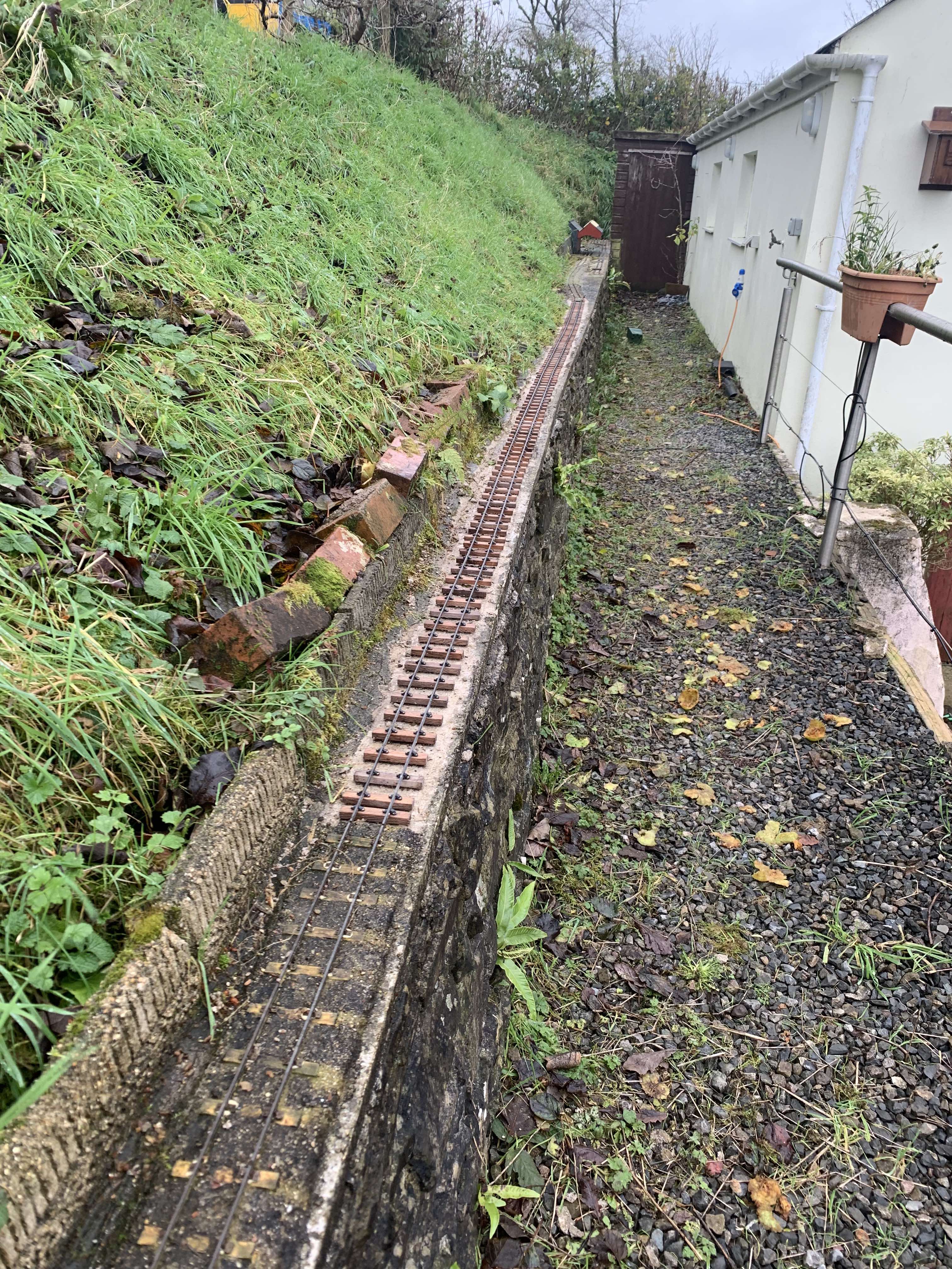

I have started on some winter maintenance.
The oldest track on the line is showing its age. It has been in place for over 10 years. Many sleepers are rotting, and many chairs have lost the pins which hold them to the sleepers. This is 6 1 yard lengths where I have rebuilt the track with my own printed chairs, and hardwood sleepers kindly made for me by Gilffach Phil. I have always soaked the sleepers in preservative - and these have been given the same treatment:
There is more track to be rebuilt in the terminal station.

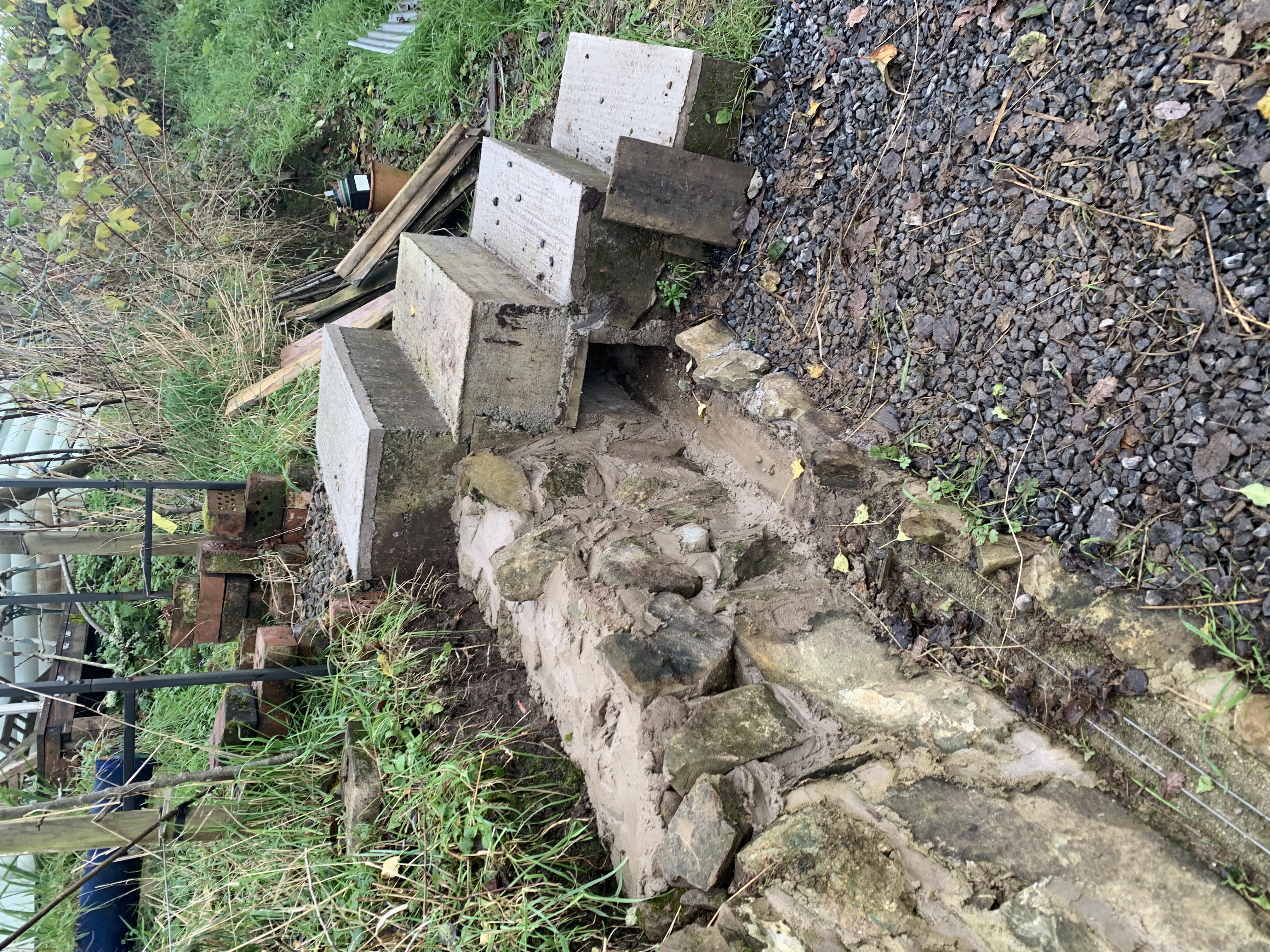

As well as maintenance I am back to "the extension". The tunnel leading into it is finished, the steps repaired, and the wall almost complete:
The upper terminus is now in my thoughts.

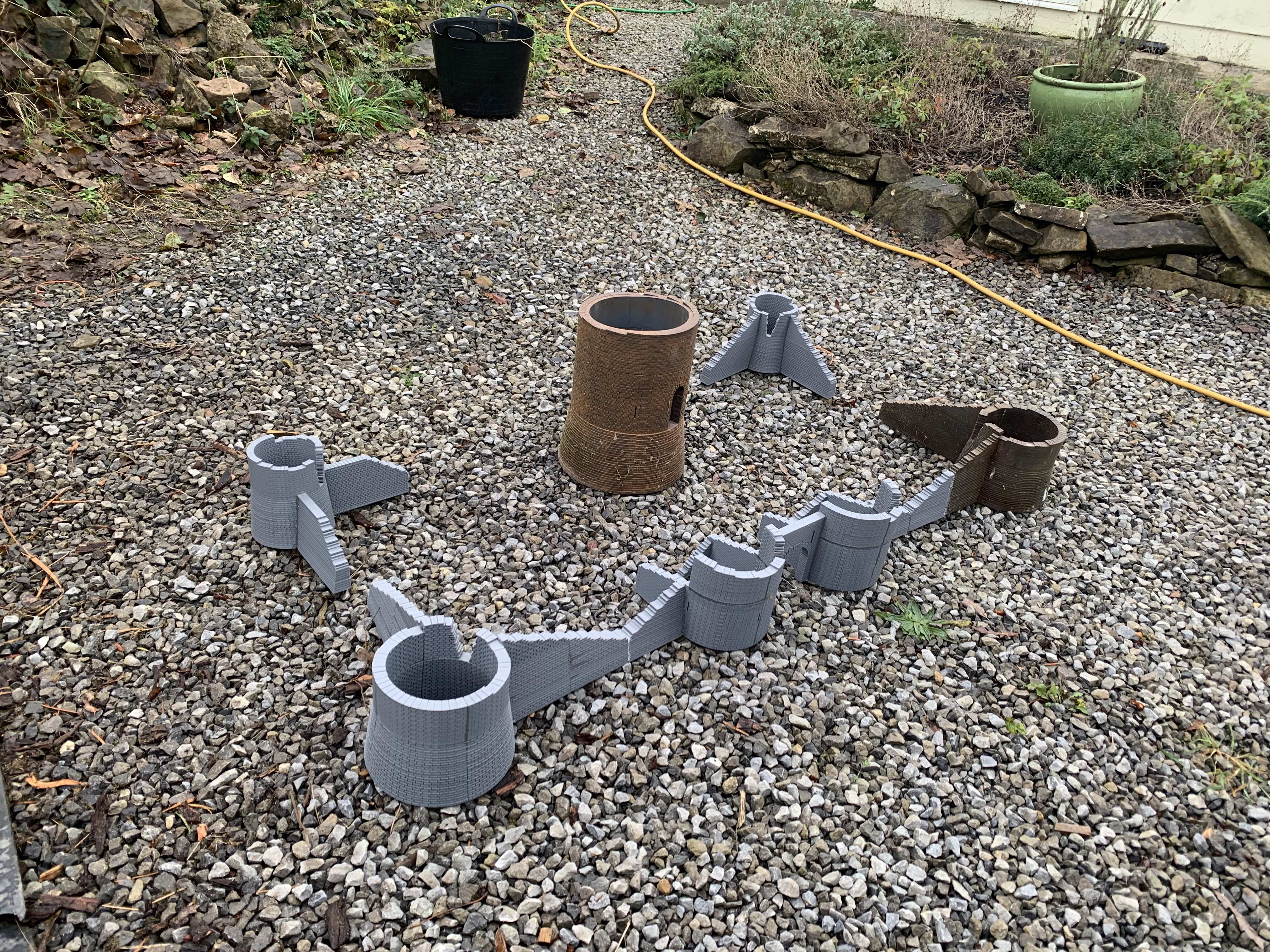

I haven't forgotten about the castle I was building so long ago. While it hasn't been mentioned for ages I have been printing bits - it just seemed to go on for ever.
It is now complete, and just needs painting before it is placed at the centre of the viaduct and planted up:
and to remind you of where it goes:
Dinah and I are planning to change the shape of the mound, clear the grass and plant it up. A job for this winter. We will see if we have the imagination to pull it off!

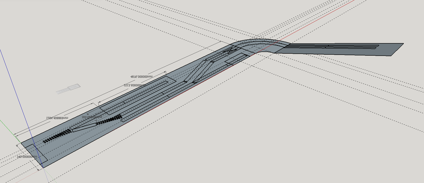

The upper terminus. Thanks to a suggestion from David John, and a copy of an article about a 7mm scale model, I have changed my plans for the terminus. Originally I wanted to model the terminus (of the Festiniog Railway of course) at Duffws. I couldn't actually work out how to make a passable approximation to the layout. It would just not fit. So the suggestion was to model the other terminus Dinas, which went out of use somewhere around 1880. That does fit much more easily - not an accurate model you understand - but a passable impression of it.
This is a rough track plan:
You can see the track emerging under a road bridge on the left, and a point leading one way into the engine shed, and the other way into a double road which is the station passing place. In the middle is a double slip leading to an inclined plane. I have added a 90 degree bend which takes the track behind the greenhouse. The inclined plane may not get built like that - two sidings would be more useful operationally, but an inclined plane could still rise behind the sidings.
and the terminal station (as far as I have got):
There is nothing left of the buildings now - they are buried under a heap of slate waste. There are a couple of old photos, which feature on pages 80 and 81 of the Spooner Album. So the exact size and layout of these buildings is dependant on my interpretation of the photos! So I can't get it wrong. The area which I am working on at the moment is to the left of the screenshot. It was originally a stable (presumably the main stable at the top end of the line because of its size). It was converted into an engine shed and dormitory for the train, and the crews working the upper end of the line during the week. That section is 1metre long on its own.
The the station building, with a veranda reminiscent of that at Tan-y-Grisau, is in the middle. Finally on the right is a house, presumably of the station master.
You can see where the building will fit in the centre of the track plan, with the two roads curving round it.
I hope to get back to digging out behind the greenhouse next week.

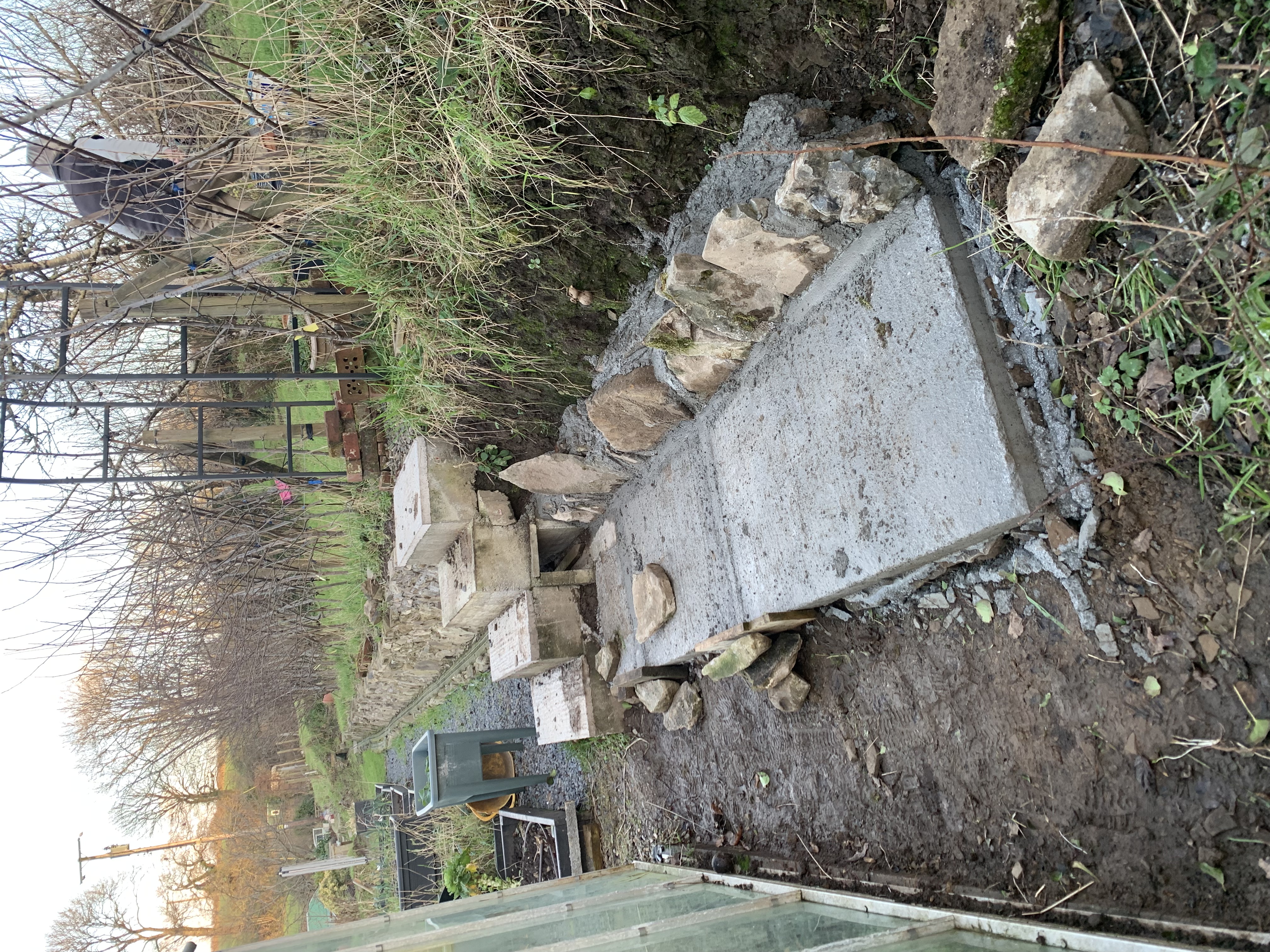

Further progress on the extension. The first 8 foot of the trackbed for the top terminus is laid, and I have started to create the retaining wall behind it:
So the wall will get finished early (hopefully) in the new year.

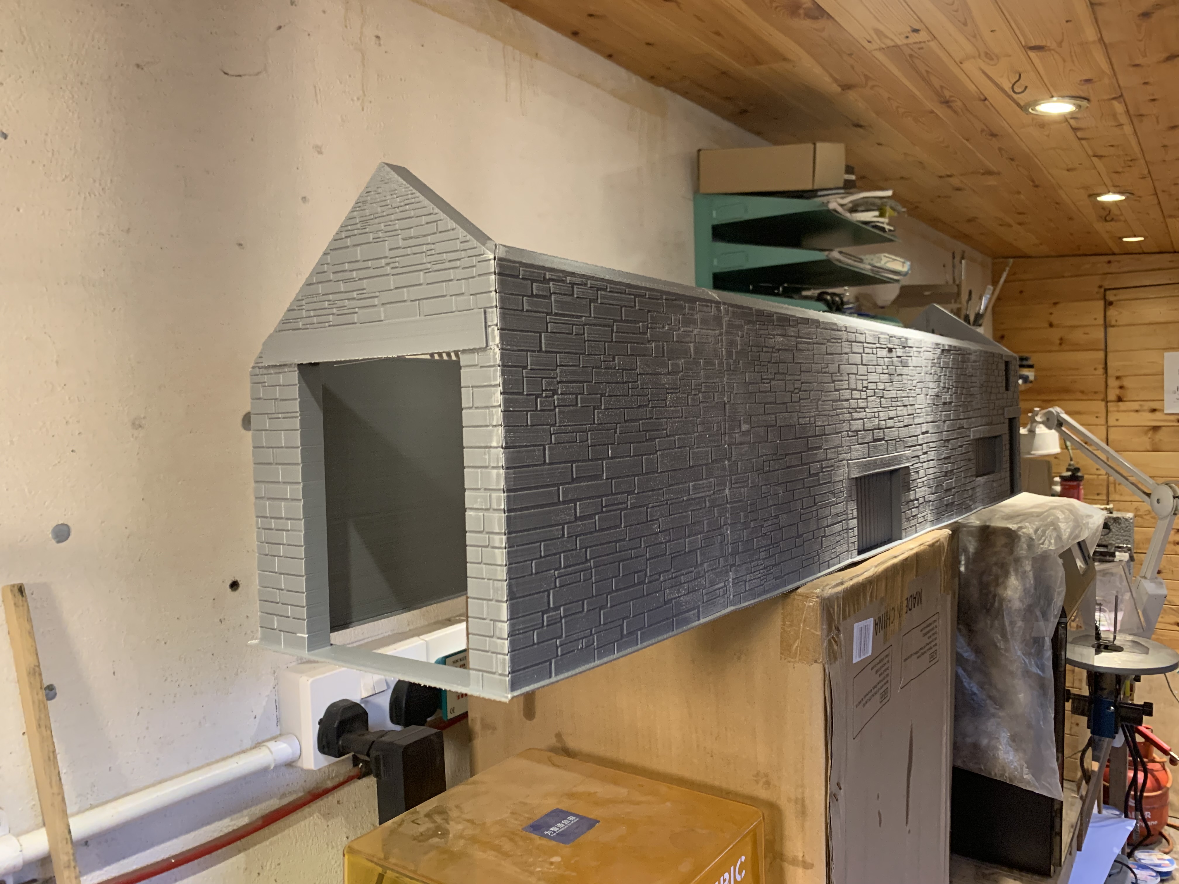

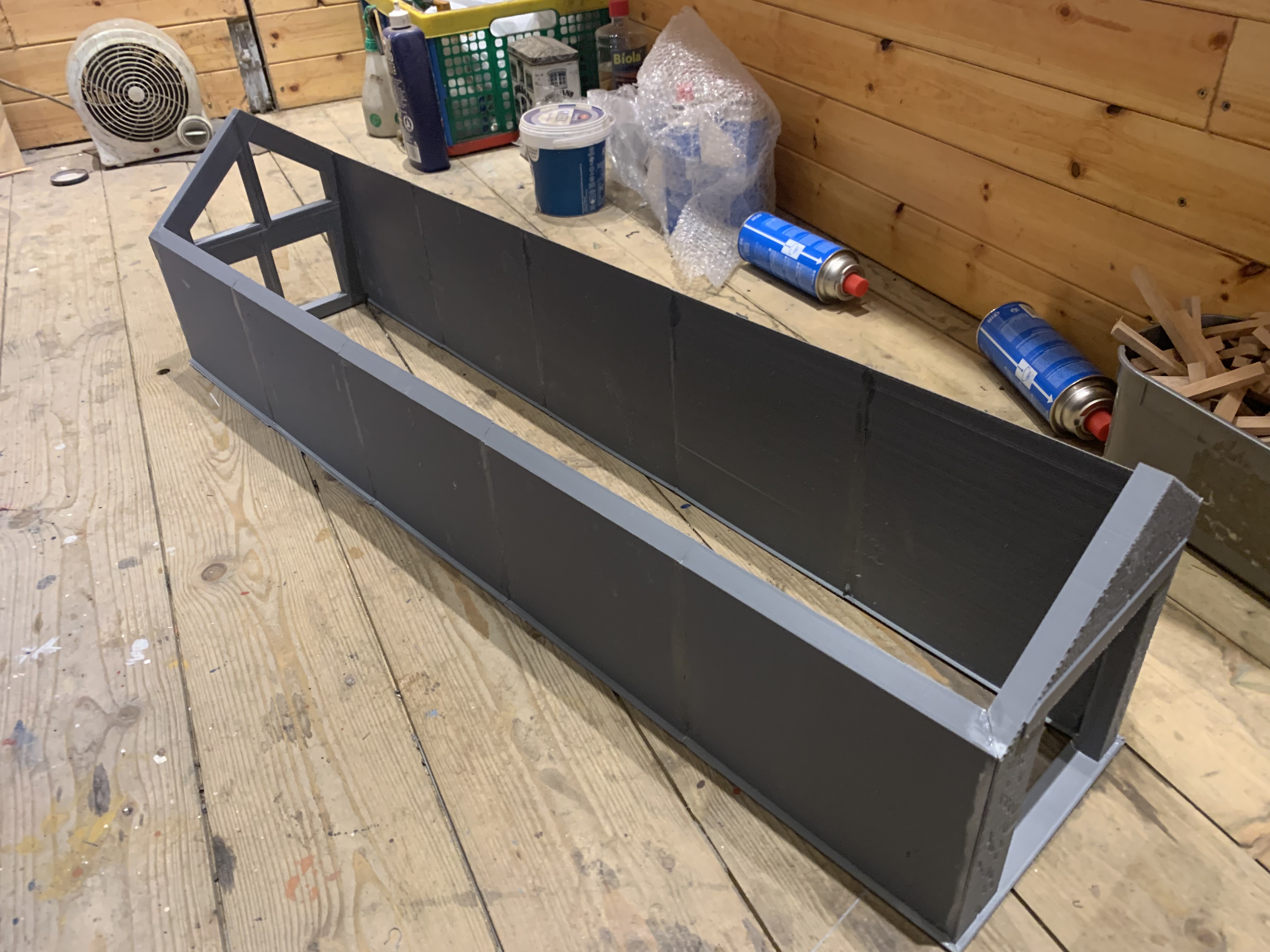

- Posts: 1212
- Location: South West Wales

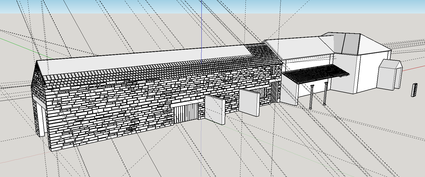

I have started to print the station building. If you look back at the screen shot of the sketchup plan you will see that it was the stable(engine shed) end which I had detailed first. Here is that end of the building printed. Well at least the 4 sides printed and assembled:
My new printer makes it much easier to make these large buildings - this section is 1metre long, and the long sides were printed upright on the bed in 5 sections. The end with the door in was printed in two parts, joining along the bottom of the lintel. The rear wall was just too big - and it had to be printed in 4 parts. All 5 sections of the long walls could have been printed in one go - but if anything went wrong with the printing that would have been almost a kg of filament waisted. Much less risky to take one section at a time.
This is all printed in ABS, and there is 2kg of filament in this so far. Bear in mind that the ABS is by far the cheapest filament. There is minor distortion in each section, of the long walls - you can probably detect the slight scalloping along the bottom edge, but it is minor. Not all of the stones aligned perfectly - but you won't notice that when the building is cleaned up and painted. For the first time I have actually gone to the effort of putting a 45 degree chamfer on the corners. They have fitted together pretty perfectly - especially when you consider how big the building is and how any distortion could amplify the errors.
The rear of the building will fit against the retaining wall so it isn't getting any detail added.
The roof is next.
