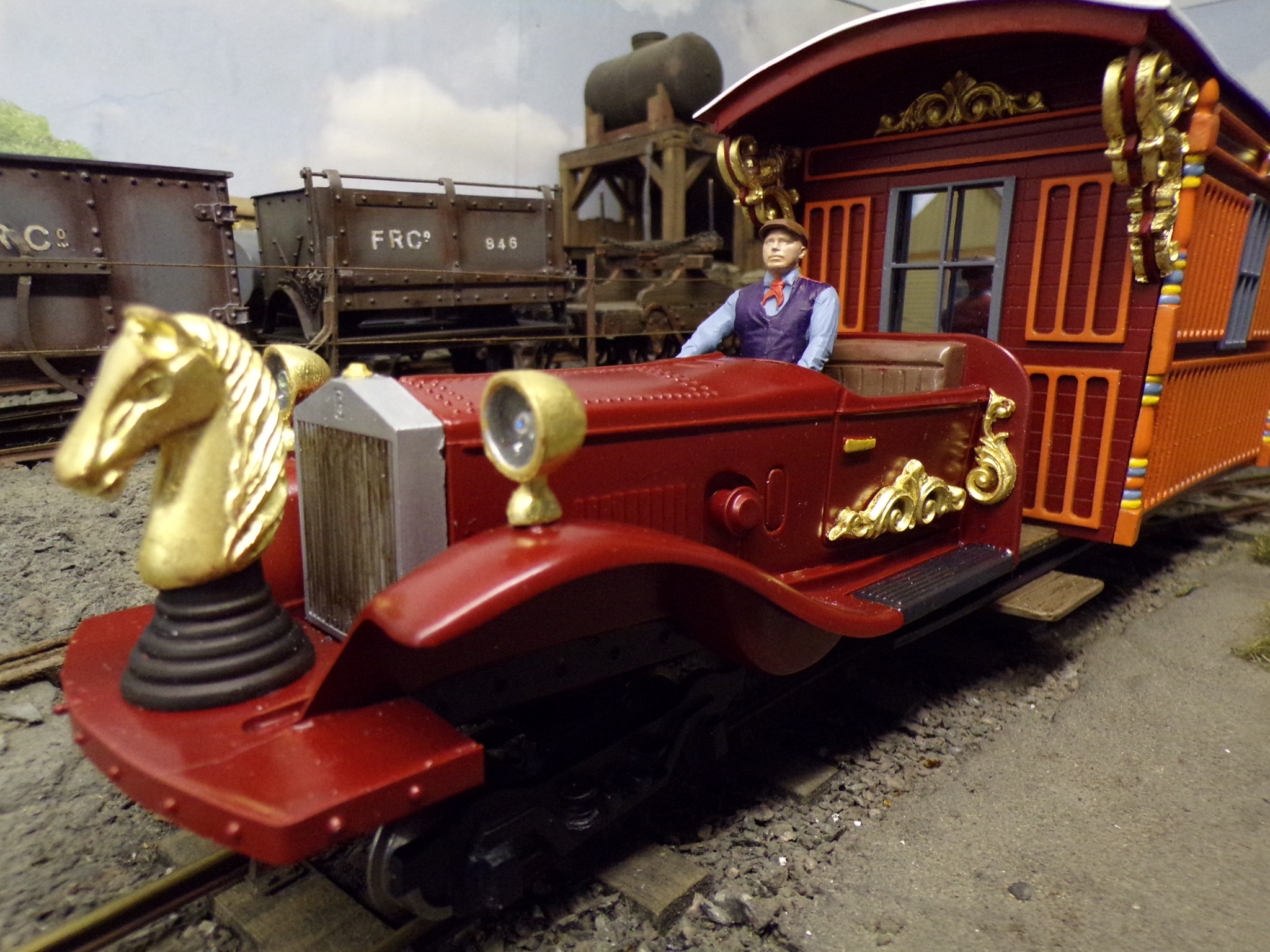

Posted: Fri Feb 27, 2026 3:02 pm

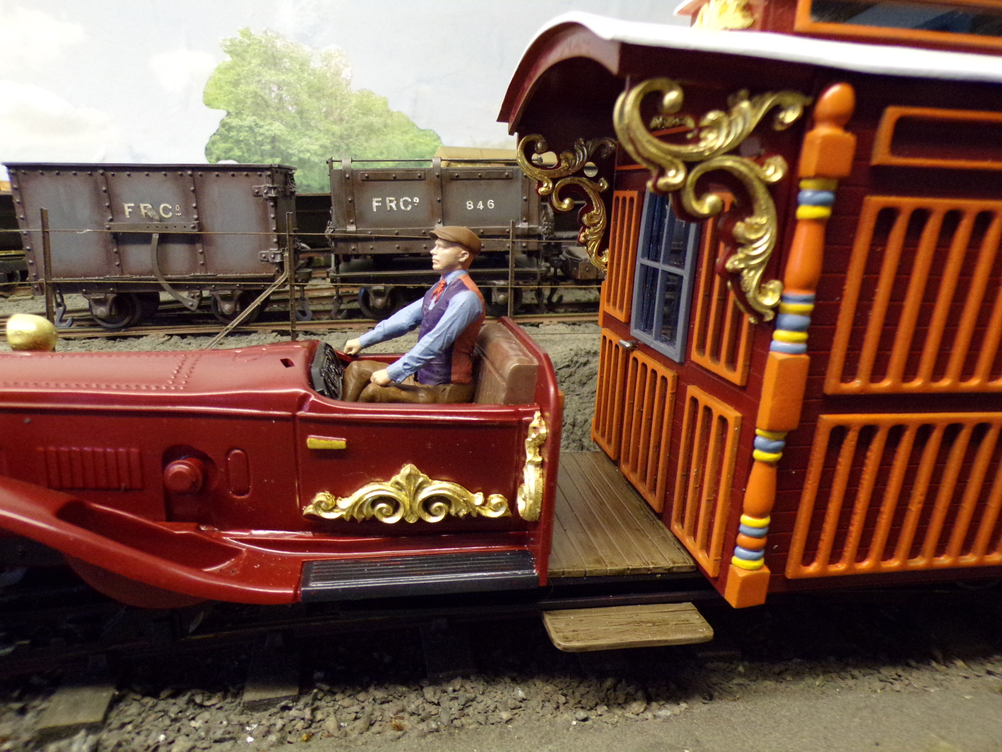

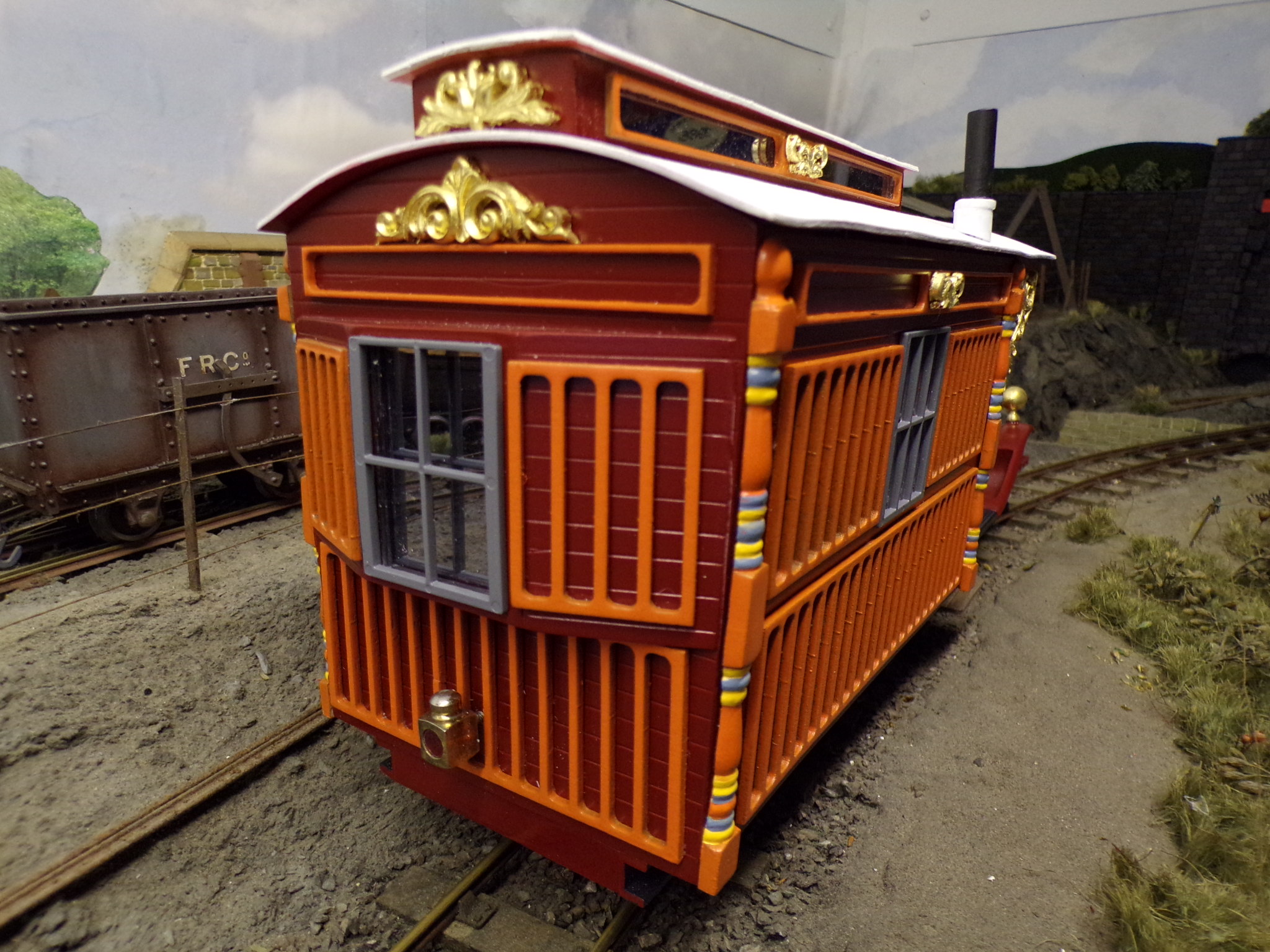

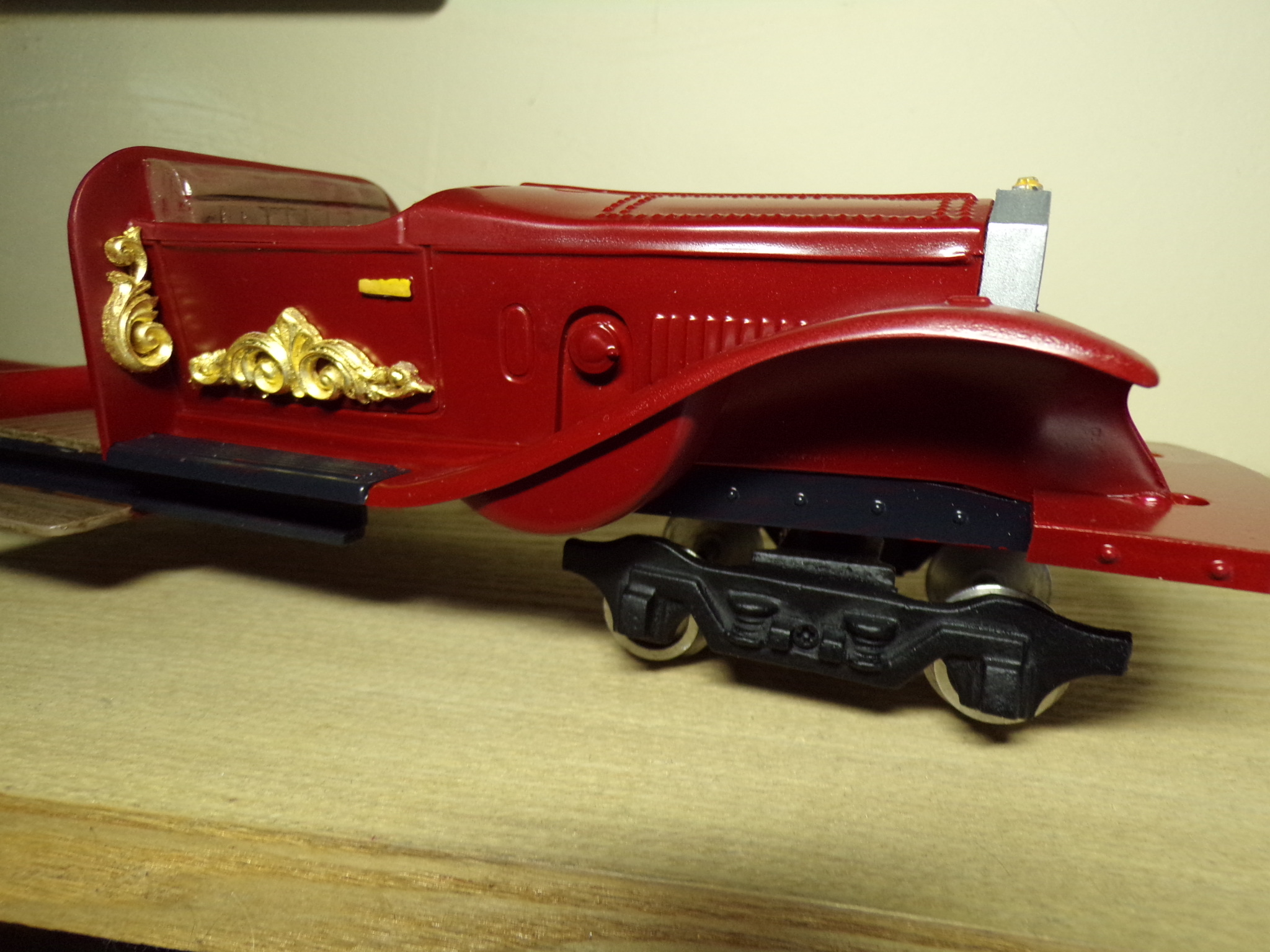

The two parts are now permanently attached complete with driver figure. Further gilded ornamentation has been applied to the horizontal strips above the windows and on the clerestory sides.
As the traditional van would originally have been horse drawn I thought a suitable mascot would be in order... easier said than done!
With all of the horse toys available during the past 50 years or so, surely something so simple would be easy to find... not so! Too large, too small, wrong pose, anything but. By accident (often the best way) I discovered for sale a choice of single chess pieces.... Good knight.... result!
Once spray painted red primer and gold leaf coated, it looks perfect....

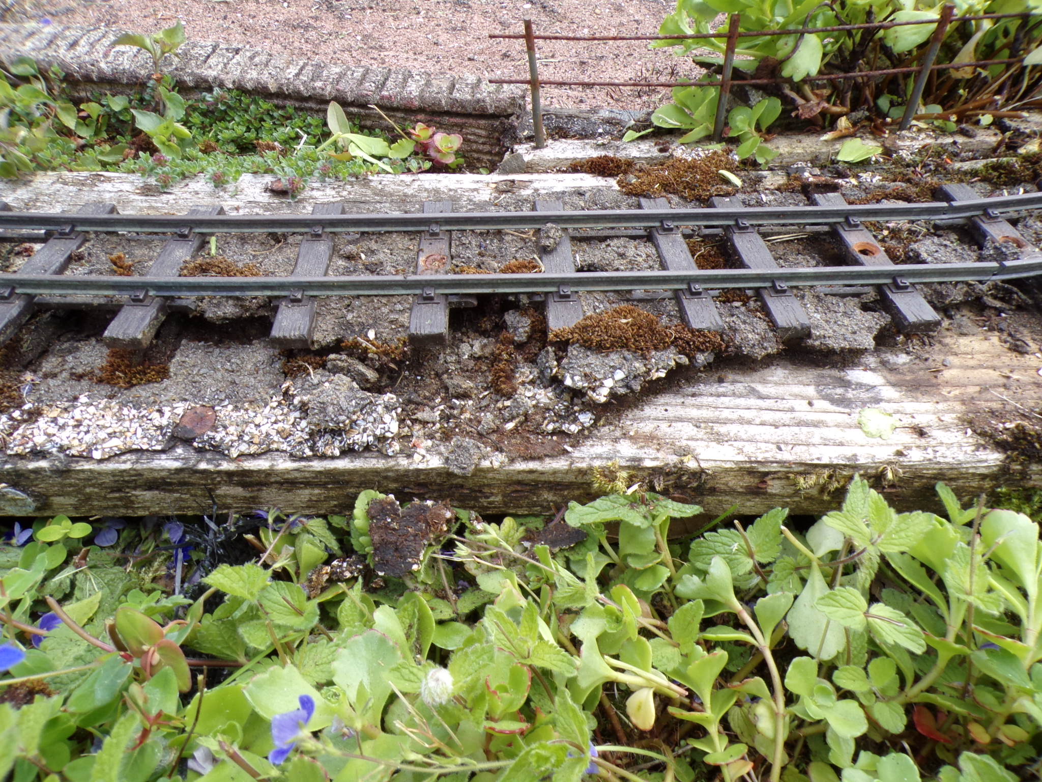

At last the sun is shining and I have been able to begin to tidy up, only to discover more wear and tear has occurred to my track-bed. All of my track is laid on treated timber boards supported above the ground. the boards themselves are still in great condition considering their age, however, the roofing felt I used has perished (because I used the wrong type!). The exposed boards are now showing in places and where I have previously replaced ballast using SBR it has become loose again due to expansion and contraction of the timber. The only way to cure that is to lift the track and replace the felt with better quality material....
After cleaning the track it is now re-laid and tested and proved to be ready for new ballast.

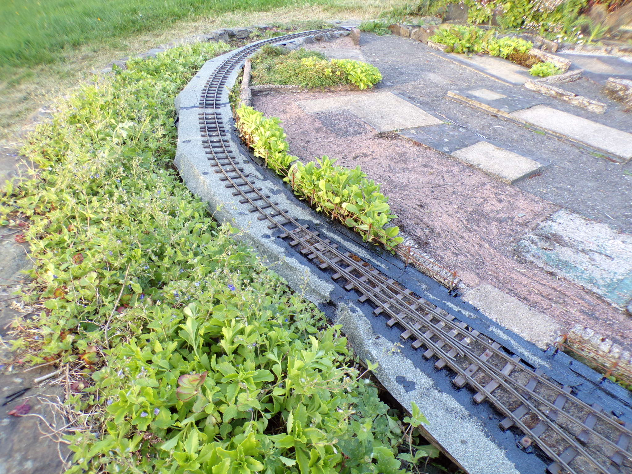

Most of yesterday I was again on hands and knees (for the third time) weeding along the track. The surrounding foliage will follow in due course as that is completely out of control...
The rails are now ready to be given a thorough clearance by my trusty companion, Henry. He can reach all those places I can't!
Next will be to ensure all points are in good working order and lubricated followed by a good running test to discover any movement in rail joins etc.
The same problem as previously mentioned with the missing roofing felt will need much attention to first coat exposed timber with bitumen, then
re-ballasting where necessary, which means most of it!!!

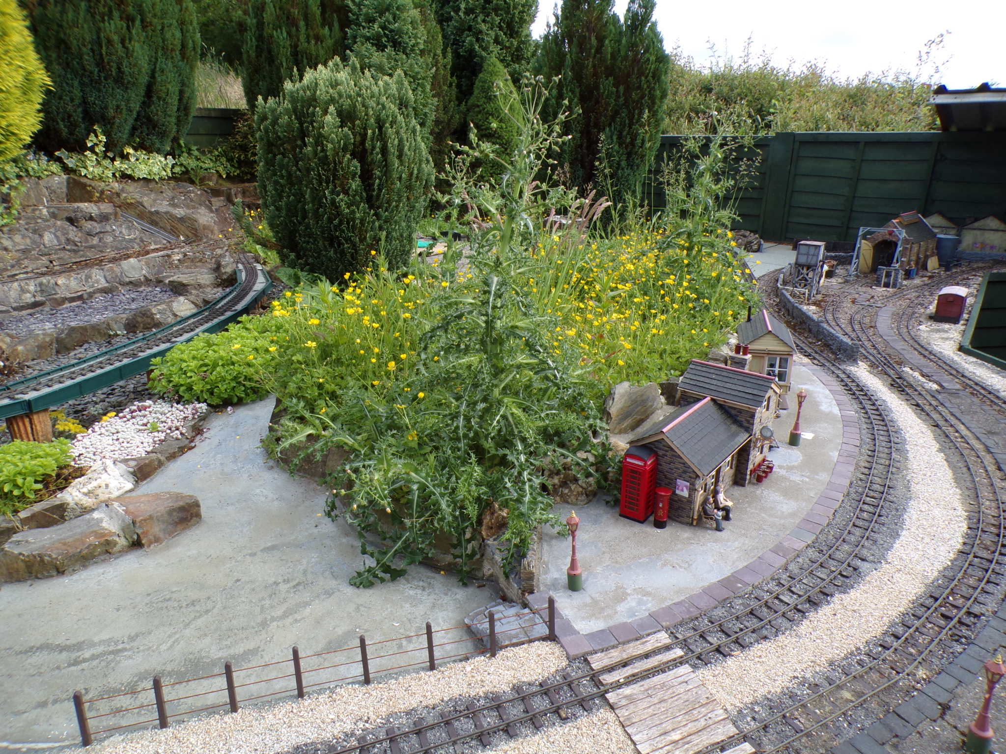

Posted: Sat Jun 06, 2026 8:02 pm
Hard to believe here in UK we are already in June 2026, so called 'Flaming June' for its traditional warm holiday weather, but certainly not in Wales!

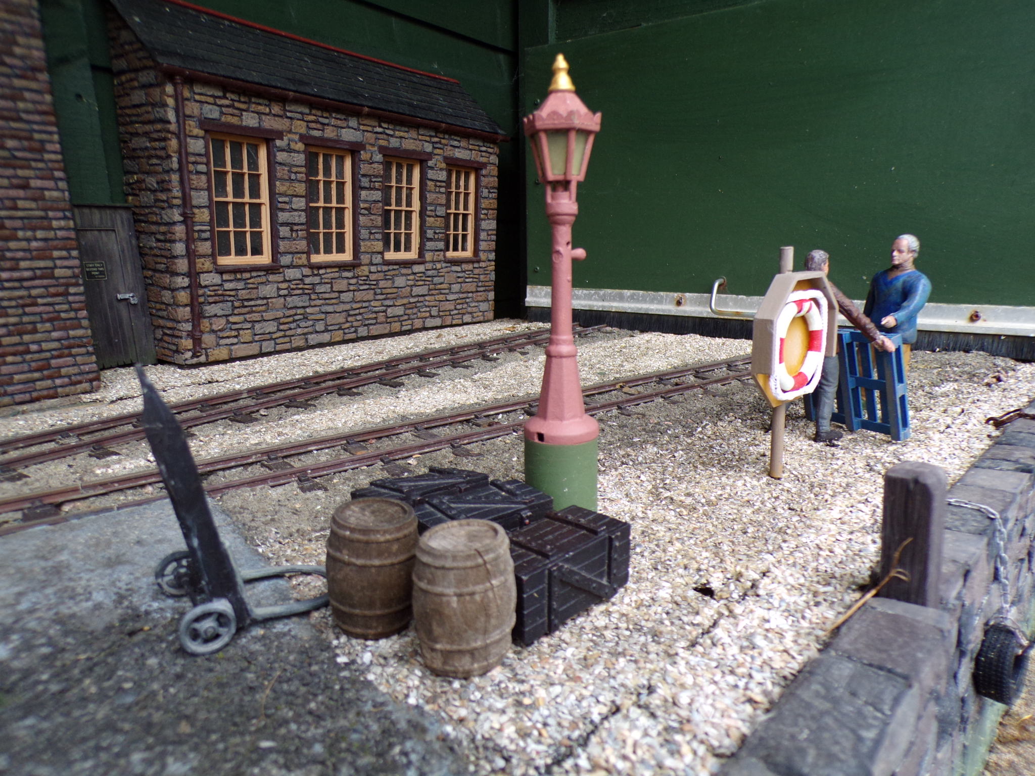

I am struggling to find opportunity to complete my railway clean-up in preparation for my annual open day for friends in the 16mm Association Local Area Group. As I go around the track I have managed to replace a few structures, just to give myself a little confidence that at least something is progressing. This is my harbour scene...
Today I received an email from one of our group members with a gentle reminder that we are not yet past the worst weather conditions which might hinder me further...
B.U.R.P.S.harbour bright.jpg (398.91 KiB) Viewed 6104 times
If you look closely at the image, the warehouse, lamp-post, harbour wall, barrels and crates are in position but the weather conditions have been slightly manipulated! All clever stuff and an image I will frame to display in my train shed for my visitors to view. I have no idea how long it would take to produce such an image but I'm grateful that someone would make the effort to do so.
