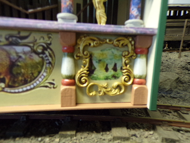

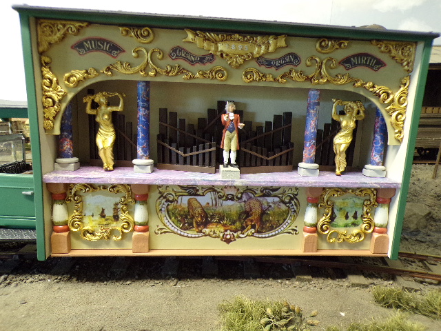

This idea is something I have been thinking about for a while but had problems sourcing particular components, particularly figures and decorative items.
I have visited so many vintage fairs over the years and always been impressed with such items on display and the way they have been adapted to road transportation, so why not rail?
More details on construction to follow... should you be interested.

Excellent Peter.
I was going to say it could have been a showmans pipe organ ,but the green paint job threw me off . Lovely detail ,quirky as ever.

Please do. Are the cab stanchions drill bits and the columns pen bodies? They look familiar.

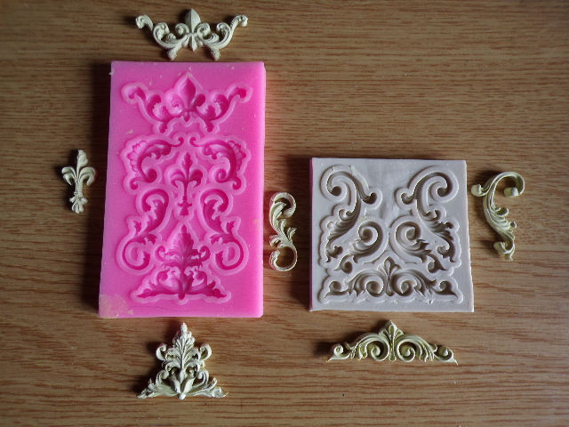

It has been a most interesting project as most of the components are not garden railway related, neither do they conform to scale.
Before I could start I needed to find suitable figures, e.g. Conductor and Caryatids. No 3D prints available, no fantasy figures suitable for conversion, but I managed to find Doug at... https://www.fairgroundmodels.co.uk. He supplies model fairground rides etc. in various scales so I managed to buy whitemetal figures from him. They are perfect in scale and detail and look superb after a little special finishing...
Next was to search through Google images of fairground organs to form a general idea of what to make and how to fit everything together. Organ pipes are a must so I raided my selection of square plastic pipes and built up racks of various lengths and sizes to give the impression of different notes and pitch. (No... they don't work!). One image of an organ front was downloaded and printed to give the background ornamental painted panels, which I cut and arranged in suitable locations with the original 3D work painted out....
The scrolls were another problem to overcome... I'm pretty handy with a scalpel, but Grinling Gibbons I aint! Another search through good old eBay showed up an amazing selection of the perfect solution, and not what I would ever have thought about....
These are silicone, flexible sugarcraft moulds for cake decoration. There are dozens of patterns available and can be used to cast wonderfully delicate shapes with crisp detail using Miliput. They set overnight and, following a base coat of red primer, have also been gilded with genuine gold leaf (from my picture framing days).
Chris asked about the stanchions .... 2mm square brass rod carefully twisted with a vice and grips. Columns... wooden dowel with a printed marble effect paper wrapper.
When I could tidy my workbench on completion of the cosmetic side of construction I counted the number of paint colours used on the model. If the spray colours are included (grey, red and black) they total 22 colours.
