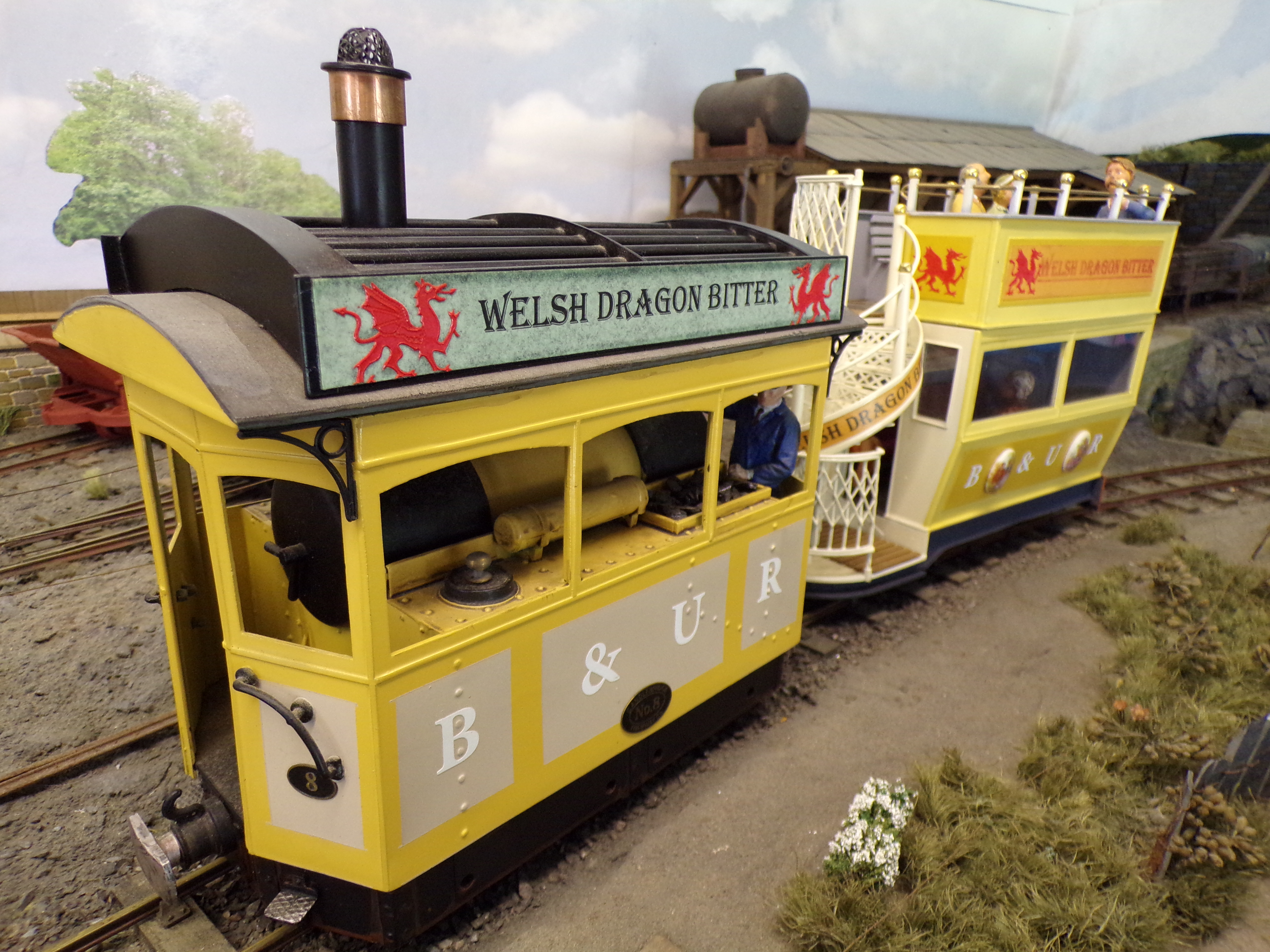

Steam Tram and Coach...
A six wheeled, Santa Fe, '0' gauge diesel shunter was donated to me and it was perfect chassis to construct the steam tram body on as none of the underside is now visible. The tram is again Plastikard with RC Trains receiver and a battery pack in the boiler. Made in 2017.
The reason for building the tram was because I already had the double deck passenger tram from my early exhibition days. Again, a Plastikard construction running on four, unpowered wheels. The winding stairway is of white-metal units made by a jeweller friend for another purpose, but too good to miss. Probably made in about 1980's?
