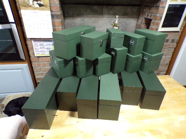

Post by Peter Butler » Fri Jan 19, 2024 4:28 pm
That's what a kitchen table is for..... right?
I have been working away making lots of new stock items but given no thought to their secure storage, until I found myself short of space!
A determined effort to create boxes to allow them to be stacked and keep them safe from damage had to be undertaken, and it was quite a surprise to discover how far behind I had become. The boxes are cut, assembled and painted in the outside workshop, but the felt lining and hinges etc. are more suited to the kitchen table.
A classic case of domestic harmony.... when Diane's out of the house!
Post by FWLR » Sat Jan 20, 2024 6:17 am
Thats something I need to be thinking about for my rolling stock Peter also. Soon gets forgotten about when you have so many things to build....
