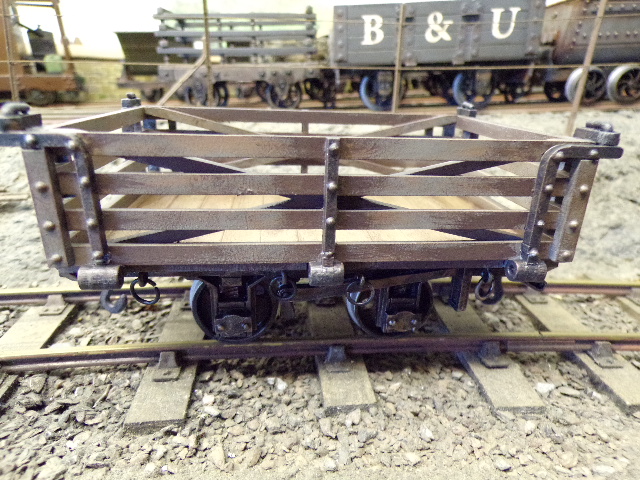

Cheers Bertie. The crane loco is the first 16mm scale model I made about 40+ years ago, it is scratch-built from Plastikard, my material of choice ever since!

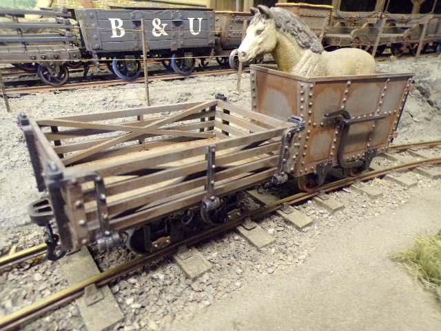

A little more recently, (just days ago), I finished another laser cut, MDF kit of a War Dept. 'P' Class Wagon. This is from Invicta Model Works, the same supplier as my Dandy Wagon. I notice Rob has now become a member of the Forum and can be contacted by PM or email at...invictamodelworks@outlook.com
I have no connection with this company other than being a satisfied customer.
The kits are basic and offer opportunity to add detail as required, I have added metal wheels to replace the Binnie ones supplied, hook couplings from Jerry Irwin, and rivet heads to represent coach bolts....
The kit could be built as supplied and make a very nice wagon for the bargain price of Β£12.25 (plus post).

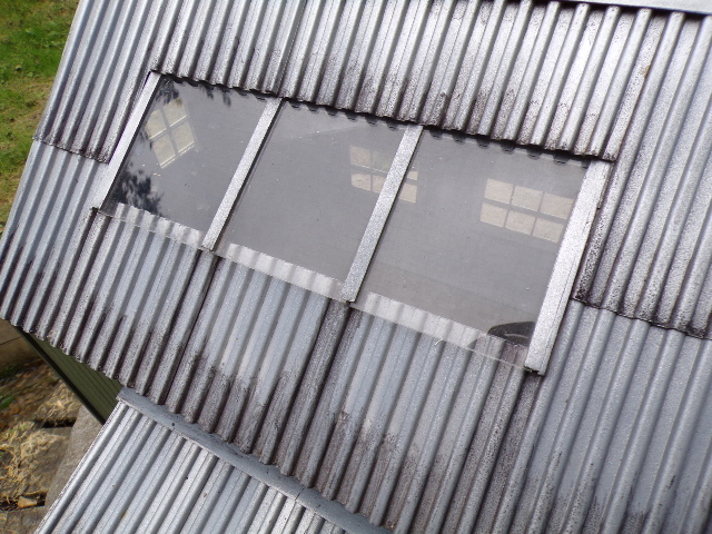

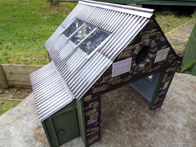

It is time to end the running season for B.U.R.P.S. for another year and so the structures are now undergoing their annual inspection, wash and brush-up, ready for 2024. Most have survived the persistent rain and occasional storms remarkably well here in West Wales. The more seriously affected ones are, again, the resin and concrete items, where the acrylic paint has peeled or faded.
Last year I started a programme of replacing clear styrene window material with acrylic, smoke-grey mirror sheet, which looks so much better. The styrene had yellowed so much as to obscure shop window displays, so rather than re-fit interior details I went for the mirror sheet instead. A friend introduced me to the idea and it is far superior in appearance and longevity. This year I intend to complete the remaining buildings to match.

Philip, my HIP structures, including attachments such as gutters, downpipes etc, have all weathered the storms extremely well, some of them dating back to 2015. I do put them indoors during winter months however.
The window glazing is another matter though. The example pictured above dates from 2017 and despite the peeling paint ( I used emulsion as an experiment) the only problem is the deterioration of the window material. I presume this is styrene, but can't be sure.
Another structure (petrol station/repair shop) from 2016, shows no discolouration of the glazing whatsoever, so I believe is a different, but unknown material...
I'm taking this opportunity to replace as many window glazing sheets I can access with acrylic mirror. In reality, unless a building is internally lit, the only thing visible from outside is the viewers reflection.

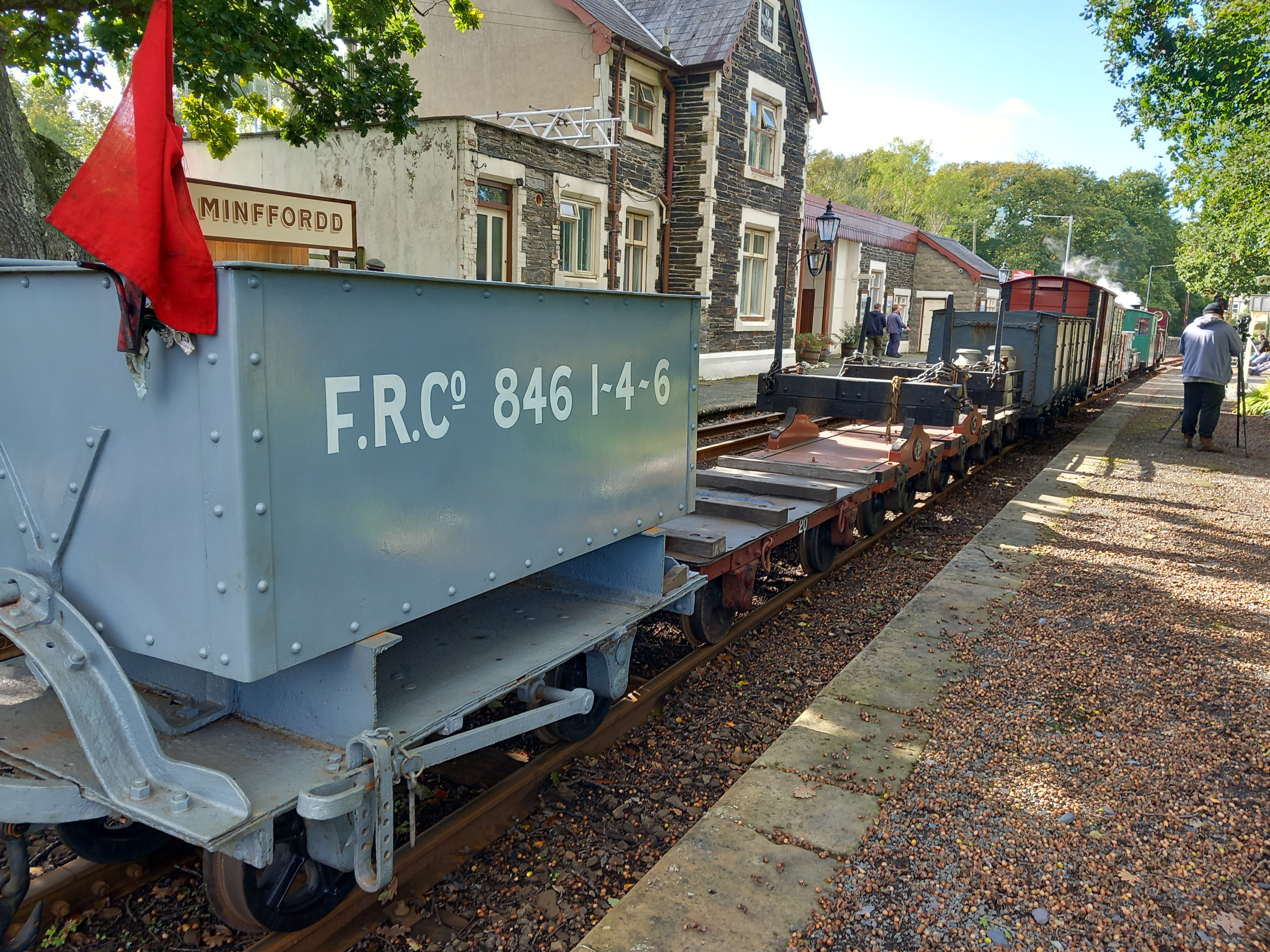

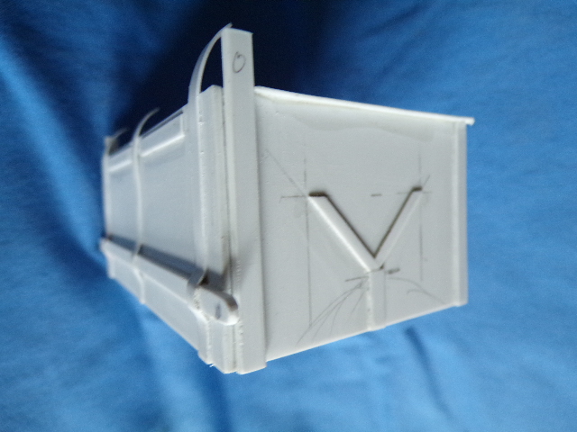

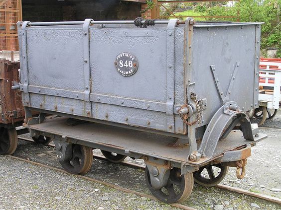

Having recently seen the new offerings from Porterhouse Models I was immediately drawn to the FR Coal Wagon with end doors, a most impressive and detailed model. I decided to get back to scratch building as I have neglected that for too long. A quick Google search turned up another FR wagon which I am unfamiliar with, a side tipping wagon.....
Ffestiniog steel wagon.jpg (64.99 KiB) Viewed 17207 times
I can't find any dimensions or other views so I have just guessed everything from this image....
Painting tomorrow.

Looks good Peter. They are a fantastic wagon and joth of the Ffestiniogs are different.
Yours looks like it's based on 846 because of the curved pivot support.

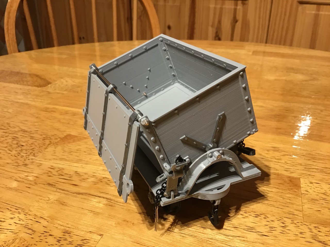

Post by Peter Butler » Sun Nov 05, 2023 11:09 am
Thank you both for your kind comments, I was certainly inspired by the Porterhouse model and heard the call to scratch-build something similar. I must have seen the thread which Philip attached but had completely forgotten, however, I can see where I need to make slight modification to my model as I had no views of the other side. Not a problem fortunately. It is simply to add the two flat support girders to the underside of the floor to prevent two-way tipping... not visible on the original image.
Without dimensions of the original I have built mine as follows... length. 7ft. width. 3ft. 9in. height. 4ft 10in. Am I anywhere near?
Posts: 6075
Post by philipy » Sun Nov 05, 2023 12:32 pm
When I drew up this wagon for Andrew, he gave me the chassis dims, which from memory he measured from another wagon, so are probably not accurate for this particular vehicle.
However the footprint of my wagon is 118 x 64mm ie 7ft4 1/2" x 4ft 0"
My body measures at 32.55mm but I don't have a figure for the O/A height I'm afraid.

Post by Porterhousemodels » Sun Nov 05, 2023 5:37 pm
Peter Butler wrote: Sun Nov 05, 2023 11:09 am Thank you both for your kind comments, I was certainly inspired by the Porterhouse model and heard the call to scratch-build something similar. I must have seen the thread which Philip attached but had completely forgotten, however, I can see where I need to make slight modification to my model as I had no views of the other side. Not a problem fortunately. It is simply to add the two flat support girders to the underside of the floor to prevent two-way tipping... not visible on the original image.
These any help Peter?
Cheers
Porterhouse Models
Suppliers of magnetic couplings and 3d printed rolling stock.
https://www.porterhousemodels.co.uk/
View our garden railway the Porter Garden Railway
https://www.youtube.com/@portergardenrailway7722
Posts: 5731
Post by Peter Butler » Sun Nov 05, 2023 5:56 pm
Very helpful, thank you. I see the wagon is braked too, something not visible on the original picture. That means another addition to the chassis. Another fine mess I've got myself into !
