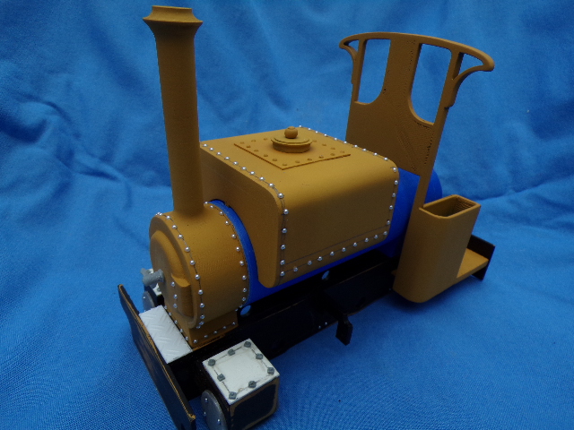

I'm progressing well with my 'Wren' with encouragement from member's advice on suitable fillers, also by watching the vast number of videos on the subject, I never thought it would have so much coverage.
My filler has not yet arrived but there are areas I can prepare by sanding, and using alternative methods to disguise certain areas which, even using filler, would be difficult to disguise.
Here I have used a Plastikard liner to cover such areas.....
Just to make life interesting, Peter's PDF construction video shows a different kit of parts, including motor and gearbox (and its location), cab roof etc....
The new motor is now situated vertically and fits into a hole in the underside of the boiler, therefore battery space, and access, is compromised. I have to think of a way to be able to separate the components (just in case!) without destroying the cab framework, which is designed to be glued in place.

Still no filler in the post, so I have made some progress with the parts I am satisfied with and attached just a few rivet heads.....
It was easier to replace a number of printed parts with Plastikard and add bolt heads, such as cylinder tops. I think I have sorted out the location of batteries and receiver too, although my battery packs are also somewhere in the post!
Google search for similar Wren locomotives has shown up a huge variation in body styles and fittings, so I have a completely free rein when deciding what accessories to add.
I'm really getting pleasure from this build now.

My Deluxe Perfect Plastic Putty arrived by courier this afternoon and I set about putting it to the test. It is a smooth paste and can be easily applied with a small blade or spatula. It dries quite quickly and is easy to sand with fine wet and dry paper. I haven't yet primed the surface but I feel confident it will give a satisfactory finish.... pictures tomorrow!
Meanwhile, the striations on the boiler and firebox were so pronounced I decided not to use the putty at all and wrap a thin Plastikard liner around the entire tube. This proved to be easier than expected and solves the problem nicely. It also makes the saddle tank fit more snugly and gives a better material surface to attach a re-designed cab front, which is part of my solution to make the boiler removeable for installing the battery pack.....
This is before the cab front modification so that will also follow later.
