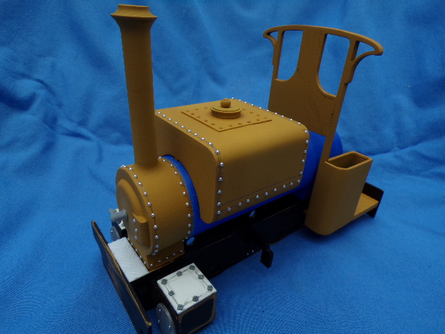

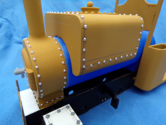

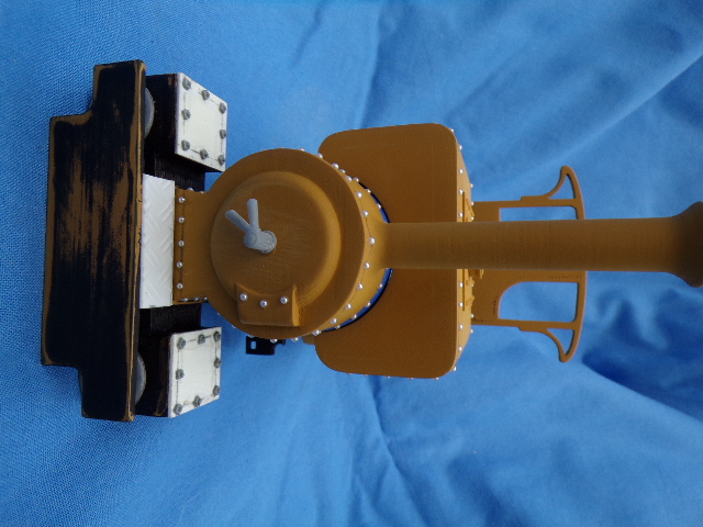

Still no filler in the post, so I have made some progress with the parts I am satisfied with and attached just a few rivet heads.....
It was easier to replace a number of printed parts with Plastikard and add bolt heads, such as cylinder tops. I think I have sorted out the location of batteries and receiver too, although my battery packs are also somewhere in the post!
Google search for similar Wren locomotives has shown up a huge variation in body styles and fittings, so I have a completely free rein when deciding what accessories to add.
I'm really getting pleasure from this build now.
