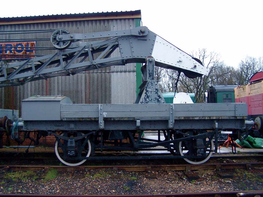

Andrew wrote: Fri Jun 09, 2023 9:48 am
The width explains why the one that Colonel Stephens bought for the Ffestiniog only seems to have been photographed at Boston Lodge - according to drawings, the newly restored Baldwin is 7' wide and only just fits between the walls and bridge parapets between there and Minffordd, so that crane would have stood no chance!
Thanks for the photograph and your comments Adrian, I think Andrew's explanation above is why the crane is shown with no straps etc. as it couldn't be operated in such limited loading gauge so there was no need to furnish it with such equipment. I have seen a design drawing showing the 'pads' which I constructed, so my guess is they were supplied new with the crane. All such items probably got lost or damaged between owners so were not on the photograph shown?
I'm not a railway historian so I had two options available to me with my model.... modify it to run and add suitable working equipment, or trap it in a siding (minus equipment) where I would be repeatedly asked, 'Why doesn't it run?'. Life is too short to cope with the latter!
Posts: 7966
Post by ge_rik » Mon Jun 12, 2023 1:14 pm
I found a larger version of that photo and you're quite right, no toolbox or general clutter
L&B Crane @Pilton.jpg (231.02 KiB) Viewed 8826 times
I searched around to see if the inclusion of tools etc on match trucks was one of those self perpetuating myths which railway modellers have created and at first struggled to find evidence for them ..... But then I tracked down these which seem to have built in tool chests. So, no a myth after all..

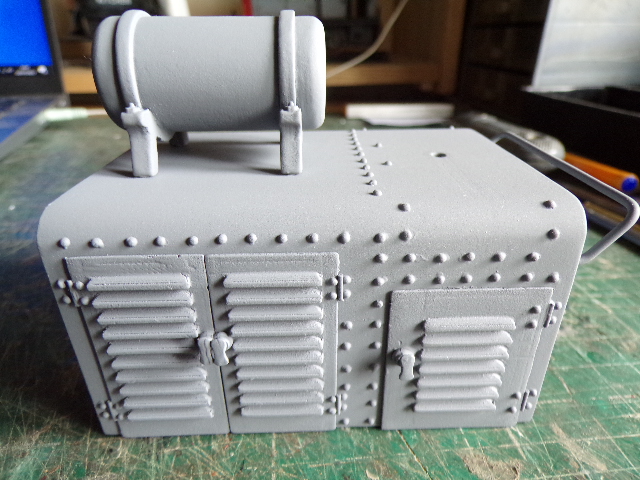

On your first point Phil, my confidence is growing with experience and I am not afraid to experiment. Previously I have used fine sandpaper to get an acceptable surface and it can take some time and effort, this time I really went for it and used 80 grit wet and dry (used dry) followed by a final rub with 600 grit (also dry).
This has worked very well and with a spray of filler primer a perfectly smooth finish is achievable.

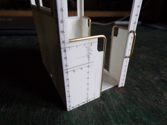

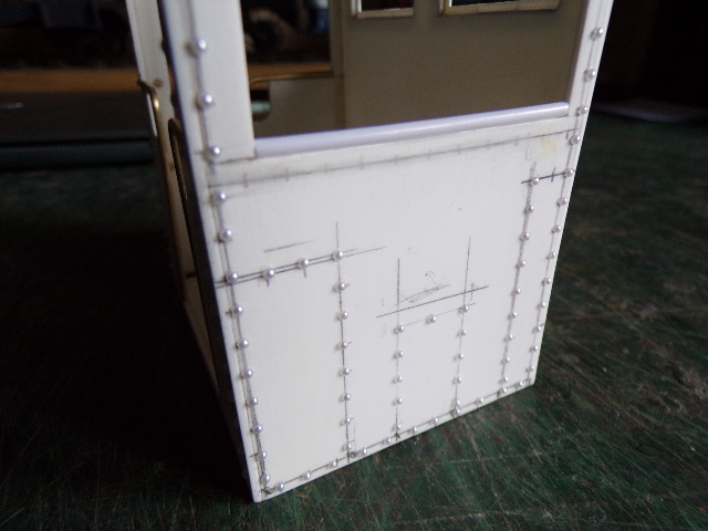

A spray coat of grey primer over the filler/primer and ready for attaching the rivet heads (supplied). These are tiny, I would estimate 1mm diam. and tend to stick together by static electricity(?). I follow the advice given by the late Peter Farley and use Evo-Stik PVA applied with a cocktail stick. A number of glue dots can be applied first followed by attaching the rivet heads, each one picked up with the cocktail stick and carefully sited, although there is still some time before the glue sets.....
Once applied, another spray coat of grey primer ensures they are encapsulated and firmly attached to the body. I have used this method previously and can assure you it works. The seemingly random positioning of the heads follows the various cab fittings, including gear lever frame, driver's seat etc. As I said before, both prototype and model examples are all different so I'm just filling in the spaces.

Well I think those spacers are really filled in Peter. This is going to be some loco when you finish it to your usual very high standard. You know how I value your experience mate and I could see myself doing the exact same way you have done. I haven't used the EVO-STICK PVA myself, I use the blue exterior wood pva, I think that's EVO-STICK. On my hols at the moment so I can't look to check it.. :lol:
I am on here without Anne knowing, she is showering :thumbleft: so I my not be able to see how your progressing until I come back.... :dontknow:
Post by FWLR » Sat Jul 01, 2023 8:09 am
Thinking about it, it may well be the same... :dontknow: Those rivets on the cab look like small pearls, are they gem art, I have hundreds of them and I use a very small sewing needle to pick them up, though even then they go flying away sometimes... :lol: :lol:

The rivet heads supplied are silver coloured and made of hard material (?) which would be difficult to stab with a needle, which is why I use the cocktail stick with a tiny amount of PVA on the point. None of them ever go missing this way.

Following the video build instructions by Peter Farley on YouTube, I have now assembled the chassis frame. This laser cut steel unit is really good as a foundation; it is well cut, perfectly flat and quite heavy. The 3D printed sections are fitted by means of concealed nuts set in the thickness of the material and the screw heads can be painted to match the frame....
The fuel tank has been attached by drilling tiny holes in each leg and corresponding holes in the bonnet. Brass rod is superglued in them to give a better bond than just face-to-face....

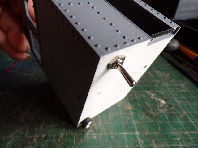

Yet another spray coat of grey primer is giving a much improved surface and I have decided to keep it grey, as many prototypes seem to have been. Before I assemble the cab details a RC system is being installed. An on/off/charge switch and a charging socket are under the cab floor with the wiring concealed behind the cab control panel... well, that's the plan!

Meanwhile... the wiring is now complete and tested....
The switch and charge socket are sited underneath the cab....
