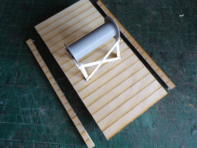

The width of the flat-bed, according to my scale rule, is 6' 8", which would negotiate my track with no problem. The trouble seems to be the screw-jacks, which are extended beyond that up to 8 feet overall, even when folded in!
So.... what to do?
Remove the jacks by drilling out the plastic hinge-pins, then reduce the width of the flat beds of both trucks .....
Cut away the blocks underneath the bed which support the jack pivots...
Re-attach the pivots set in as far as the chassis so that the jacks can now be stowed within the width of the bed...
Then fit a Plastikard angle surround to protect the timber floor and disguise the cut plank edges....
That is enough surgery for day one, now I'm going to glue on a few hundred rivet heads before bed.
