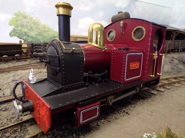

Very nice Peter. So.. it IS possible to make a silk purse from a sow's ear after all!!!
Wow Peter. What a brilliant job you have done. I love the colour and that lining is just brilliant. Now that is what good friends do for one another.
Love it, love it, love it.
- Posts: 8052
Looks really great, Peter. I'll have to experiment with lining on my cutter (another job for the list .....
- Posts: 1196
Beautiful restoration! Don't see a lot of brown locos, the colour just "works" so well on a steam engine. And the lining!

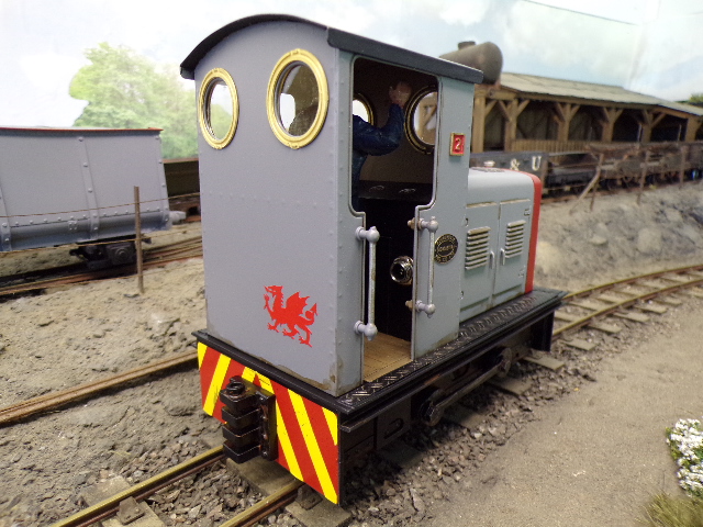

Another recent addition to the BURPS fleet was a hardly used, mint condition, Roundhouse 'Little John' in black. It came as a gift from my good friend Brian (again!) and had been with him for just a few years from new. It was supplied with R/C fitted and I have seen it working on Brian's railway, although he hardly used it unless someone was there too. Covid made such gatherings impossible so running time was minimal.
When sorting out his gifts to me we could not find the transmitter, but I seem to recall it was of the trigger and wheel type, which I dislike anyway!
This is the background to my latest loco transformation from this....
To this....
Initially I was undecided whether to move it on or modify it, as I was not an admirer of it at all. I will run through the changes I have made and can say how pleased I am now it has a new appearance.

Thats another excellent change from a drab looking engine to something that as some style there Peter. It's looks great in it's new livery.
BTW. Nice write up in the 16mmToday magazine.
That looks great! It really looks the part with that industrial backdrop, putting me in mind of childhood glimpses of grotty diesels shunting on the Silvertown Tramway in East London, glimpsed from the top of a 101 bus.
I rather like my RH "Little John", which remains largely unmodified, but it has a bit more razzmatazz than your original plain black one, being dark green with yellow cranks and rods, and wasp stripes on the buffer beams. I look forward to learning more about your mods (I particularly like the spectacle rings!) - and no, I don't like the "car wheel" RC either!

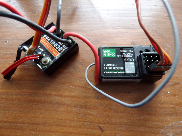

Without a transmitter I had two choices.... source a compatible one, which would possibly be of a type I detested, or change the system. No contest!
Out with the old...
... and in with a new Micron DSM2 from Phil P. Now I can operate with my RC Trains transmitter. The existing batteries are good so can remain in their holding box, which is screwed to the chassis above the running plate....

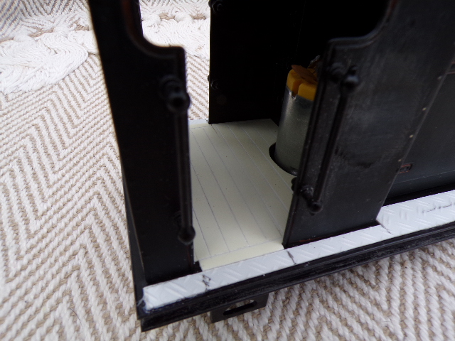

I did remove it temporarily to add a new Plastikard running plate which is slightly wider and longer in order to add a girder frame all round. I think it adds the appearance of strength to the chassis. This becomes more apparent in the final stages. The motor is powerful and the nylon gears are chunky and smooth.
On top of the running plate I attached tread plate (Slater's plastic) and a row of rivet heads and replacement springs (Cambrian Models) to the chassis sides...
Also shown above is a new plastic 'timber' cab floor.
