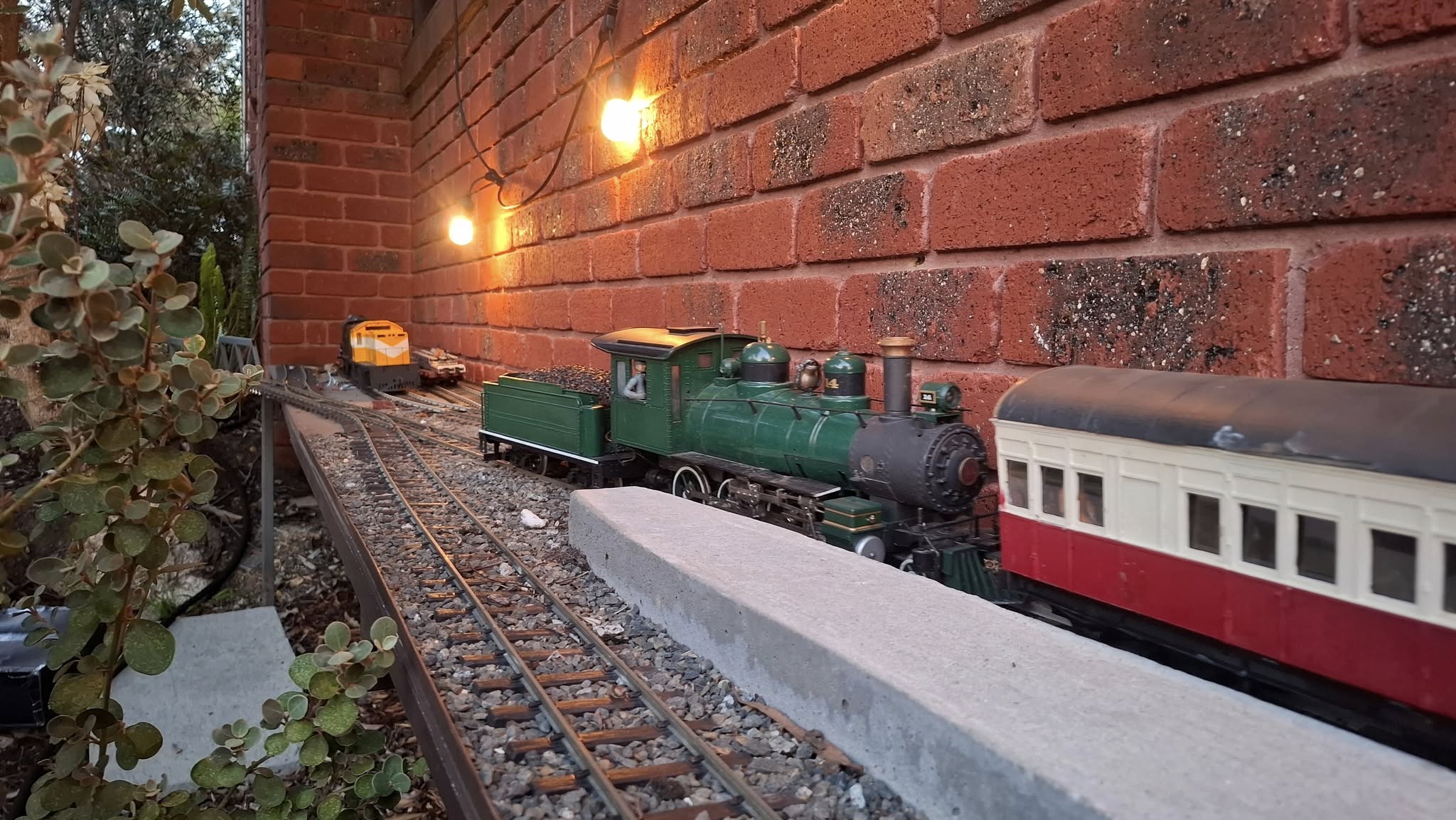

the NEVR had another rare burst of activity with the climax, 8, (porter) 9, (porter) and 14 all rostered on
14 pulls a train of Tasmanian pass stock tender
returning out of Marysville on the up

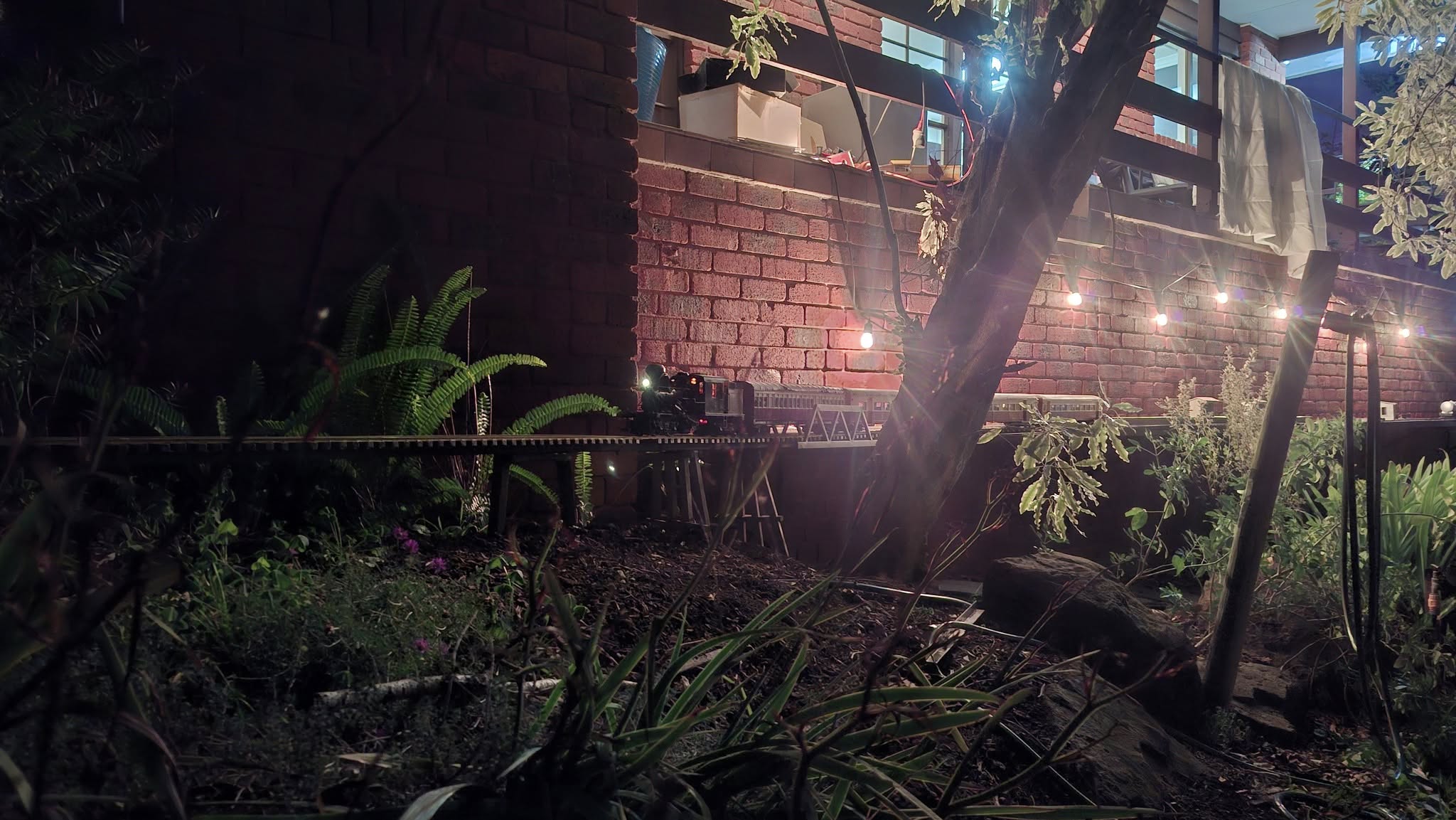

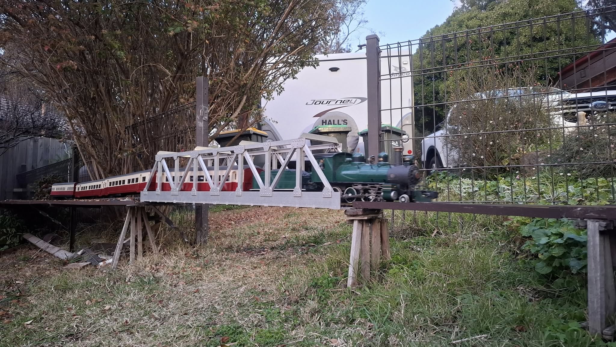

the Climax pulls out of Port Melbourne across the trestle on quite possibly the worlds slowest express...

The string lights really add to a night run. :thumbup:

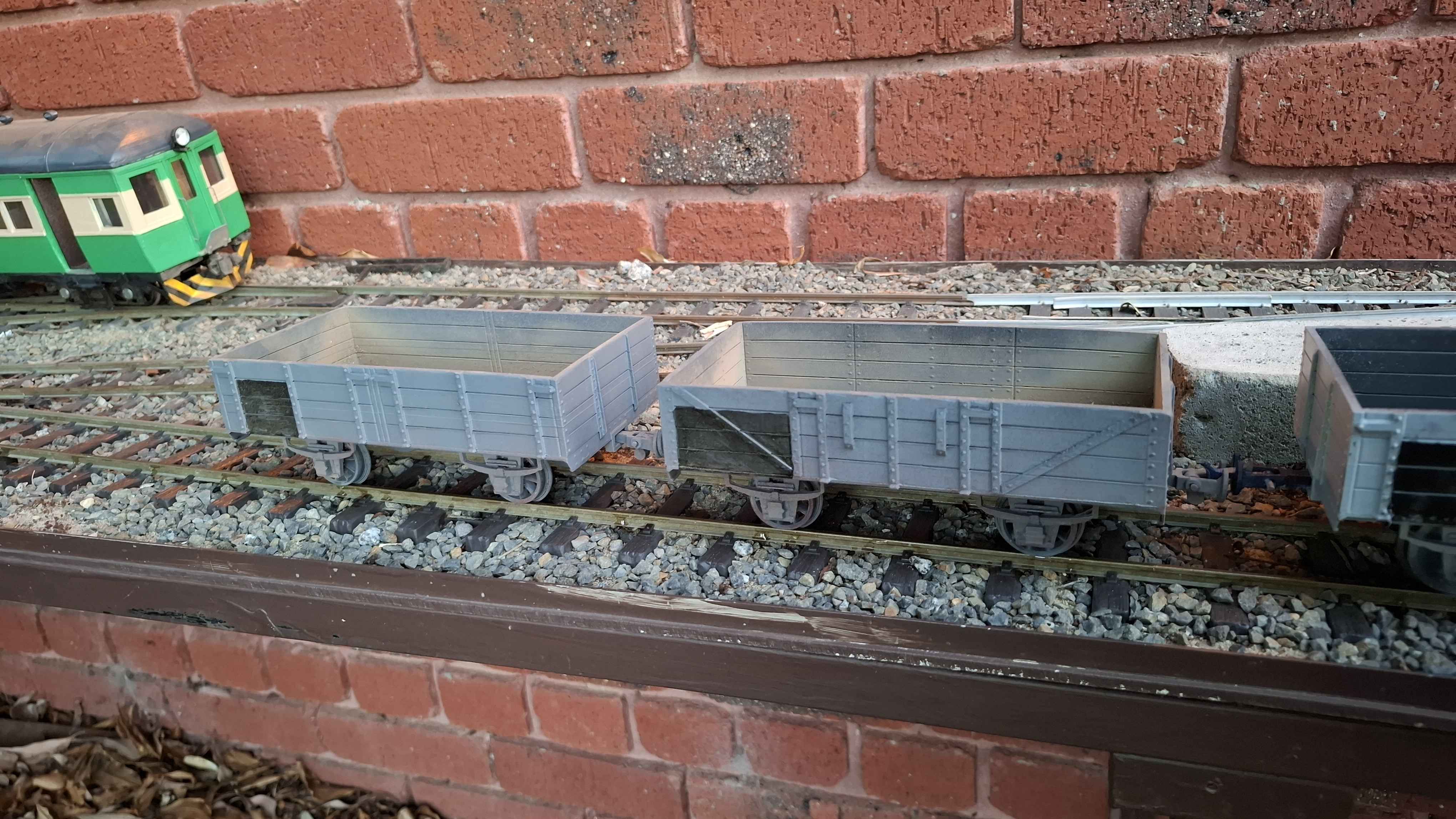

The newest addition to the NEVR/ESET roster are these SAR X and Y wagons, I'm aiming to offer these, the SAR V louvre van and bogie brake van for sale as a primer for people to model Australian prototype 3' 6" The Y truck is an older version of the file before I added interior detailing and door drop down blocks

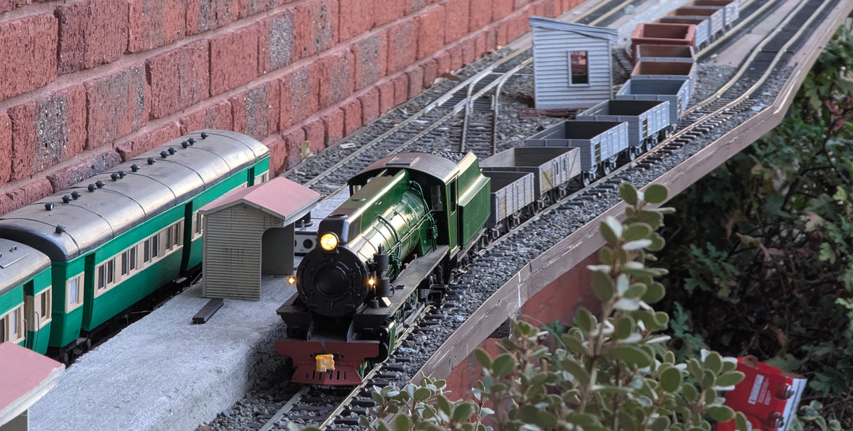

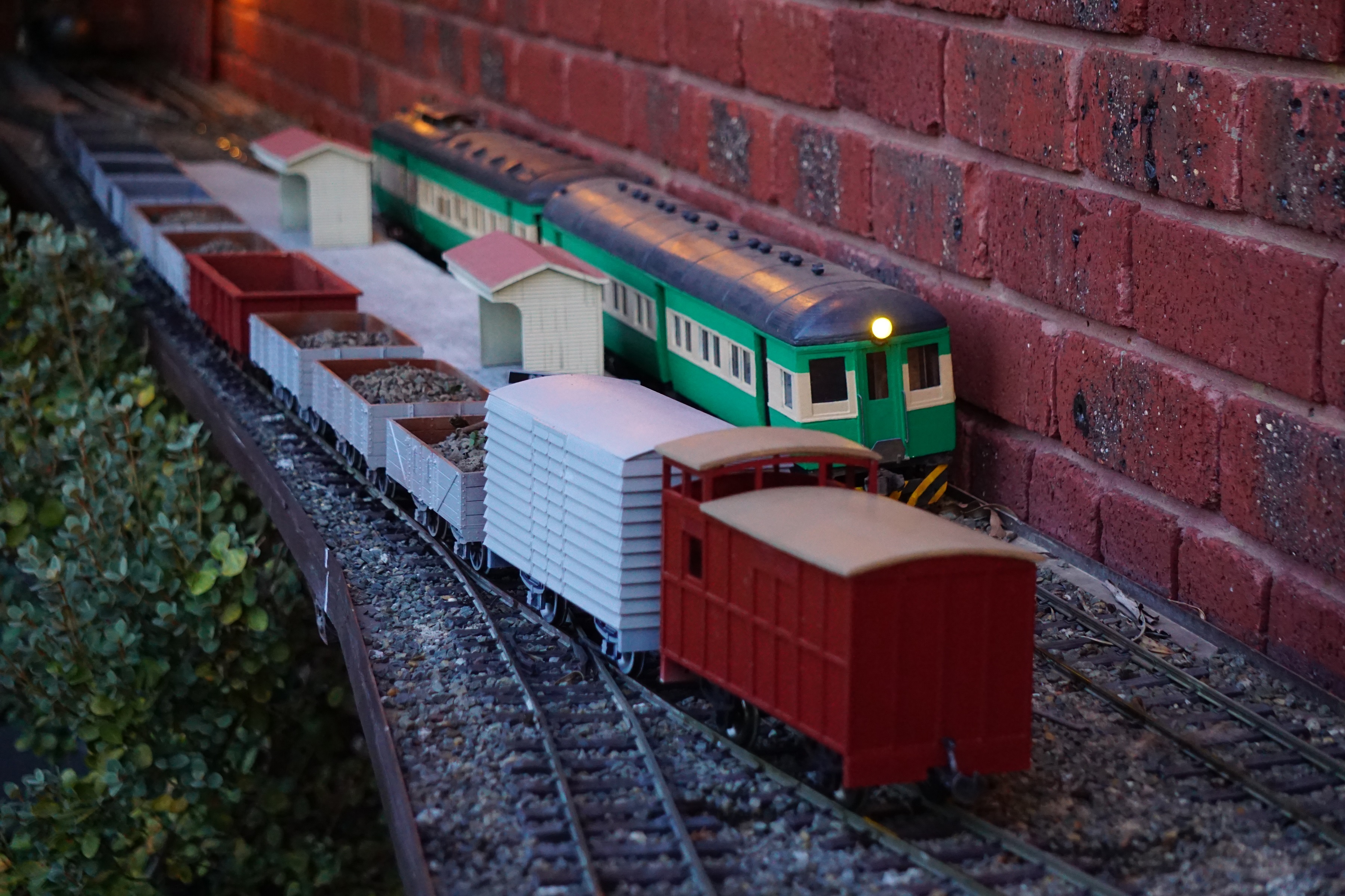

Leaving port Melbourne yard
The SP arrives in platform 2 as the train of opens heads for the mine
