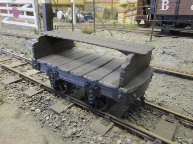

Whilst waiting for my latest kit to arrive I have been working on a number of things, only one of which is now finished, so this is following on from a suggestion by a friend to check out a website I haven't previously purchased from before. I have to admit I wasn't particularly impressed, so I won't name names. However, I did see a kit for a quarry 'man-rider' wagon which inspired this build.
I have scratch-built several quarry flat trucks in the past, so already had one to base this on ....
With the addition of a plasticard bench seat, shaped as the original, and heavily grained to represent aged timber construction....
A final surface paint finish; grey primer, Citadel 'Dryad Bark', 'Citadel 'Agrax Earthshade' wash and matt lacquer, we have....
Very nice! You've really perfected the weathered timber look...
- Posts: 8042
A rather fine looking wagon, Peter. Do the passengers sit astride the seat or back to back?
