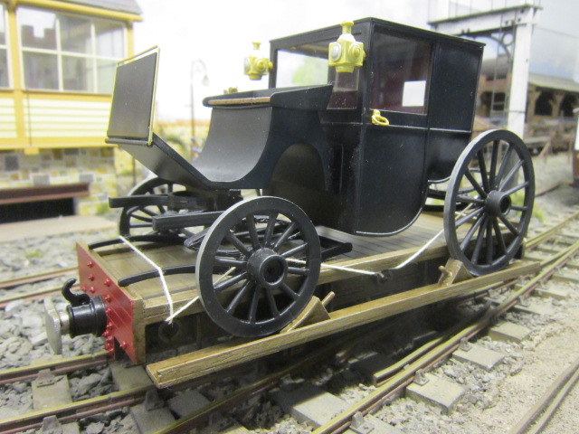

The carriage wagon is now repainted in the original colours and lightly weathered to look as though it has done some work. The Brougham is attached using the rings I fitted to the sides of the wagon, similar to the ones on Spooner's original, and ropes around the axles as we discussed previously. I have also modified the shafts, which are now one unit instead of just two separate shafts. They are now connected by a rear cross beam and diagonal bracing where they fix to the fifth wheel and front axle assembly. They might still not be correct but certainly look better....
This looks so much better than the first incarnation, which was based on a standard gauge prototype. It makes it more suitable for the limited clearance which was available on the Ffestiniog Railway, but has now shown up the difference in height when placed against the horsebox.

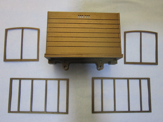

As for the horsebox, it is a Sixteen Mills, West Clare Railways horsebox kit, so is probably on the large side from the start? The dimensions are stated as being 160mm high, which when placed against some of my stock does look tall. Horses do need headroom so I accepted that at the start, but now the contrast with the Brougham carriage is too much to live with.....
The soleplate has laser-cut axle boxes as a single component so has had to be separated, cut down and re-attached using a joining piece. The springs have been salvaged and stuck back separately. Overall the height has been reduced to 145mm, which is much more pleasing.....
