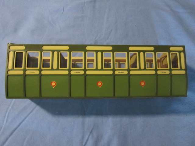

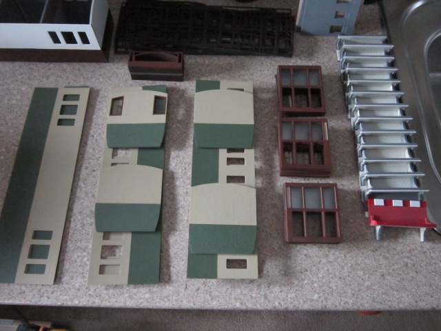

The Lineside Hut, Bowsider coaches are starting to take shape now. I have decided to batch-build so I have painted most of the parts together and begun assembly...
Amongst the job-lot I bought was a duplicate of one of the carriages I already have, so it will be painted a different colour to the other four.....

Love the cream / green colour scheme Peter!

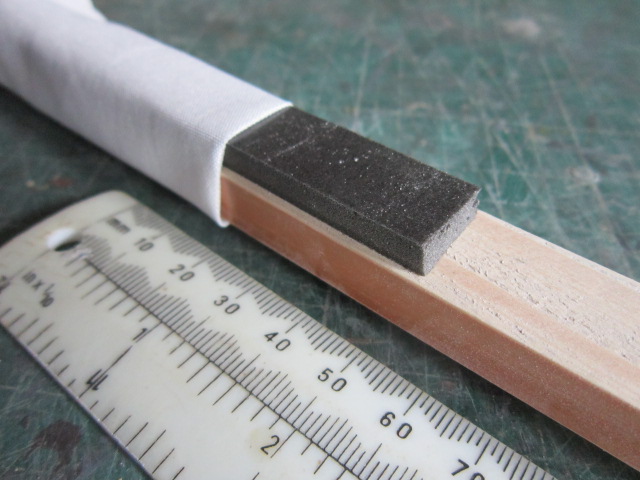

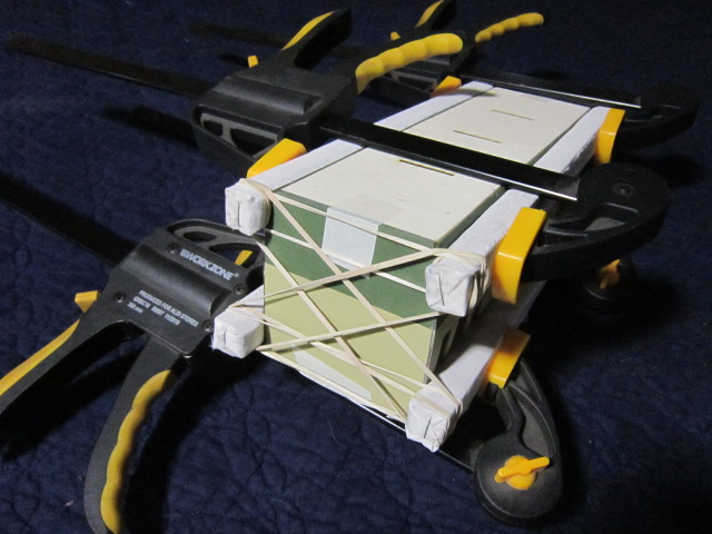

Thank you George, I am very pleased with the colour combination too, I will try to get a daylight picture tomorrow. Meanwhile, because of the long bow-sides of the coach I have devised a method of holding them firmly while the PVA adhesive sets. Each side is 300mm long so needs supporting along its full length, top and bottom. In order to do this I cut four lengths of timber, 15 x 10mm (approx), strong enough not to bend, then stuck, on one wide face, a length of self adhesive rubberised strip, followed by a wrap of curtain lining material. The rubber evenly spreads the pressure while the material protects the painted surface......
The whole thing is then glued and clamped together and left to set.....

Nifty! :thumbup:

Nice idea that Peter.

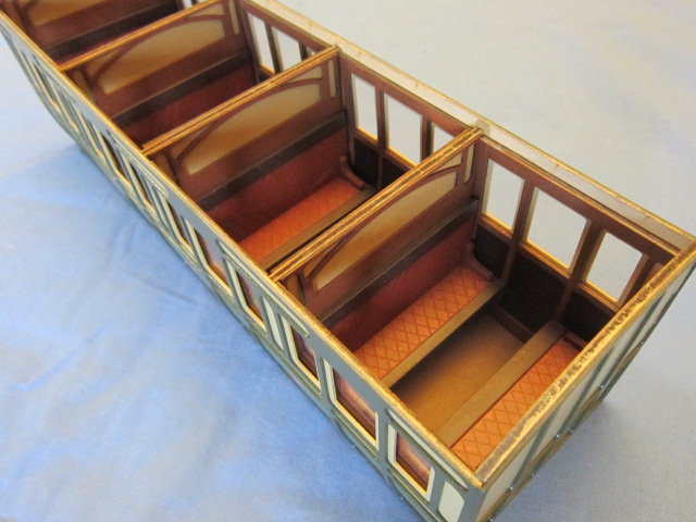

It has been almost a week since my last post and much has happened in that time. All five coaches are now assembled, complete with external overlays, fully painted and lettered, roof panels constructed, along with the clerestory attachments, which have their glazing installed and all fitted with lining material.....
Only one coach has its seating as the exterior lacquer needs to be applied prior to the windows and inside panels being installed. These have to be fitted before the seats and interior overlays can be put in place.....
I am really pleased with them and they have been a pleasure to build, as are all Lineside Hut kits.

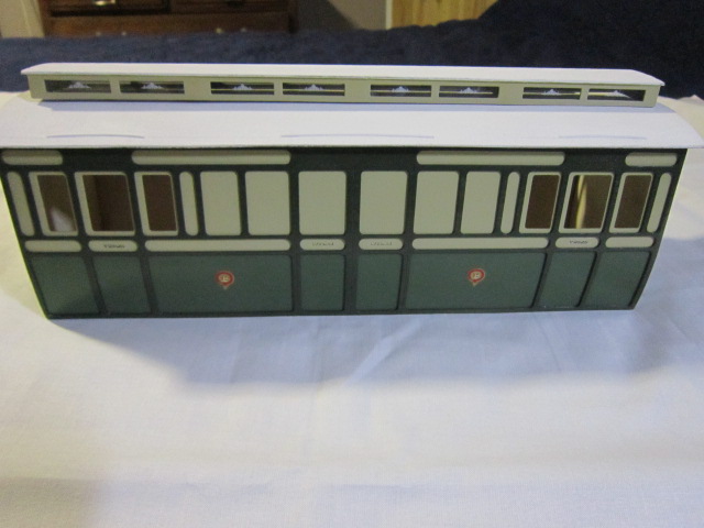

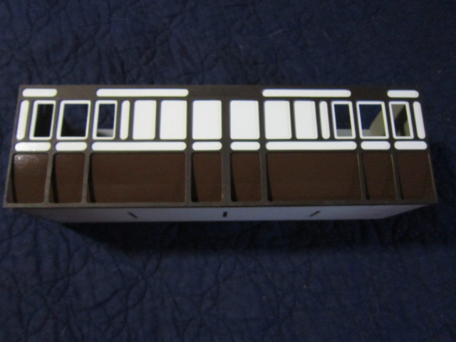

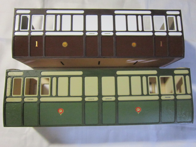

For comparison, the two liveries I have chosen side by side.....
One with the clerestory roof carefully balanced on top to see how it looks, I like it!.....

I really like the green! It will inspire my next livery choice I'm sure. The roof is looking good too.
