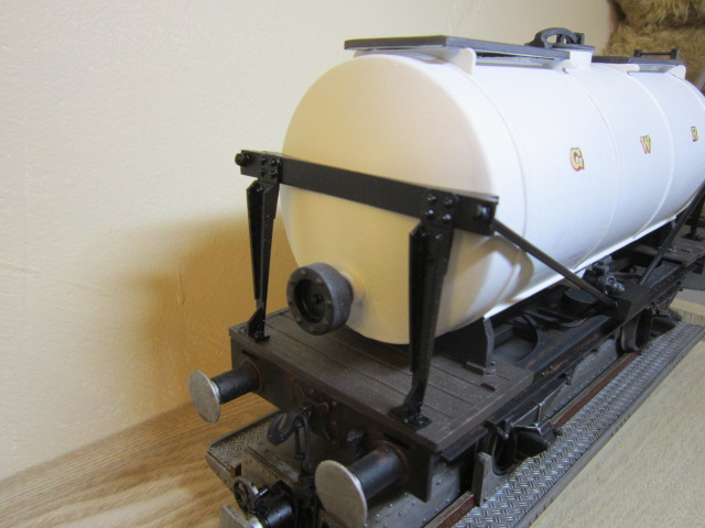

Browsing through images in Google I came across some side views of UK railway tank wagons and suddenly became aware of something I had previously neglected to do. Recently I purchased a pre-owned transporter wagon (see five pages back), and standard(ish) gauge tanker, which we discovered was made by Newqida (thanks Simon). This followed continental design, which is different to UK, but I just tidied it up and left it at that. I have just realised the UK ones appear to have additional diagonal bracing rods from each end to the centre of the wagon chassis frame, so I had to set to work to retro-fit these to correct the appearance....
When attached to the wagon I think it adds so much to the effect....

Excellent Petr, Anglisises it beautifully.

philipy wrote: Sun Feb 28, 2021 8:38 pm Excellent Petr, Anglisises it beautifully.
Or possibly Cymrifies??
Either way, it looks great, makes a real difference.

Diolch Andrew, I don't know why I hadn't noticed before. It certainly places it in context with the other stock.

Peter Butler wrote: Sun Feb 28, 2021 8:29 pm Recently I purchased a pre-owned transporter wagon (see five pages back), and standard(ish) gauge tanker, which we discovered was made by Newqida (thanks Simon). This followed continental design, which is different to UK, but I just tidied it up and left it at that. I have just realised the UK ones appear to have additional diagonal bracing rods from each end to the centre of the wagon chassis frame, so I had to set to work to retro-fit these to correct the appearance....
It looks great with the bracing rods, Peter, this was something I plan to do to mine. I wasn't aware it was a UK/continental difference, but noted that the bracing was common to the older wagons, while newer wagons appeared to have been fabricated without it - so it seems a good way to 'age' the wagon.

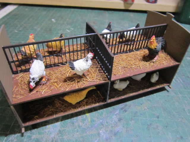

Swiftly changing the subject, another kit arrived in the post from Dave at Sixteen Mills. This is one based on, and adapted from, his livestock wagon which I covered previously. He happened to mention this during conversation and sent me an image, I was immediately hooked!
The original livestock wagon, now occupied by sheep, is based on a drawing by Spooner and intended for the Ffestiniog Railway, although whether it was actually built I don't know. The changes Dave has made are to increase the length and height slightly and add an upper deck with with four compartments on each level, each having sliding doors for loading, in this case, chickens and ducks.
The kit arrived yesterday.....
and now has reached this stage of assembly......
Posted: Fri Mar 12, 2021 10:21 pm
I'm impressed by the fineness of the grilles on the cages. They must be very fragile.
Those chickens look very much at home.
Posted: Fri Mar 12, 2021 11:31 pm
Rik, the grilles are surprisingly sturdy and very accurately cut. From my experience with Dave's kits he works things out very well and makes everything fit for purpose. Since my last post I have continued with the build, while watching 'Time Team' on You-tube.... very relaxing!
The current situation is as shown below, just the roof and underframe to complete. I'm very happy with this wagon as it fits in well with my style, not prototypical but plausible.....
