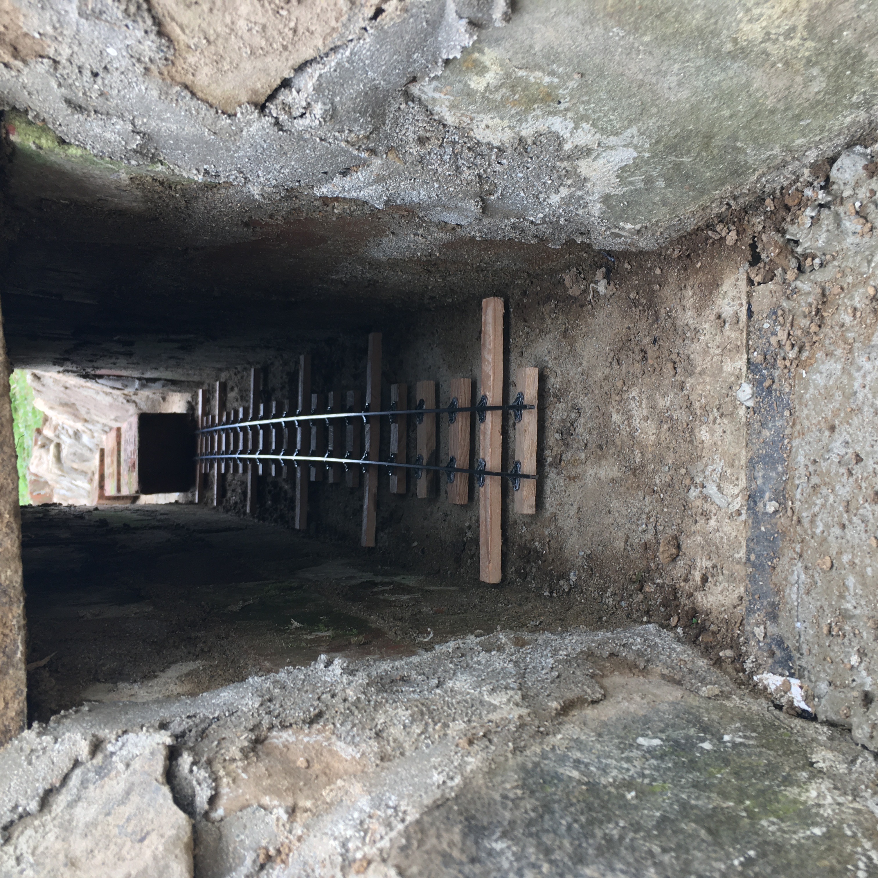

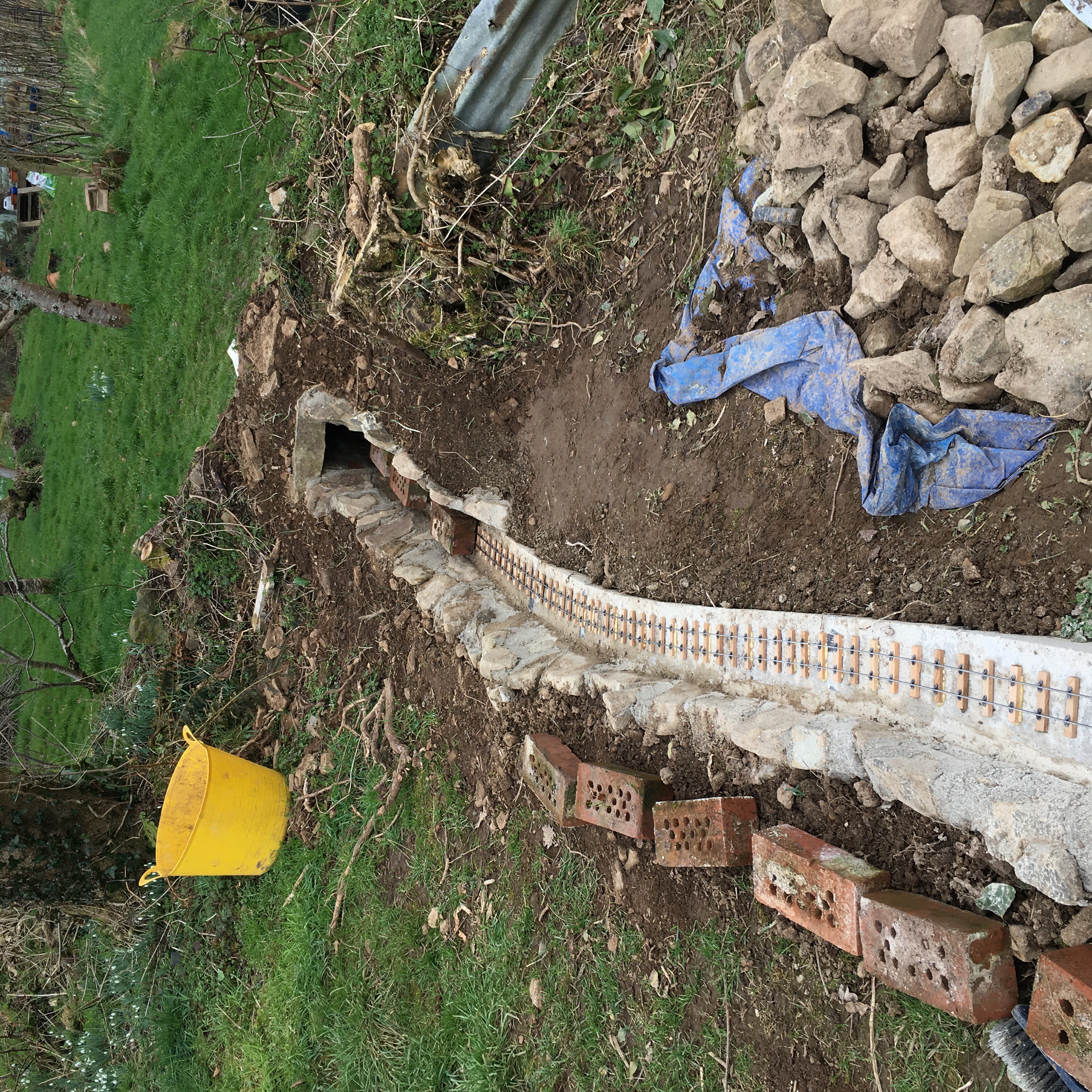

The track is now laid into the tunnel:
and ready to extend out of the tunnel:
The next section will involve concrete steps, and stainless angle laid into the concrete steps again - just like those crossings further down the line. As a technique it has been quite successful. Sturdy enough to take wheelbarrows, reliable and no bridge to obstruct the passage. As a detail I have added some long sleepers to the length of track which goes in the tunnel:

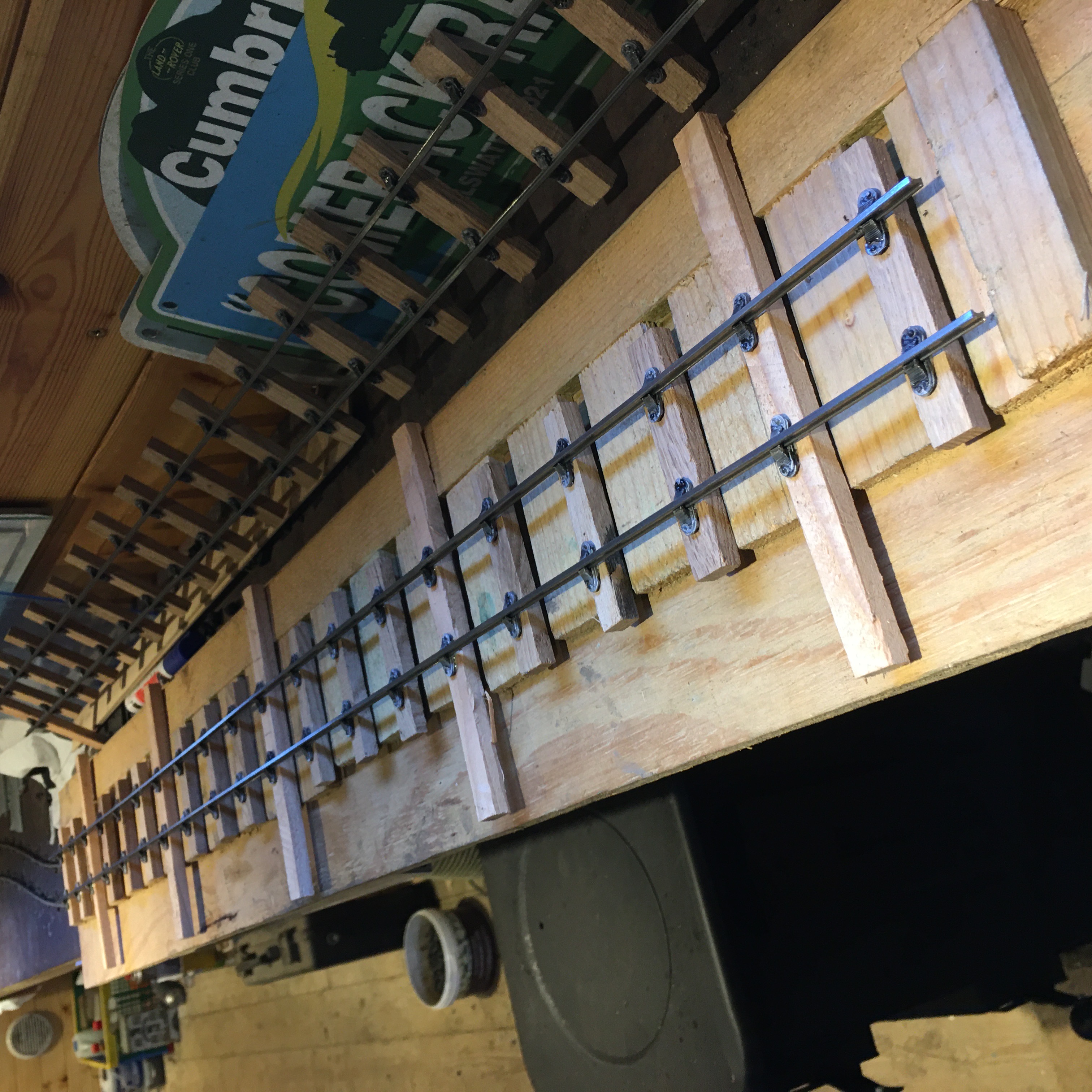

Every 4th sleeper is long enough to almost touch each side inside the tunnel. This is how it looks when laid:
The idea is that that track in the tunnel is not held in place or ballasted - it is just sitting there - and the long sleepers are to keep it sitting in the middle of the tunnel - rather than creep to one side. I am hoping that will be sufficient to hold it in place.

I would have thought a little ballast would not be a bad thing?
Though I suppose it could hold moisture?
Just thinking it might 'lift' when the rest of the track gets hot. It would then drop, when a loco passes over, but probably lift with just stock. Might this cause uncoupling?

Phil.P wrote: Sat Feb 25, 2023 6:51 pm I would have thought a little ballast would not be a bad thing?
You may well be correct. I just want to avoid problems with the ballast getting into the flange way. If it doesn't work I will have to think again.
The last set of track I ballasted has quite a few places where the flanges ride on the ballast and not the rail, and I need to clean that out when its a bit warmer. I want to avoid having that problem in the tunnel.

Trevor Thompson wrote: Sat Feb 25, 2023 6:44 pm The track is now laid into the tunnel:
Clever idea! I think it will work well.

Good idea, but my only concern would be that with the track not being constrained vertically, inevitably dust, then dirt, then leaves, etc, will work their way under, and getting it will be a problem.

Good to see some of the sleepers in use Trevor and very sensible to use a long one in the tunnel every so often, saves making more of them. A Henry with long nozzle attached would probably deal with most incipient problems of crud in the tunnel and maybe a bung in each end when not running would also be very useful to hygiene?

gilfachphil wrote: Mon Feb 27, 2023 9:41 am Good to see some of the sleepers in use Trevor and very sensible to use a long one in the tunnel every so often, saves making more of them. A Henry with long nozzle attached would probably deal with most incipient problems of crud in the tunnel and maybe a bung in each end when not running would also be very useful to hygiene?
Those oak sleepers you made for me are incredible!
I had some long length of hardwood left over from making points and it didn't seem worth asking you to make 6 special ones for me.

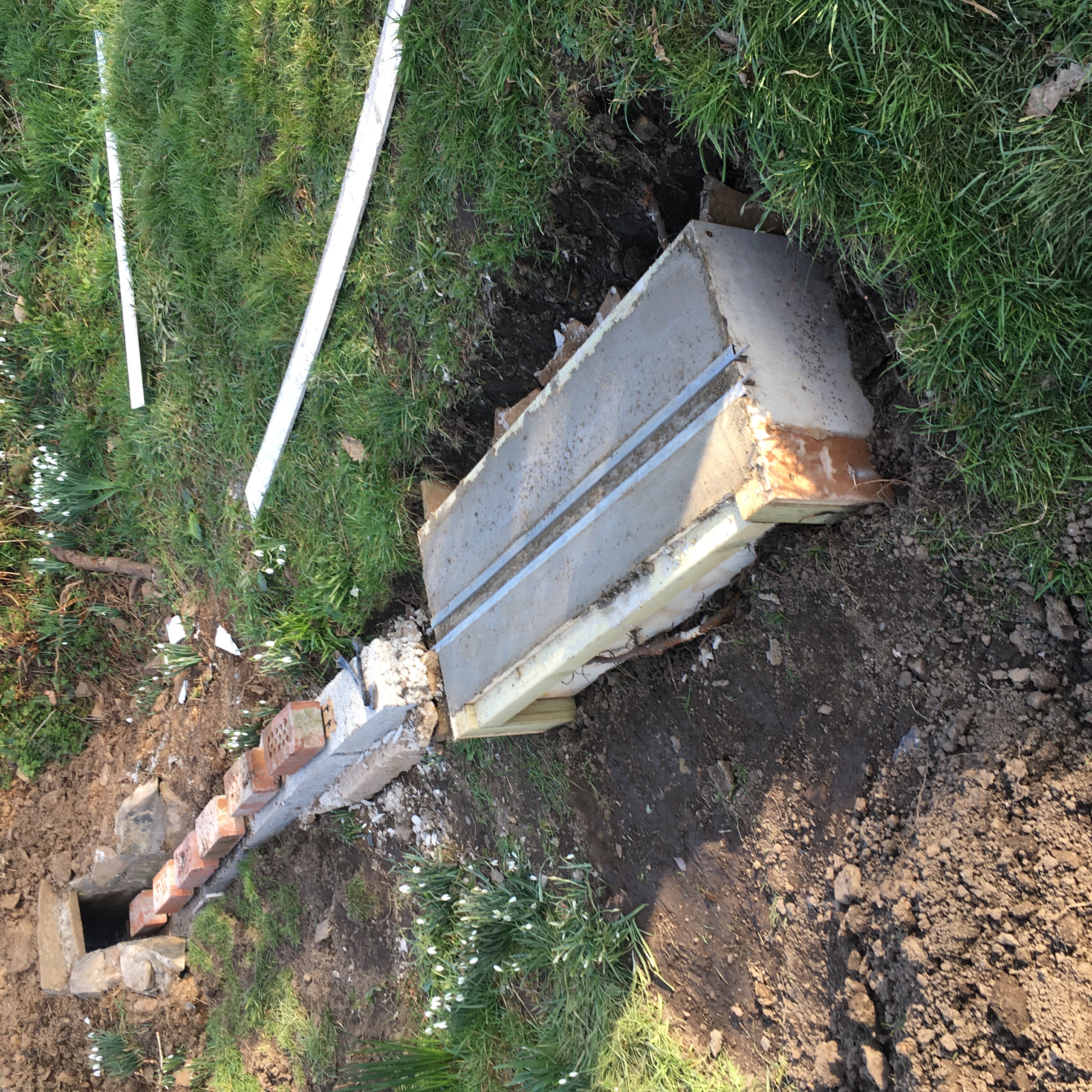

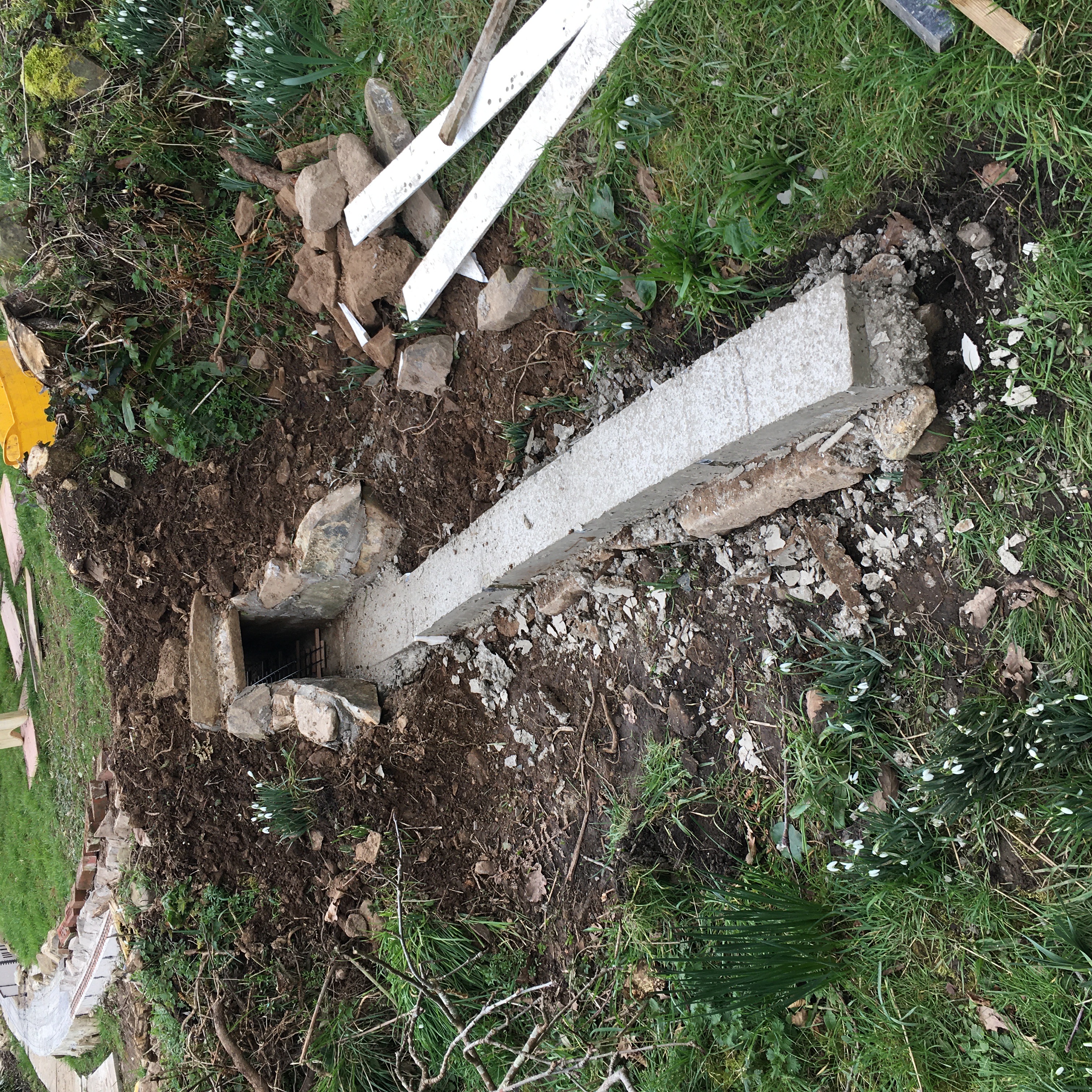

More progress on the civil engineering. The rails now exit the tunnel and approach the first step which will replace that slippery grass bank:
Shuttering in, concrete laid and stainless angle in place. It needs a few days to cure before I can remove the shuttering. You might be able to see that something moved while I was pouring the concrete so the track set into the concrete does not line up with the track coming from the tunnel. I am impatient to get that shuttering off and modify the trackbed leading up to it to get the alignment right. It is a minor issue but I want to sort it!

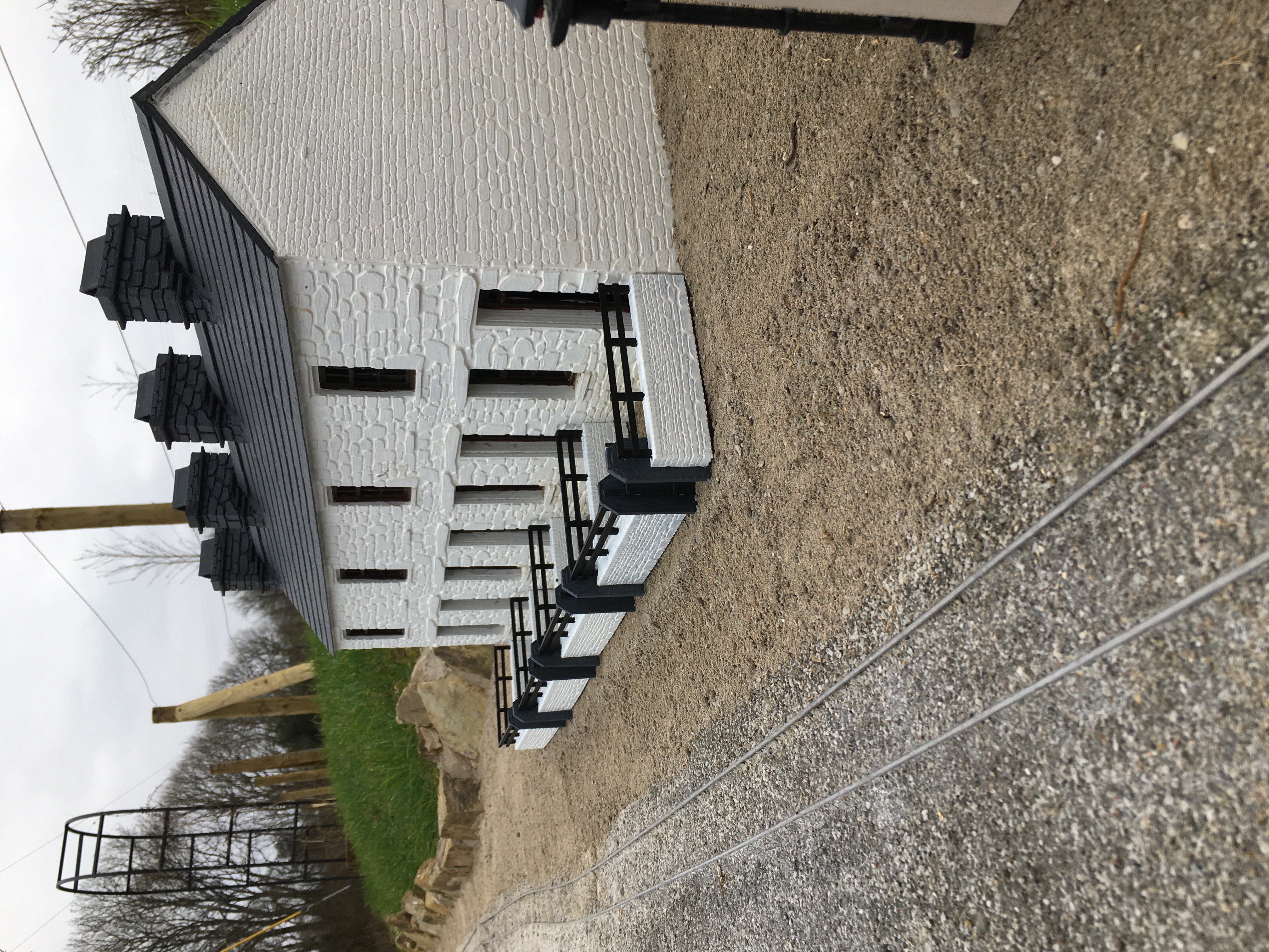

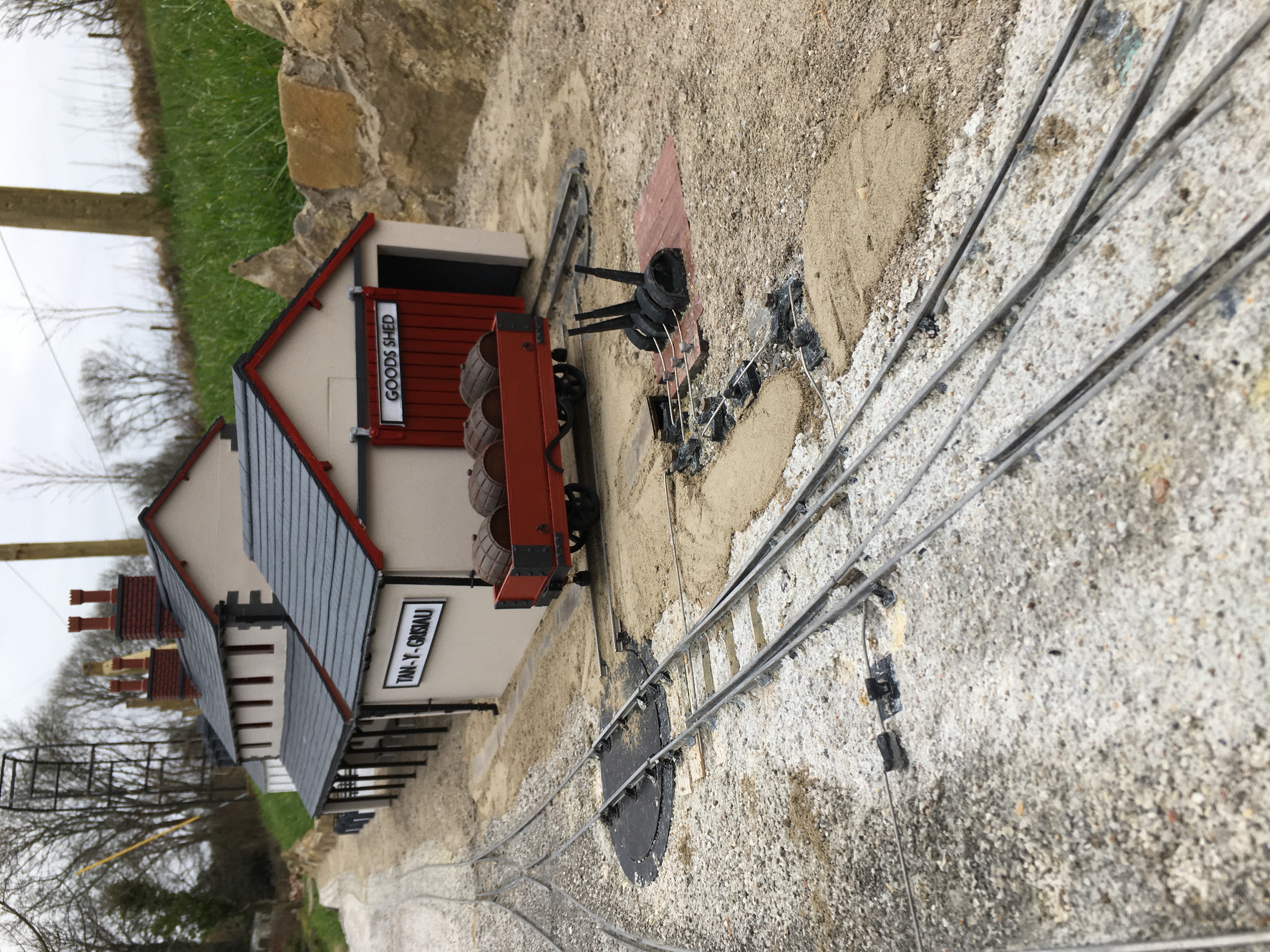

I have been working on the details which are intended to form a visual backdrop to the trains at Tan y Grisiau. Firstly the goods shed in place:
As an aside the real goods shed still stands and has just received a new roof.
And the garden walls for the cottages:
Perhaps I should stress that while the wagon turntables do work I am not really planning to use them - they are just part of the backdrop.
On the other hand the ground frame, and all of the point rodding, actually controls the three points at this end of the station. I will add the files for making the ground frame etc to the 3 D printing section shortly.

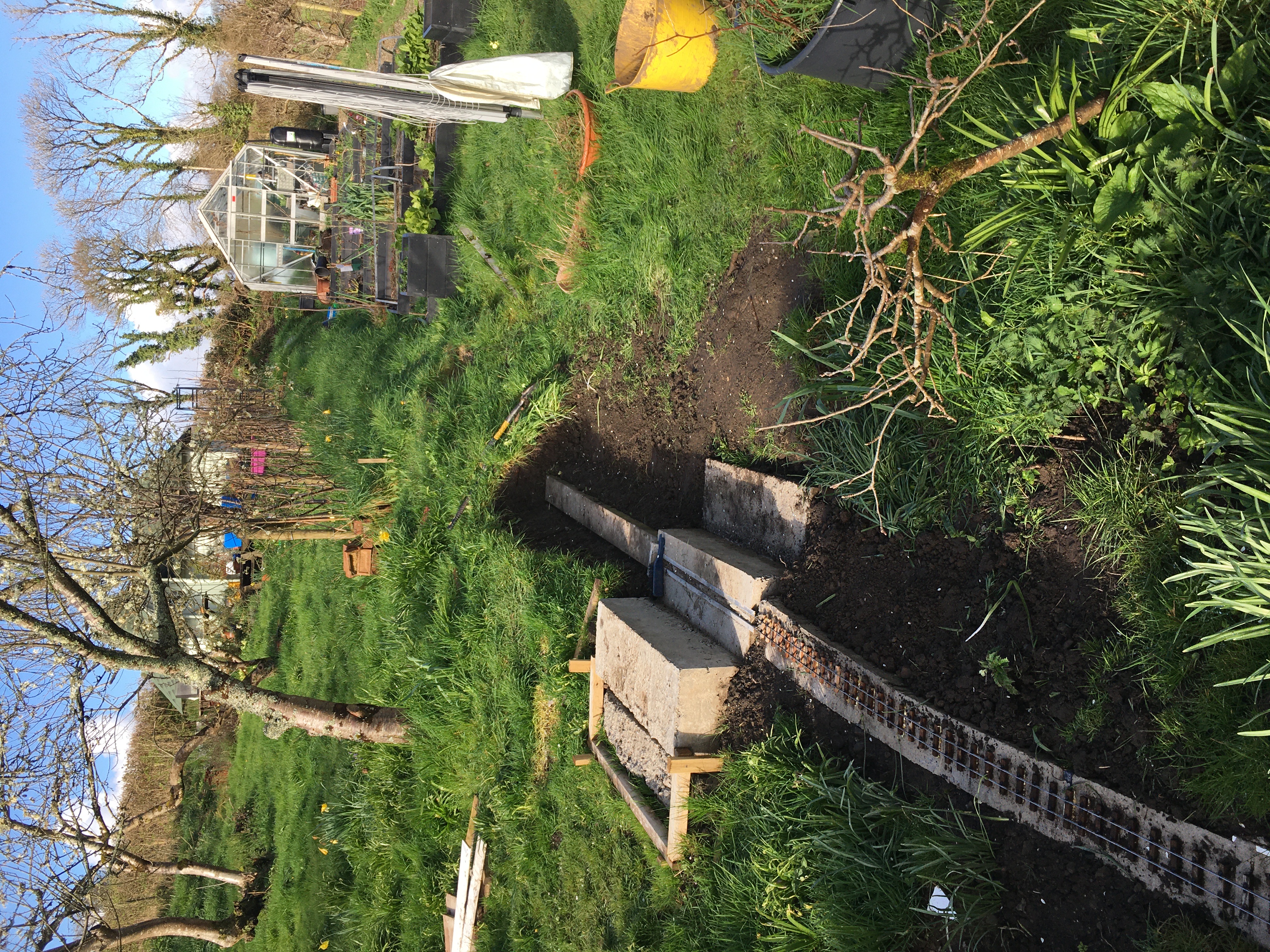

Post by Trevor Thompson » Thu Apr 06, 2023 11:37 am
The extension is progressing!
It has now reached the bank which will take it to its upper terminus. The steps are in place, the track connected to the track set in the step, and the first section of the new trackbed set into position:
From here the track bed will be on gravel boards set on their sides, with a stone retaining wall above and below. The stone is lying in piles in various places ready. Its a lot of soil to move but an hour a day seems to move it forward relentlessly (unless it's raining!).
I hope to reach the greenhouse by September. Whether that includes building the wall remains to be seen!
