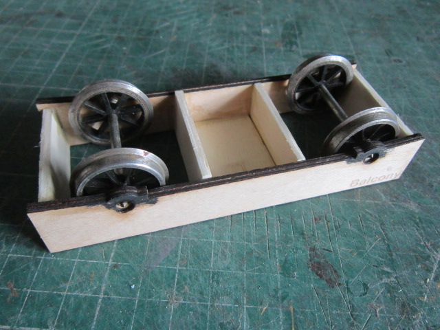

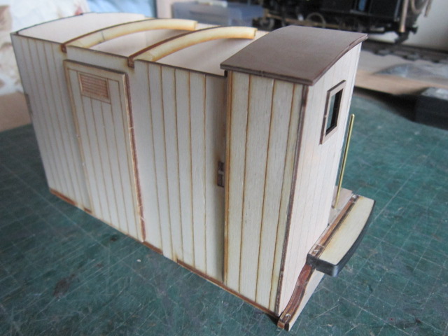

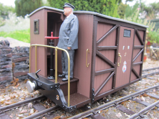

Continuing with the kit reviews I was doing while making up the Bug Box vehicles, I thought I would add the Ffestiniog 'Sentry' Guards Van to complete the set. I was introduced to the Jurassic range, which I have never tried before, and ordered the kit. This is the TM1 kit which Mike produces for Β£40.00 (including postage).
His communication was excellent and delivery prompt.
The kit includes the wooden parts only, no wheels, buffers or detail parts. It is well cut from sturdy plywood to form the inner shell and high quality hardwood outer lining side and end panel overlays with well defined planking etc...... I had one problem however..... the DVD supplied to show how to assemble the kit would not play, this was no fault of the DVD itself, rather my inability to operate my own equipment, so I had to wing it.
It went together well and was easy enough to assemble, even without instructions......
I always paint overlays separately and attach later, this was no exception and worked well...... Fortunately I had wheels and bearings in stock which I fitted to the chassis sides supplied. I added spacers to the side frames to make a complete separate unit which made it easier to attach later..... So..... overall a very well thought out kit of good quality materials. Very good service from Mike and great value for money.

Is the lambs tongue effect on the frame work a product of clever laser work or diligent building?

So that's what it's called. I was going to ask the same question, except I didn't know the nomenclature. I assume we're both referring to the fancy bevelling on the outside framework? If not, was it done for you or is it further evidence of your steady hand and attention to detail?11thHour wrote: Wed Jun 10, 2020 2:14 am Hi Peter,

The lamb's tongue effect is laser cut into the kit. It is the main reason I decided to buy that kit as it represents an important detail of the prototype. It isn't shown at its best in the picture as the strong natural light reflects from the surfaces, they are not as pronounced as that when viewed close up.
I spent some time sanding, sealing, sanding etc. etc..... to make a good paint surface and I am satisfied with the result. Due to the panel being cut from plywood, the end grain of underlying layers becomes exposed making it more difficult to get a perfect finish. If this had been cut from MDF I think the effect could be improved.

I must admit I hadn't heard the expression 'lambs tongue' either Rod, but it seems to be the name given to the parallel bevel edges on the framework supporting the side planking. It is another detail which wouldn't be considered today on cost grounds but shows off the skill of the craftsmen building the original 19th.C. van.

I couldn't find a clear enough photo of the prototype sentry van online, but the decoration looks like what's known as a 'stopped bevel', which can be done with a spindle moulder. Although as Peter says, it would have been done with hand tools when the original sentry vans were built in the 19th C.Peter Butler wrote: Thu Jun 11, 2020 9:46 am I must admit I hadn't heard the expression 'lambs tongue' either Rod, but it seems to be the name given to the parallel bevel edges on the framework supporting the side planking. It is another detail which wouldn't be considered today on cost grounds but shows off the skill of the craftsmen building the original 19th.C. van.
A lambs tongue is a more complex shape used to finish the end of the bevel. There's a blog here showing how to make one using hand tools, starting from a machined stopped bevel. https://blog.woodworkingtooltips.com/2 ... s-tongues/
To complicate matters, here in Oz the term lambs tongue is also used to describe an edwardian moulding design used for skirting boards and architraves. Bunnings still sell it.......

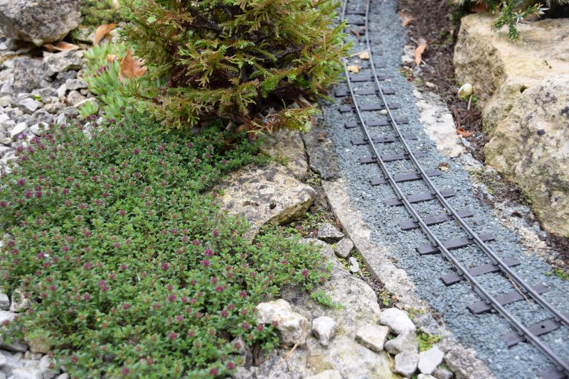

I did a quick inspection of the railway to check on plant growth, storm damage etc. and discovered this...... Natural creeper (?) of some sort growing quite realistically up the rear wall of the disused forge, if you wanted it to it would never happen!

Difficult to be sure from that distance, but it looks rather like "Creeping Thyme" to me.

That is definitely creeping thyme Peter. It's great ground cover, quite pretty and easy to grow but................................... it does tend to creep! Mine has crept all the way across the track in several places in only 8 weeks!
