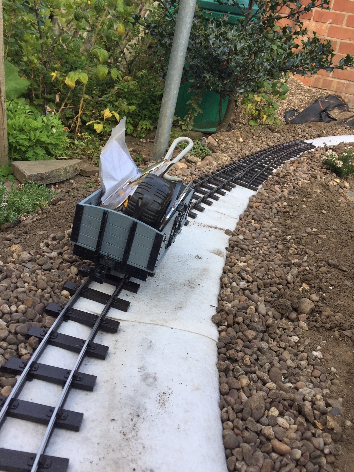

Some more progress today..................... but only just.
I'm not sure that I should admit to the debacle that commenced this morning with some basic surveying. I had the end of the track so far laid at one end of a curve and a turnout positioned at the other end of the same curve. Some simple calculations should have resolved the radius required to produce a circular curve between the two tangent points, and consequently the versines required to set the track out. Could I get it to tie up and come out with some realistic numbers - could I heck as like. Well, it's not like I do it for a living or anything!
After about an hour and a half of measuring and remeasuring I finally decided to attempt setting out the info I'd calculated..... and the problem became clear
, I was working from the left hand rail at one end of the curve and the right hand rail at the other!
Somewhere I have a photo of this being done in 12" to the foot scale! That unlocked the problem and I came up with some details, track laying began.
The alignment on this section has been modified since the foundation went in to allow for the loop and the connection to form a continuous circuit. Nothing massive but I knew the track would move across on the filcris runners. And move it did, far further than I had imagined, it was almost full gauge at one point and I began to worry that the loop road wasn't going to be on the runners at all
. When I reached the turnout there was a definite misalignment, nothing massive but the curve had definitely overshot. I unfastened the last yard and 'eased' the alignment to get a 'fit'. All well and good, until I stood up and viewed the job from a different angle. It all started well but the sharpening up was painfully obvious. I reckon I was down to just under three foot radius. I didn't measure it because I realised pretty quickly that if I left it like that it would haunt me for ever. What one of my permanent way colleagues refers to as 'making your teeth itch'!
Looking at the job I realised that the curve that had produced back from the turnout was a sweet alignment. I decided to recalculate all over again (!) this time using a new tangent point at the end of this acceptable curve. Up came the two lengths of track it had taken me the whole day so far to lay (And it was getting on for tea time - next door had fired up the barbie and were charring pig, making me VERY hungry!) I was setting out using a 500mm chord length. The new versine on that length was only about 1.5mm less but once I got cracking putting the track back down things fell right into place. THANK GOODNESS!
Anyway, a picture speaks a thousand words and four tell a whole story!
As you can see, the contractors were using a wagon to transport materials for the first time. No steam unfortunately, the wagon was drawn by a donkey - me!
I've got three other shots to share but the computer says no! They are apparently too large. If I find a way to resize them I'll up load them later.

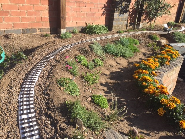

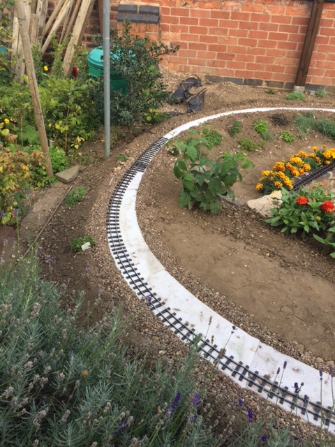

Success!
This is where I got to today. This is where I've come from This is where I'm headed Andrew

Against all expectations there is more progress to report today. I was early turn Signalman at Rothley today but managed to get away earlier than expected. I finished of a little bit of yesterdays efforts before I went to work. This only involved sending down a couple of pins that I'd either missed yesterday or which had worked loose as the track cooled last night. I also loose laid the first yard of track off the turnout - just to see where I was going and how it 'felt'. Once I got back I nailed this in it's final position and then pressed on with another four lengths. I was pleased with this progress as it included having to break off from pway work to lay the next stretch of geotextile between the two bridges. This involves an element of gardening as the edges of the geotextile need to be trapped and the pea gravel cess drain installed on top of it. It was a great relief as I moved onto length no. 3 as I was able to go from kneeling and bending down to ground level to being able to work standing up, as this length brought me alongside the operating well!
There was also an element of adjustment to the track panels today. I've had a stock built up ready for some time, all with standard gauge sleepers. It's always been my intention to use gauge widened sleepers on the tightest radius curves (1350mm rad). Most of this is in the curve at the house end of the main circuit, forming a semi-circle. There is also a little bit in the loop at Woodhouse Eaves (one road laid yesterday), a small amount to be laid in the loops at Shepshed (when the time comes) and a small amount entering the terminus at Abbey Lane. This has left a stock of gauge widened sleepers on hand and so I decided to lay them in the second tightest radius curves (1540mm rad) laid today. As they reverse a coupe of times I thought it would be a good idea, helping as it will to reduce 'flange drag'. Consequently I had to stripp off some of the standard gauge sleepers and slide on some gauge widened ones. The bench I bit down in the well proved a very pleasant spot for this job and the ledge I built to stand mugs of tea on beside the bench also proved very succesful!
This is where I got to today. This is where I'm going next. This is the end of yesterdays works and the first part of todays. This is a view across the long curving embankment, scene of most of todays work. This is the site of Anstey station. I'm pretty set on having a short traffic siding here and the present tracklaying spree will have to pause when it reaches this spot as the turnout needs building! I've not completely decided on where the turnout is going to be sited yet but it will almost certainly be on the short section of straight that exists just before the start of the 1350mm rad semi-circular curve. That's where the chilli plants are standing on the track bed in the photo below. You can also see the gauge widened track track dropped loosely in place in the foreground on the curve itself. The jumble of brickwork is where the path down into the operating pit will cross the line. I really should be doing some work on the house or the allotment tomorrow, but it's forecast to be another glorious day, ideal fro track laying.........!
