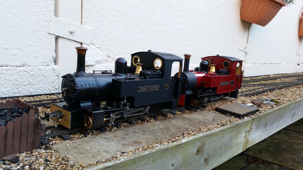

Post by tom_tom_go » Sat Apr 08, 2017 7:45 pm
I managed to play with both my ladies in the sunshine today, yeah you heard me right :mrgreen:
Posts: 1905
Re: RWLR - All change!
Post by LNR » Sun Apr 09, 2017 4:22 am
Ah, signs of a well used railway, burnt spot at end of the platform. Glad you found the time to enjoy.
