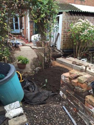

My other half fell over in the Garden on Wednesday, thanks to the gravel path subsiding into the gravel quarry. I knew I was pushing my luck the other week when I quarried another six inch strip to finish the new path foundation. Well, I couldn't risk a repeat 'Human derailment', it could result in a withdrawal of planning permission! So, I set to in every spare moment of yesterday and finished the path. It was too dark for pictures by the time I'd finished but some will follow.
This major leap forwards has opened the way for the first stages of railway construction (at last!). I've splashed out and treated myself to a piece of board and some frame runners from Filcris for this first stage of construction, they arrived today. I was late home though and I've not even unpacked it yet! I've got them to cut two sections out of one end to use as templates to form the curved sections of the support frames to consistent radii. I'm itching to get started now!
As a fundamentally Midland man I couldn't agree more about the Avon Valley. The 'temporary' box at Kingscote is now at least ten years old and finally being replaced by the permanent box at the north end of the station (formerly Brighton Upper Goods). I'm back there again this weekend for my final two turns in the old box.

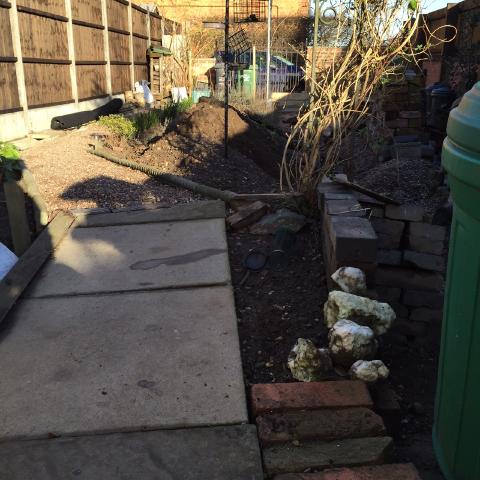

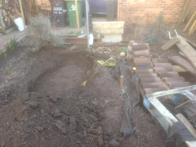

This is the excavation work for the station approach. Levels still have to be finalised but I can see much more clearly where I'm going now (although I appreciate it might not be obvious to anyone else!)
An this is the view the other way. The railway needs to squeeze between the vegetation and the path to the centre left of the picture; a tunnel may be in order here! There will be a continuous run in the bottom part of the garden (that currently resembles a moonscape!). It will be at a lower level and the gradients between the two are still under review but the aim is to go no steeper than 1 in 50 at worst (and hopefully much less)
Further work was done in the lower area with the transplanting of some gooseberry bushes off the course of the railway. A long way to go still, but no quite so far as there was before this latest push!
Watch out for the next thrilling instalment.

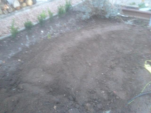

With the ground clear the top soil was stripped off to make way for embankemt core construction using sandier material stockpiled earlier.The alignment can be made out curving round from left to right.
The embankment core was them tipped and compacted. The aim is to drive plastic stakes into the top of this after it has settled and compacted. To these will be fixed longitudinal runners, one either side, much like the Filcris system only using cheaper commercially available materials. The track will be fixed directly to the top of these runners. The final part of the embankment will then be built up around this construction.
Finally a pretty diabilical shot along the line of the embankment core. I hope you can make it out curving away to the left. this was just as I was finishing work and the light was distinctly fading!
Goodness knows when the next leap forward will be, the allotment is calling for attention too, but I'm determined to press on as soon as I can now. I need to get some flower beds prepared (apparently!) so that the garden has colour in it this year!

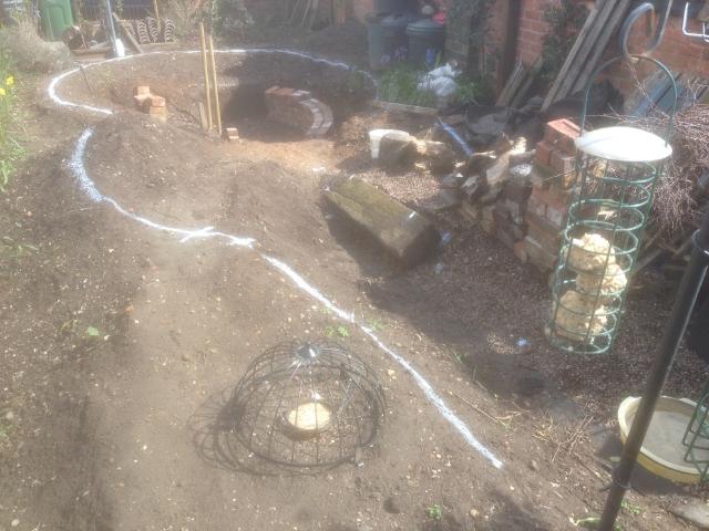

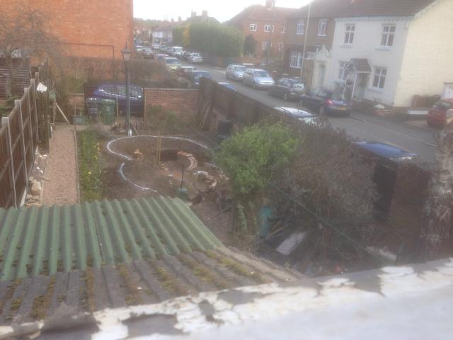

Today I managed to do a little bit more setting out to give me an idea of where things will fit. This seems a good photo opportunity so please see below. The route is marked out in white line marking paint, it covers about half the total railway, junk (sorry, stored materials!) prevent going any further. The right hand side nearest the wall is quite difficult to make out as it is partly hidden by the rough ground. I'm not planning to build the line through the current topography, once the Filcris foundation is in I shall be terraforming around the railway to form the ground profiles I want to best fit the line and make it interesting.
View of the bottom end looking over to where the passing loop will be.
Looking back up the garden towards to top end, the branch will peel off on the right hand side and run up beyond the arch (covered in honeysuckle) to the terminous outside the kitchen.
View from the bathroom window!
More updates when there is somehting to share - hopefully something more railway like!
