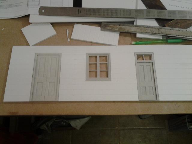

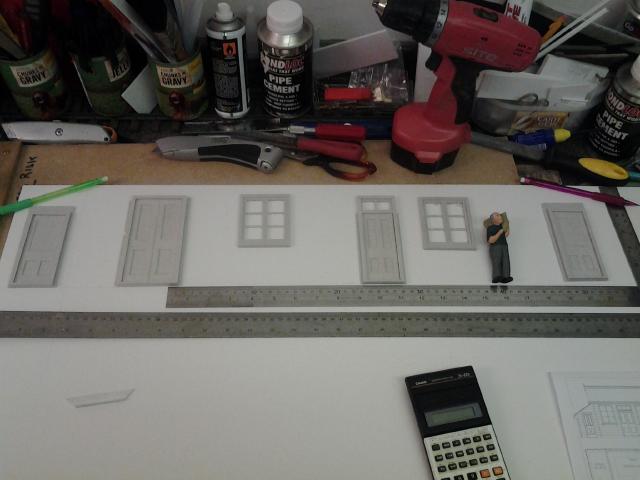

Post by bazzer42 » Tue Jan 28, 2014 1:14 pm
Back to 16mm this picture gives the indication of how long a store cupboard, waiting room/booking office, ladies waiting room and gents will look... it's big.

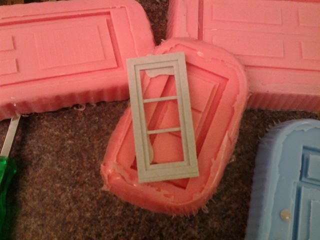

Post by bazzer42 » Tue Jan 28, 2014 8:17 pm
I'm using a teaspoon of fillite to about 10 to 15g of mix. Tempting to use more but it weakens the setting. Enjoy it. Peeling a casting out of the mould is very satisfying. Here's the latest casting from last nights mould.

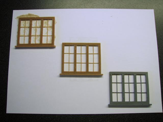

Post by philipy » Sun Feb 02, 2014 4:21 pm
Not wanting to hijack the thread any more than necessary, but I think this does go here to finish off the earlier stuff.
Excellent delivery from Tomps and I spent part of yesterday afternoon making the master and mould for a set of 5 identical window frames that I need. Then spent this morning, on and off, casting the frames.
I'm really chuffed for a first attempt.
The pic shows one just out of the mould, with flash, one cleaned up, and one sprayed with primer. The primer really shows up the pinholes due to bubbles, but I can soon deal with them!
