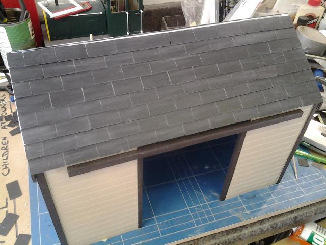

Post by bazzer42 » Thu Jan 02, 2014 12:02 pm
176 plasticard slates later..... The barge boards are on and next job is to add the floor. The guttering is going to be a pain but after getting this far I think it is a must do job.

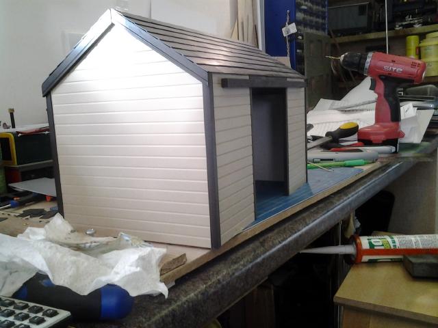

Post by bazzer42 » Thu Jan 02, 2014 6:44 pm
Door frame added and base completed. The capping tiles are scribed poly angle, the same as used for the corner bracings. This sticks well to the foam using solvent weld used in plumbing.

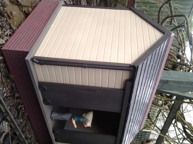

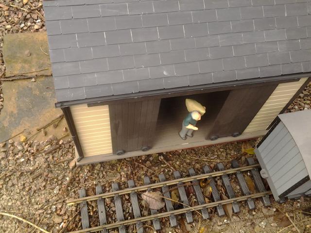

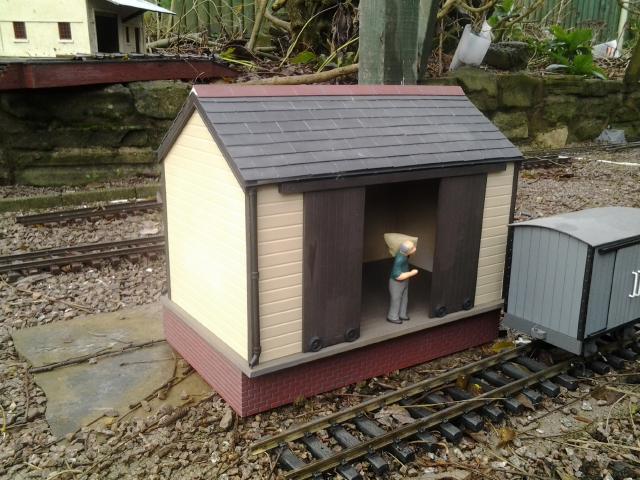

Post by bazzer42 » Sun Jan 05, 2014 11:30 am
Guttering now added from split styrene tube, a fleecy bunny tip.  The downpipes cooul work and have support courtesy of glowstick connectors. Virtually all there bar a door knob and private sign.  I will add some 12 v soft white leds for lights at some point.
Now for a station building in the same style.
Sorry for the crazy sideways photo but I'm struggling to rotate it on my tablety thing. :oops:
