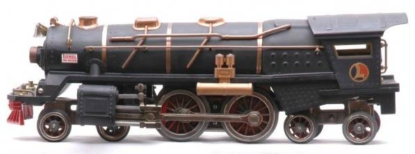

Build thread correction:
MSR also sourced the dummy air tanks and compressor castings from Model Engineering Works. It was always MSR's intention to eventually develop their own air tank, and compressor castings as well, as they considered the ones they had sourced to be rather crude even if they did add weight for traction. Of course Jim's untimely death meant this development never came to fruition.
Since writing the build thread I have found a few corrections that I need to make. The first is this one in relation to the dummy air tank and compressor. This is actually a reproduction part for a pre-war Lionel 400E standard gauge electric train from the USA.
You can see an example here on a restored Lionel 400E Black Steam 4-4-4 Loco:
For the right hand side of the MSR the casting was done without the compressor part.

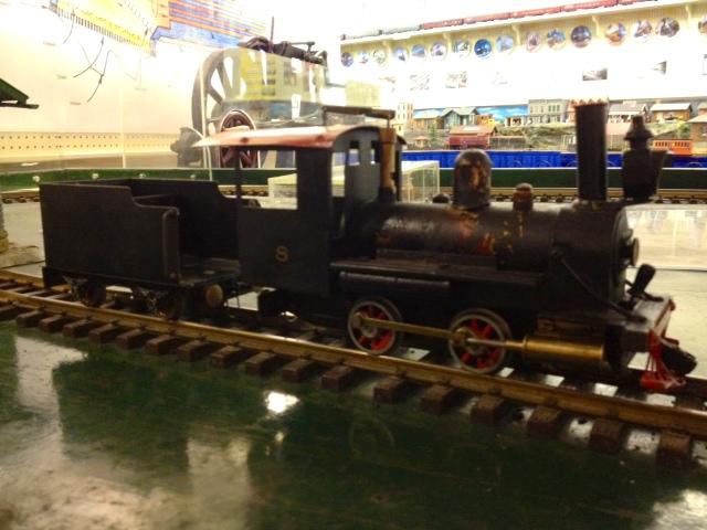

We have news from Patrick C. Morrison, Museum Educator 2 at the Railroad Museum of Pennsylvania:
Thank you for your inquiry about the MSR live steam locomotive. Yes, I believe I know which locomotive you mean. I have attached photos of its current condition. Sadly, we have not used this one for years. The guys who run these regularly tell me that it no longer works reliably. I’m sure it is fixable, but may need some parts, which I am not certain are still available. Instead, we rely on a fleet of Mamod 0-4-0s that we have maintained and operated for years. We even use the MSR’s tender with these locomotives as part of the train consists we run on a daily basis here.
Perhaps, at some point, we will work out the bugs in the MSR locomotive and get it running again, especially with its American manufacturing origins, which is why we have elected to keep it and not sell it at auction or somewhere like that.
I have passed on Terry's details to Patrick so perhaps the MSR can be put back onto the live steam demo roster once again!

Post by Chris Cairns » Mon Oct 28, 2013 4:08 pm
Great to see that this loco still survives, and that the Museum has a policy of keeping items with an American manufacturing history.
Given that it is only really the cylinders that are different to the Mamod SL's that they are running it should not be difficult to getting it running again. Looks like it has had a lot of firing (denatured alcohol?) but I wonder if they regularly lubricated the cylinders internally?
Also looks like it has had a front end knock with a bent coupler and the pilot beam to smoke box struts being banana shaped.
I'm sure it will live to steam again.

Post by ace » Mon Oct 28, 2013 4:11 pm
That is great news! I am so glad that more of them are appearing out of their hiding places. Well done for tracking it down. :)
It also looks like it has a standard standard mamod safety valve too, where as it used to have the wilesco one. Some maintenance maybe...
