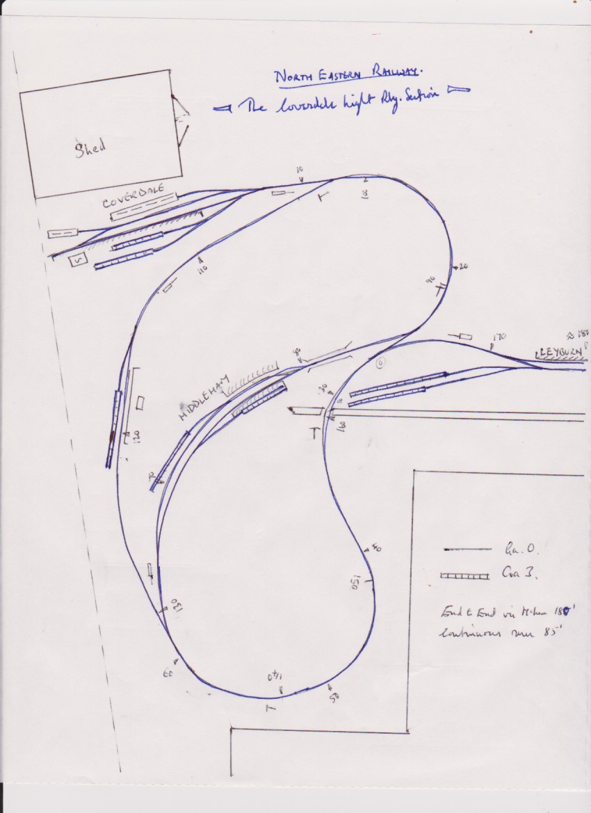

Okay, I have given the track plan a tweak. This version is largely traced and rearranged from the previous, so dimensionally there are some quirks which I need to iron out in the final draft. Trains leave Leyburn, and do a lap or three of the continuous run before diving into Middleham. After working any traffic there, they head back on to the loop, and do some more laps perhaps stopping at the small intermediate station on the continuous run. At the end of the journey it is in to Coverdale to terminate. I managed to get in a river bridge, and I did not have the space for the multi-level arrangement for Leyburn so I eliminated it in favour of turning it back against the kitchen wall.

Hmmm... I downloaded both plans to my phone so I could flip back and forth for comparison.
My 2¢ opinion... the former plan seemed less busy whereas the latter seems crowded and pinched. Would you be favorable of a level crossing of the Leyburn branch instead of a bridge? Might give the impression of a second railway connecting with the primary.

Yes, Dwayne, you are right. It is a bit cramped. Flipping back and forth between the 1st and 2nd version it looks like I do need to get something out of that area between the kitchen and the property boundary. I think it will be Leyburn that gets shifted back to being along the line of the sleeper wall. I do, however, like not having Middleham station on the continuous run, as that enables something a bit closer to timetable running. Time to juggle the elements of the design around again and see what emerges.
I am not enamoured of the idea of a flat crossing between two running lines. From a UK signalling point of view they are a bit complicated, and impose all sorts of operating restrictions. I am most likely to put Leyburn on a turn back road, and then flip the entrance to LB so that you have to go through Middleham and turn back in order to gain the track into Leyburn.

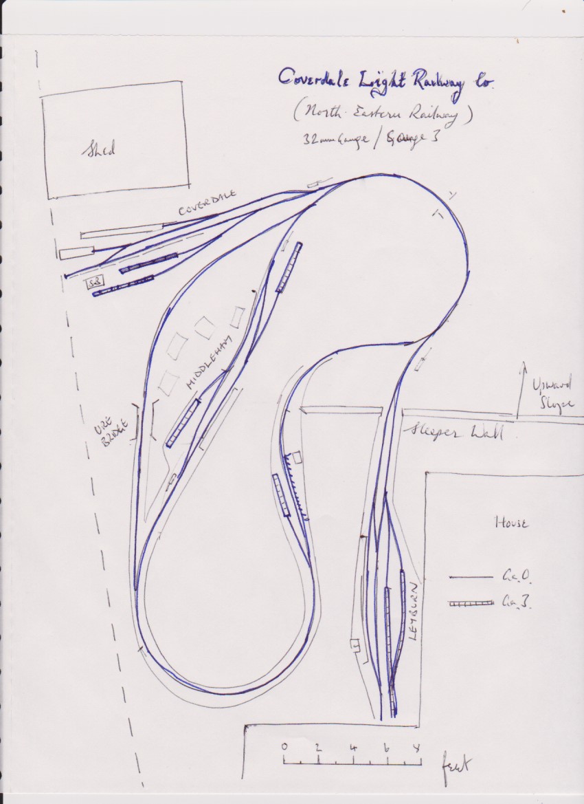

The mean that lieth ever between the two extremes...
Route of train: leave Leyburn and do one lap of the continuous run before entering line into Middleham. Leave Middleham, and the complete x. number of laps of the continuous run before entering Coverdale to complete journey. Or t'other way about!
Hopefully this is a lot less crowded looking. One interesting problem was running two trains on the old layout. On this version departures from Coverdale and Leyburn can both run clockwise until they are due to cross at Middleham, at which point both reverse direction and head to the opposite terminus... if I have planned this out right in my head!
Did I miss anything?

Peter, looks like a viable concept. Appears to have several options with two trains running and their respective meeting and stops at Middleham.

Hello Peter,
I've liked each one of the proposals but the last one looks really interesting. Operationally it appears to give the maximum flexibility, whilst looking very prototypical and is certainly the most 'open' and spacious of the three.
Looking forward to seeing more details as it develops.

Operationally, I like Plan 3, though I also liked Plan 2 as well. My only reservation about #3 is that Leyburn now looks quite cramped and has no run round loop. Can it be positioned in the top right corner where there seems to be more space or is that area off limits?

One snag with the wife's scanner and my scrap paper supply that we can only go up to about 8.5" wide. Therefore I only sketched in part of the track layout at Leyburn. It would actually consist a loop and two or three exchange sidings stretching off the right hand side of the drawing as presented here.
I am also planning on staging that construction, so that
Phase 1 consists of the continuous run and the small intermediate halt
Phase 2 consist of the 'turn back road' and Middleham station
Phase 3 Coverdale, then lastly
Phase 4 Leyburn.
It is important for me to get trains running because then it acts as a spur to get more done.

Ah, hadn't realised Leyburn was truncated in the plan. That makes operational potential a lot more interesting.IrishPeter wrote: Sun Jan 07, 2018 10:48 pm One snag with the wife's scanner and my scrap paper supply that we can only go up to about 8.5" wide. Therefore I only sketched in part of the track layout at Leyburn. It would actually consist a loop and two or three exchange sidings stretching off the right hand side of the drawing as presented here.
