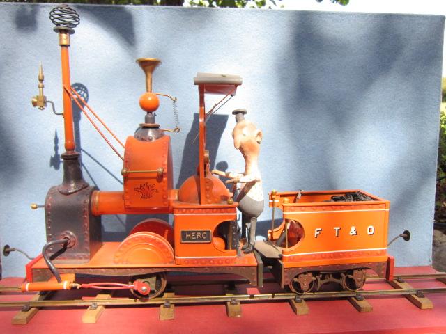

How I've managed to miss this thread beats me..... I am always on the look out for Emett modellers and this one looks to be amazing!
I can't do a live steam build, but my plasticard electric version does work on my garden line, carefully balanced by its tender which houses the motor.

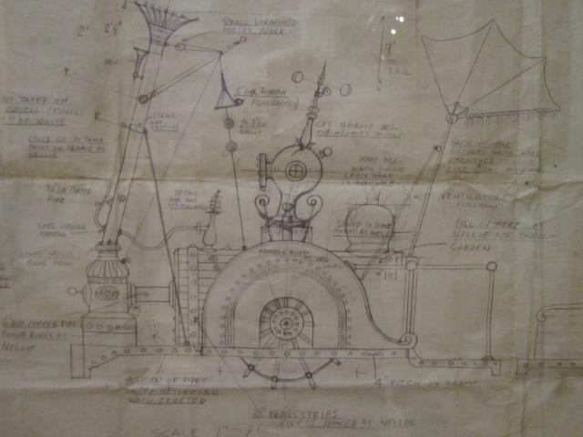

Neptune was in fact a 4-6-2 built by Harry Barlow to Emett's design. It was internal combustion, tender driven and carried passengers at the Festival of Britain 1951. Hero was never built and only existed as a cartoon by Rowland Emett.
This is the original Emett drawing which the loco was built from.

That's awesome Peter thanks for sharing. Have you found any ride issues with the single axle arrangement? Also how did you do that spark arrestor? Ive got a model trumpet for the chimney cap!

My guess is that this refers to your build, Bessytractor!. Firing my plasticard locos would surely end in disaster and no forward movement at all!!!!! (sorry Ace... couldn't resist)
In answer to your question about staying on the track..... it does so very well. There is some interesting wobble from side to side but never any indication it wants to fall off. The tender guides it into the curves and hasn't failed once.
Spark arrestor is from a craft shop and is designed for DIY jewellery making. I find a lot of useful parts from this source

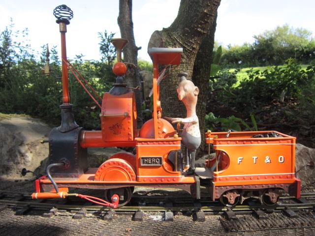

as promised!  Its a bit smaller than your average Mamod, but quite a bit taller, as befits its origins! Smokebox parts are on order at the laser cutters.
