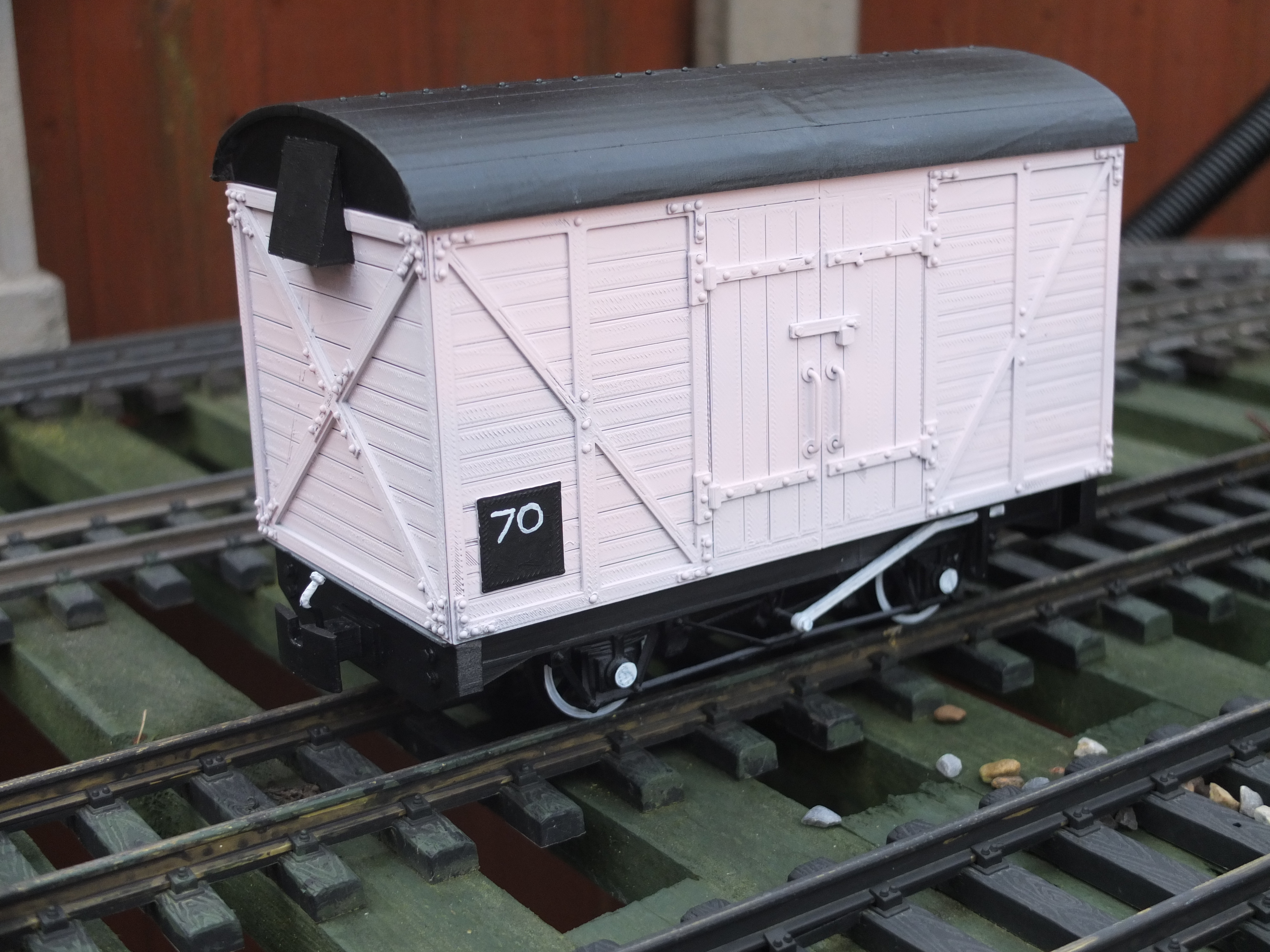

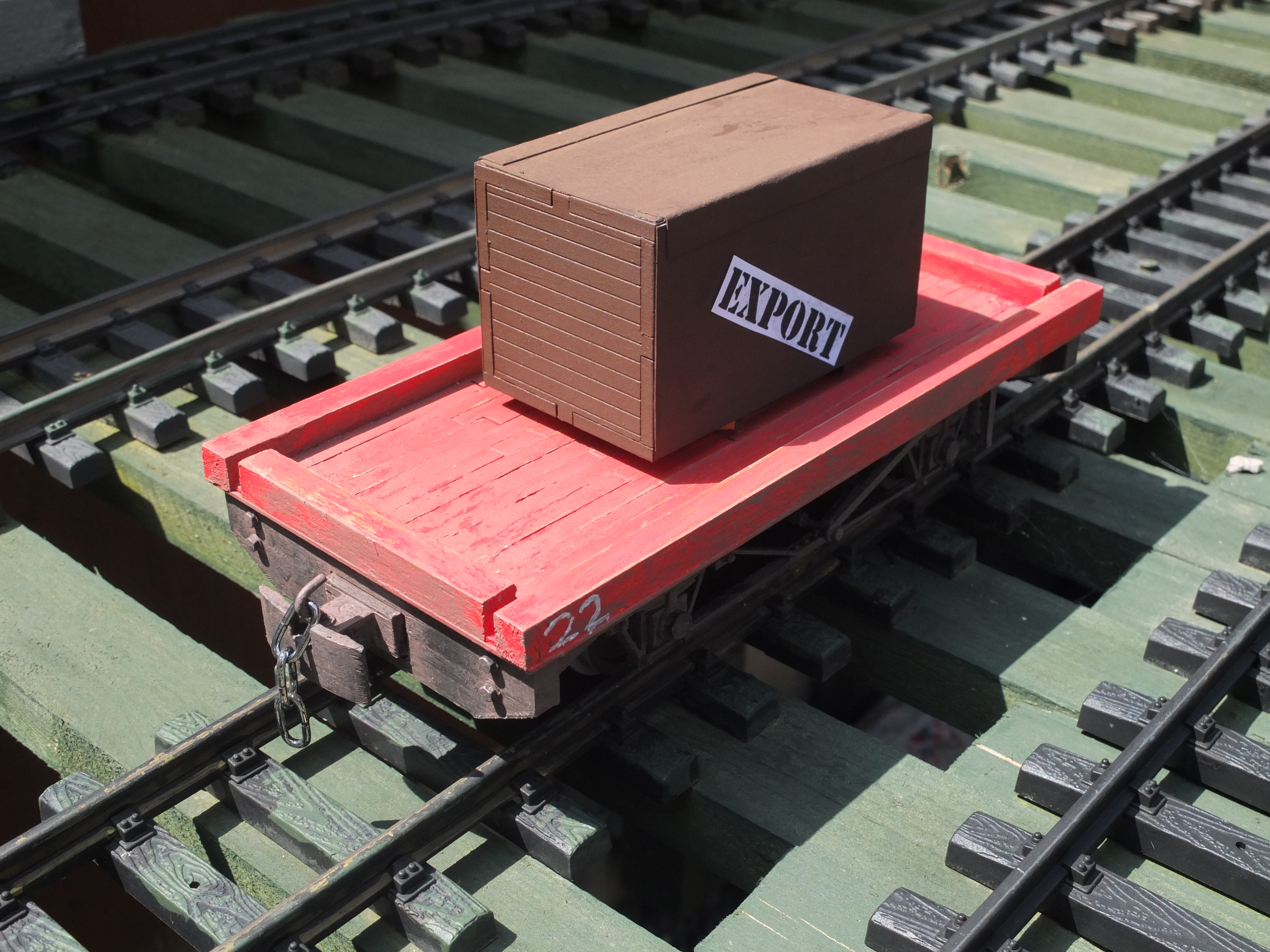

Just an idea. I designed and printed four rough and ready PLA+ vans a while ago. I made sure they were mounted on a 1mm steel sheet for the "solebar" and assembled them round a wooden (10mm x 10mm) wooden carcass) with Araldite. I fitted them with Binnie wheels. They are kept in a shed, although in the 30C+ temperatures I do fling the door open. They have been in there a while with no problems. My first 3D printed wagons were unsupported flat wagons that quickly warped and were rebuilt using a similar steel sheet as mentioned above.
van:
Mk2 flat wagon:
