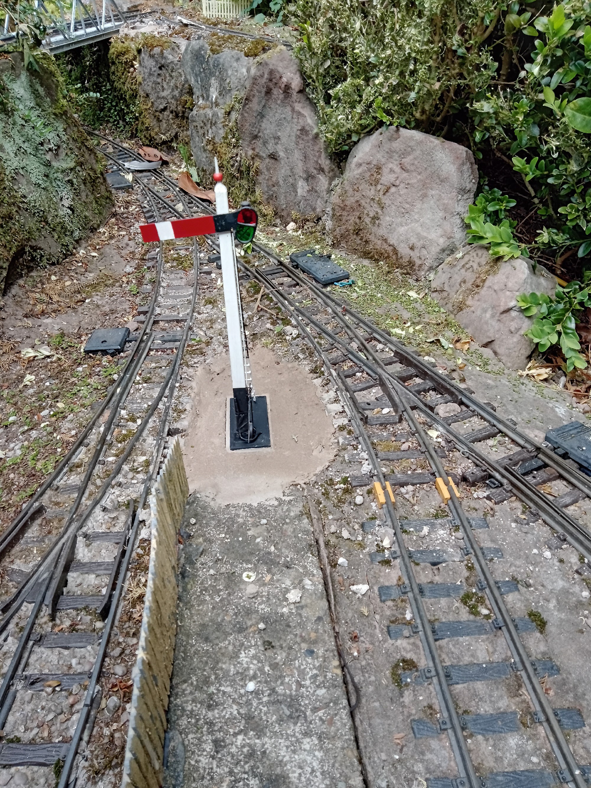

Post by ge_rik » Mon May 19, 2025 12:04 pm
Taken a while, but I've finally gotten around to putting in sockets around the railway for the signals at each station.
The sockets are simply four pieces of foamboard, sprayed black
These have then been concreted in .....
..... so the signals can then be slotted into place.
The sockets will next have ballast and other grot applied to blend them in.
I'm considering making foamboard lids to try and stop debris from filling the sockets when not in use. But I suspect the woodlice will still find their way in.

ge_rik wrote: Mon May 19, 2025 12:04 pm
The sockets look good Rik.
How about a solid block of a rigid foam ( aka electronics packing )? Easy to cut, waterproof and would fill the space and keep the gribblies out.
Posts: 7874
Re: RC semaphore signalling
Post by ge_rik » Mon May 19, 2025 9:07 pm
philipy wrote: Mon May 19, 2025 12:50 pm
Nice idea, thanks.
SimonWood
Posts: 791
Post by SimonWood » Tue May 20, 2025 8:51 am
philipy wrote: Mon May 19, 2025 12:50 pm How about a solid block of a rigid foam ( aka electronics packing )? Easy to cut, waterproof and would fill the space and keep the gribblies out.
I was thinking along those lines - but I wondered if you could just print a spare empty gubbins case, perhaps with a little handle to facilitate pulling it out, and just swap it over with the one full of signal+real electronics when you have a running session?
Posts: 7874
Post by ge_rik » Tue May 20, 2025 9:02 am
SimonWood wrote: Tue May 20, 2025 8:51 am
Another great idea, thanks
Posts: 7874
Post by ge_rik » Tue Jun 10, 2025 9:12 am
Thanks for the suggestion, Simon. I've now printed out sufficient plugs for all the sockets around the line. Trying to decide if they need painting to make them a bit more weather resistant.
