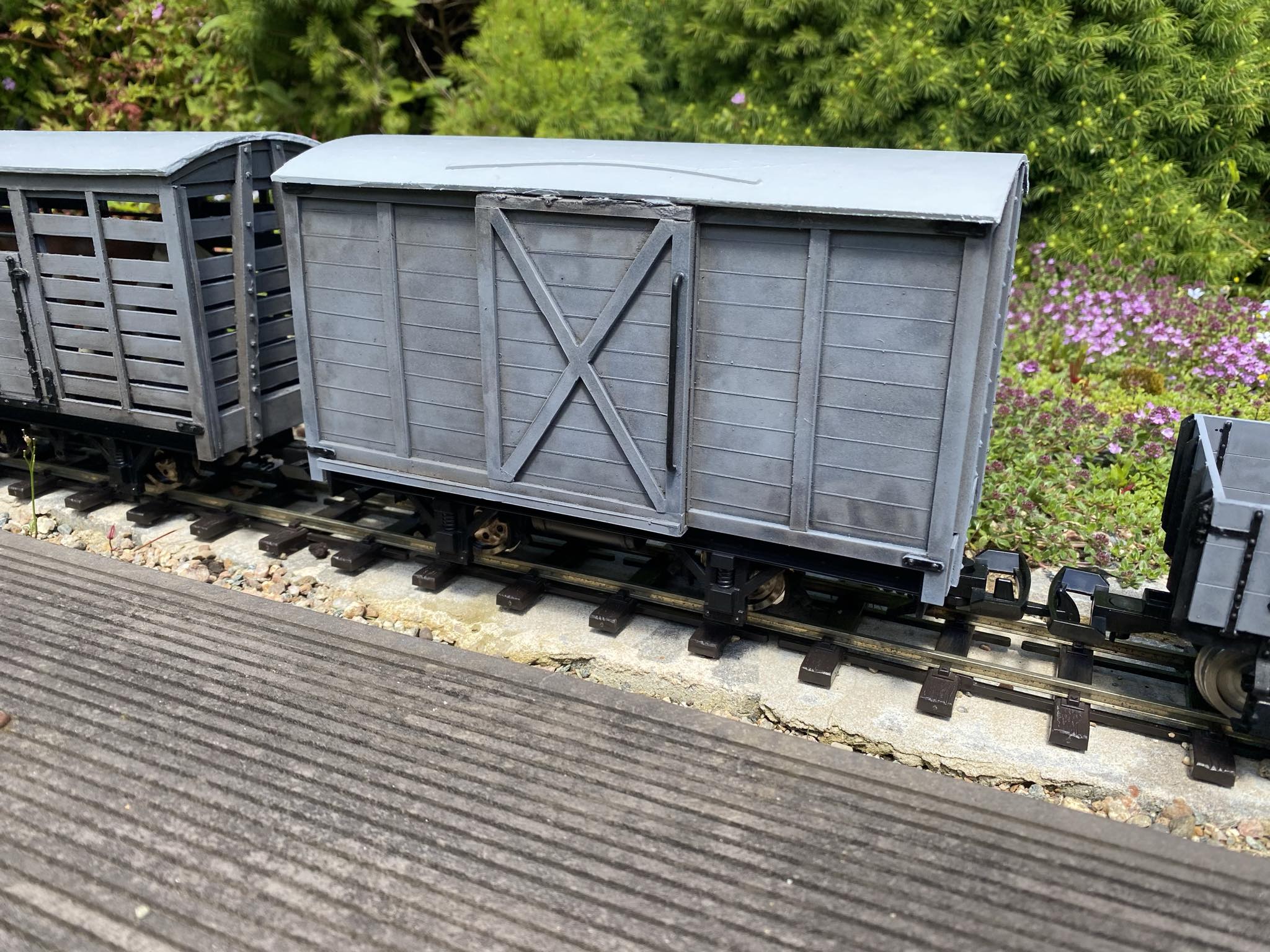

Rolling Stock Update:
Here are the items of rolling stock I currently have finished and in running order.
This is a Slater's Plastikard WDLR D Class Bogie Wagon Kit to which I have added bachmann g scale bogies and GRS 32mm wheel sets. The mounting brackets of the bachmann bogies were cut away from the bachmann flat wagon and glued to the underside of the slaters wagon body using two part epoxy. This was then primed using Halfords grey primer. Once dry a liberal amount of Games Workshop Agrax Earthshade wash was applied all over the wagon body. Once this had dried I then gave the wagon body a second light coat of Halfords grey primer. The black parts were then picked out using games workshop Abandon Black. This has now become my go to method for painting goods wagons.
This is a VOR cattle wagon built using plasticard and an lgb wagon chassis. The wagon body was built using this build guide from The Peckforton Light Railway Blog (https://riksrailway.blogspot.com/2009/0 ... agons.html). The body was then painted using the methods I have described above. Accucraft 32mm wheel sets were then inserted into the wagon chassis. A schleich cow has been added to the interior and is on a removable base.
This is a Welshpool style goods van built using the same guide as the Cattle wagon above. Instead of planking the sides were built using scribed plasticard using photos of the real wagons as reference. This was painted using my standard method described above. An lgb wagon chassis with accucraft 32mm wheel sets was again used here.

Thanks for all that Harry. Those wagons look superb and your painting method looks very useful. I use Agrax Earthshade a fair bit as well but tend to 'apply and wipe off', rather than overspray. I must try that some time.

Thanks! I tend to over-do the wash even when I'm trying to be subtle with it so this method allows me to achieve a consistent finish on each wagon. I did consider 3D printing wagons but my build plate is rather small so would have to be done in small sections. Also I'm yet to see someone build a garden railway wagon using just resin 3D printed components, though I don't see why this wouldn't work.
