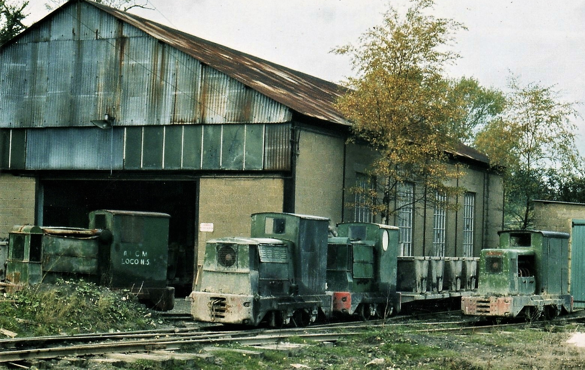

tommygander1941
Posts: 127
Re: A Ruston-ish ....
Post by tommygander1941 » Thu May 16, 2024 7:53 pm
ge_rik wrote: Wed Apr 10, 2024 10:02 am Dammit! I've just found this wonderful source of Ruston NG loco photos .... which includes, among many others, a three-foot gauge version
https://www.flickr.com/photos/34938158@ ... 2356322545
Plenty of inspiration here, chaps - and some clear detailing for modellers.
The 48DL basically changed body shape and name in 1940, going from the 44/48HP model and gaining a new engine. The RAF/RNAD versions built during WW2 had another different body shape, originating in Ruston's underground design.
I'll include a picture of the standard 1940-49 48DL mode, alongside the first and third designs (the 40-49 being the very straight-sided one)
APCM Paddlesworth Ruston Locos.jpg (2.26 MiB) Viewed 85439 times
Posts: 8037
Post by ge_rik » Fri May 17, 2024 7:53 am
Personally, I prefer the earlier "chunky" models. They lose a lot of their individuality when they become more streamlined.
