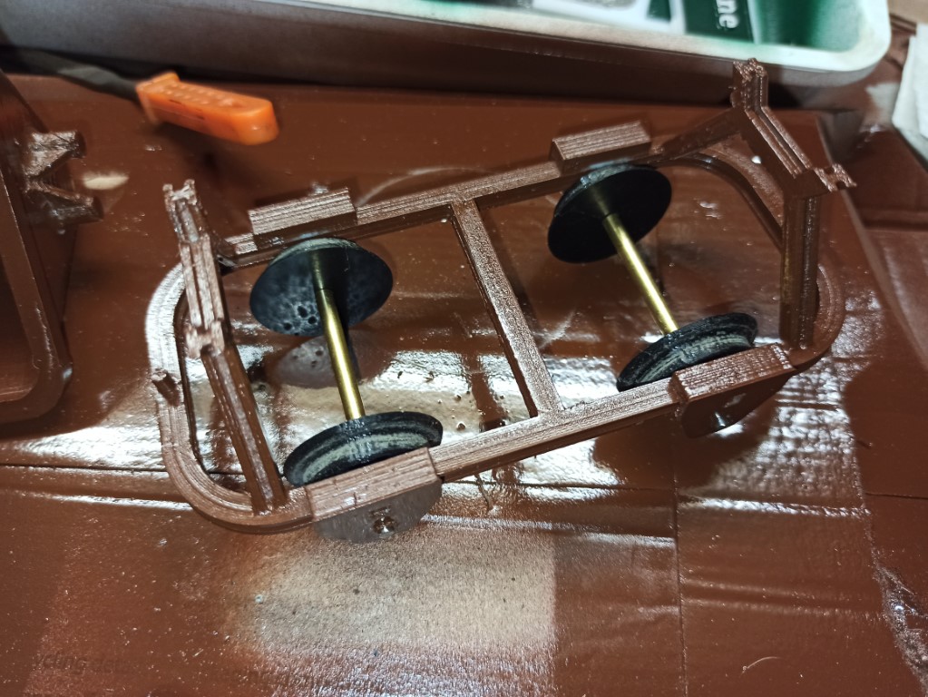

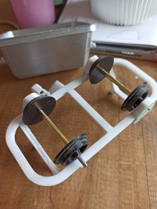

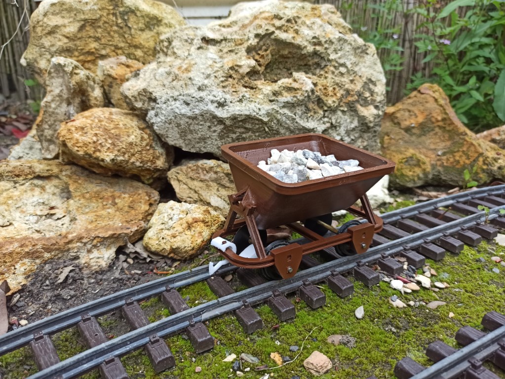

Here are some news of my layout. I have printed my first truck from thingiverse a hudson tipper. The wheels axle is made of 3mm stainless steel . The bushing and spacer are made of 4mm brass tube.
the truk has been painted in brown and it works fine on my LGB rails with some weight in it.
I also add some gravel in the "mine" area. Now I am looking for plants to put into the 2 white flower boxes to cover the side of the boxes.

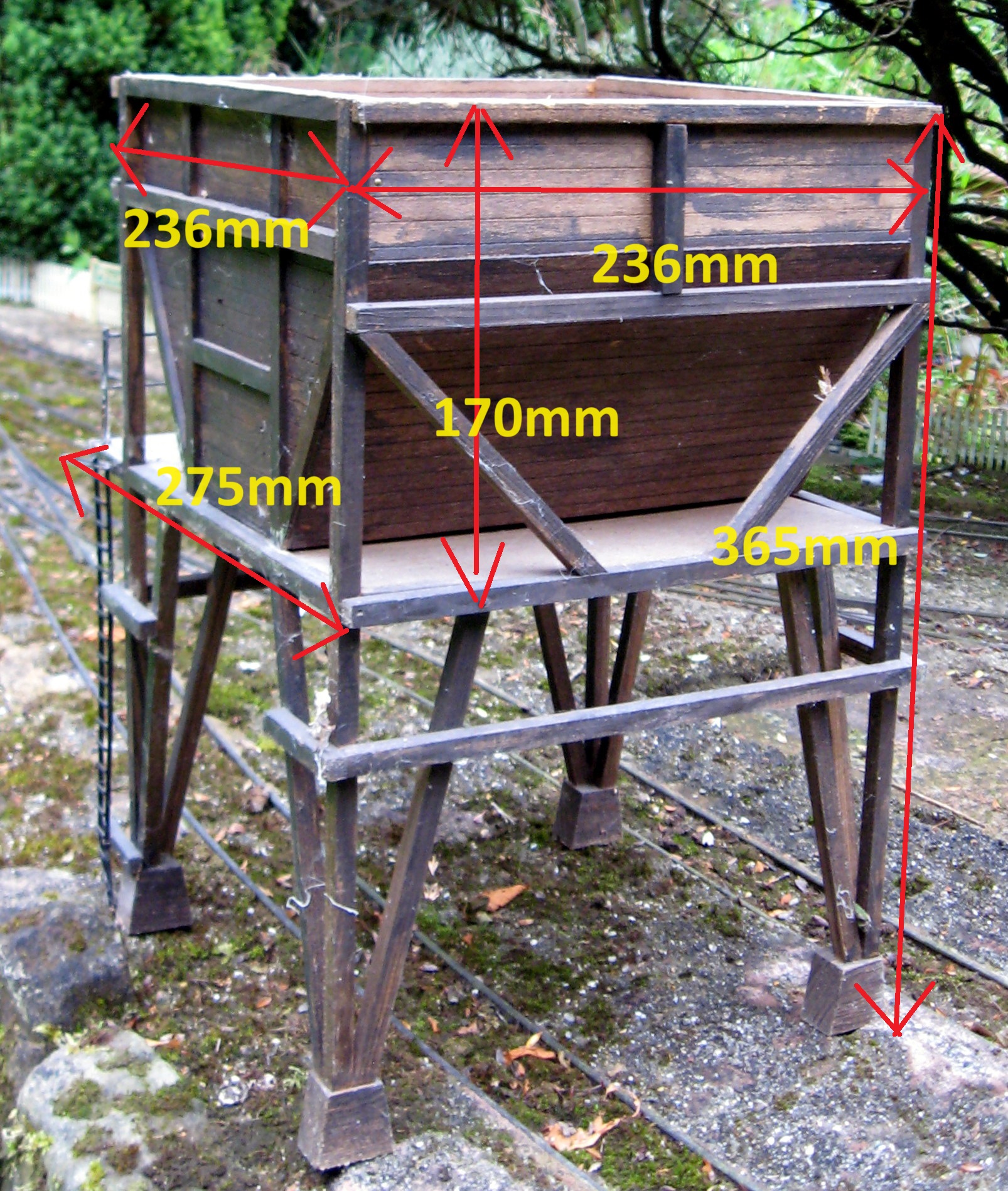

Rik I have a question for you :
I would like to add a Mine Hopper but I have no idea of the dimensions. I saw that you have one on your railway :https://riksrailway.blogspot.com/2012/1 ... opper.html
Could you give me some measurement for exemple total lenght, width and height thus I can draw my own model ?
Thanks
Sam

I think I saw some Gorilla Glue in the local brico the last time I was in France.
I'm just out for a coffee, but I'll take the measurements of the loading hopper as soon as I get home.

Hope this is enough to get you started. Let me know if you need more info / photos / dimensions

Thanks Rik it is perfect with the picture
