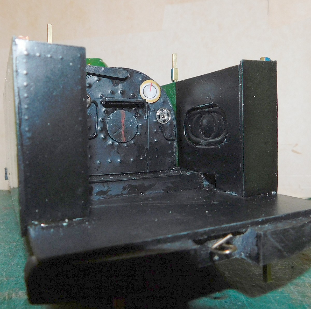

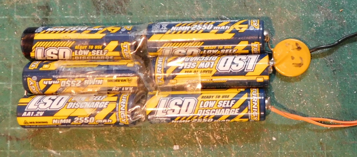

I had a change of plans and put all 6 AA cells on one side tank and the other side will have the sound board and speaker. It will also need about 100g of lead in the other tank to even up the weight on each side. Makes the wiring easier. Receiver and speed controller are in the boiler.
Here’s a pic of all the electronics….
Rx + ESC + sound caption sml.jpg (389.24 KiB) Viewed 100728 times

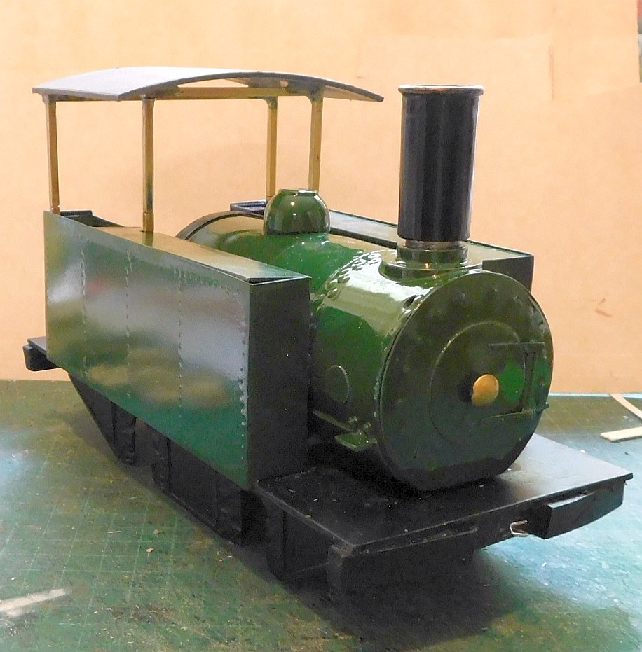

I painted the tanks separately and then glued them to the boiler/baseplate.
The speaker is a ‘ laptop’ type, 40mm x 20mm oval. I mounted it in the side tank facing into the cab. I have decided it will be a wood burner, so part of the side tanks will hold some wood.
I had a piece of curved plastic which was perfect for the cab roof. I made up a frame to support the it from 3mm brass tube.
cab complete.JPG (268.31 KiB) Viewed 100728 times
front mockup.JPG (197.39 KiB) Viewed 100728 times
So it’s getting close to finished. Just need to wire everything up and keep my fingers crossed that it works.

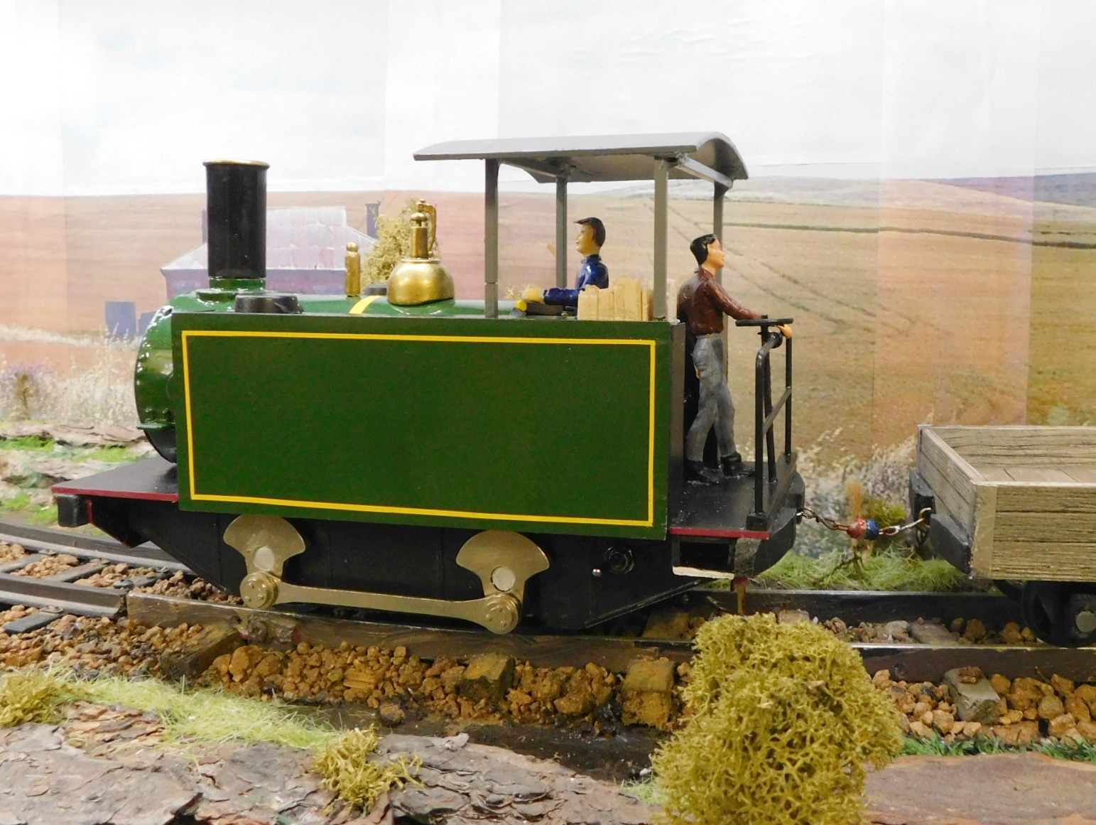

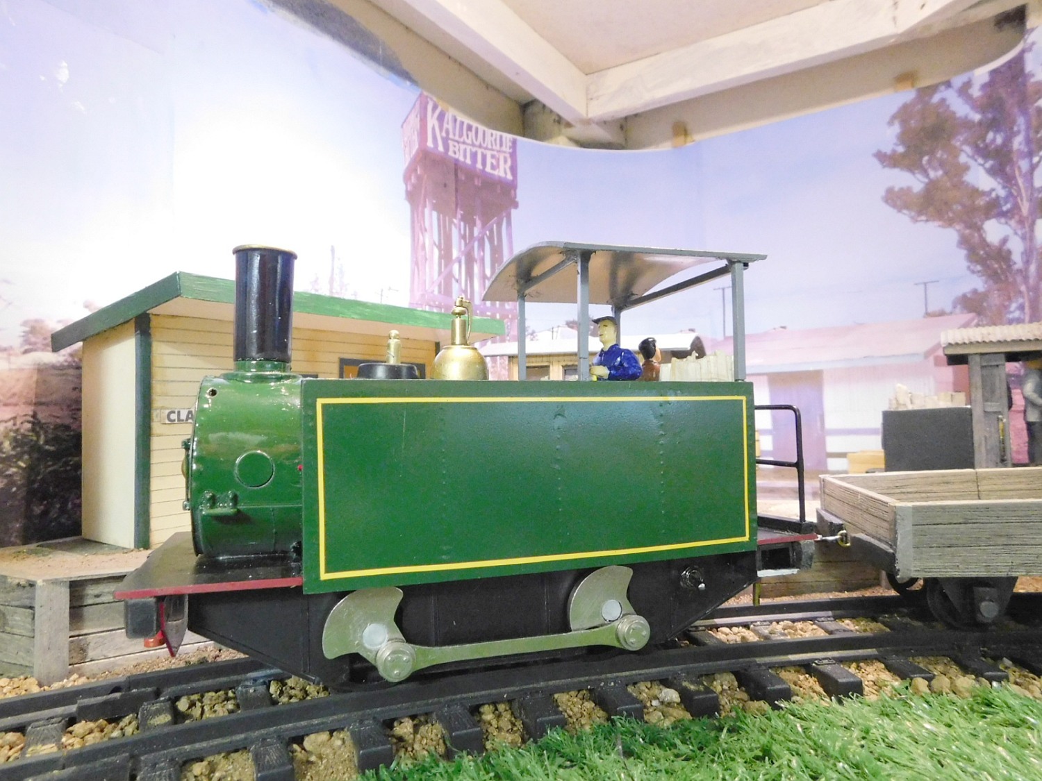

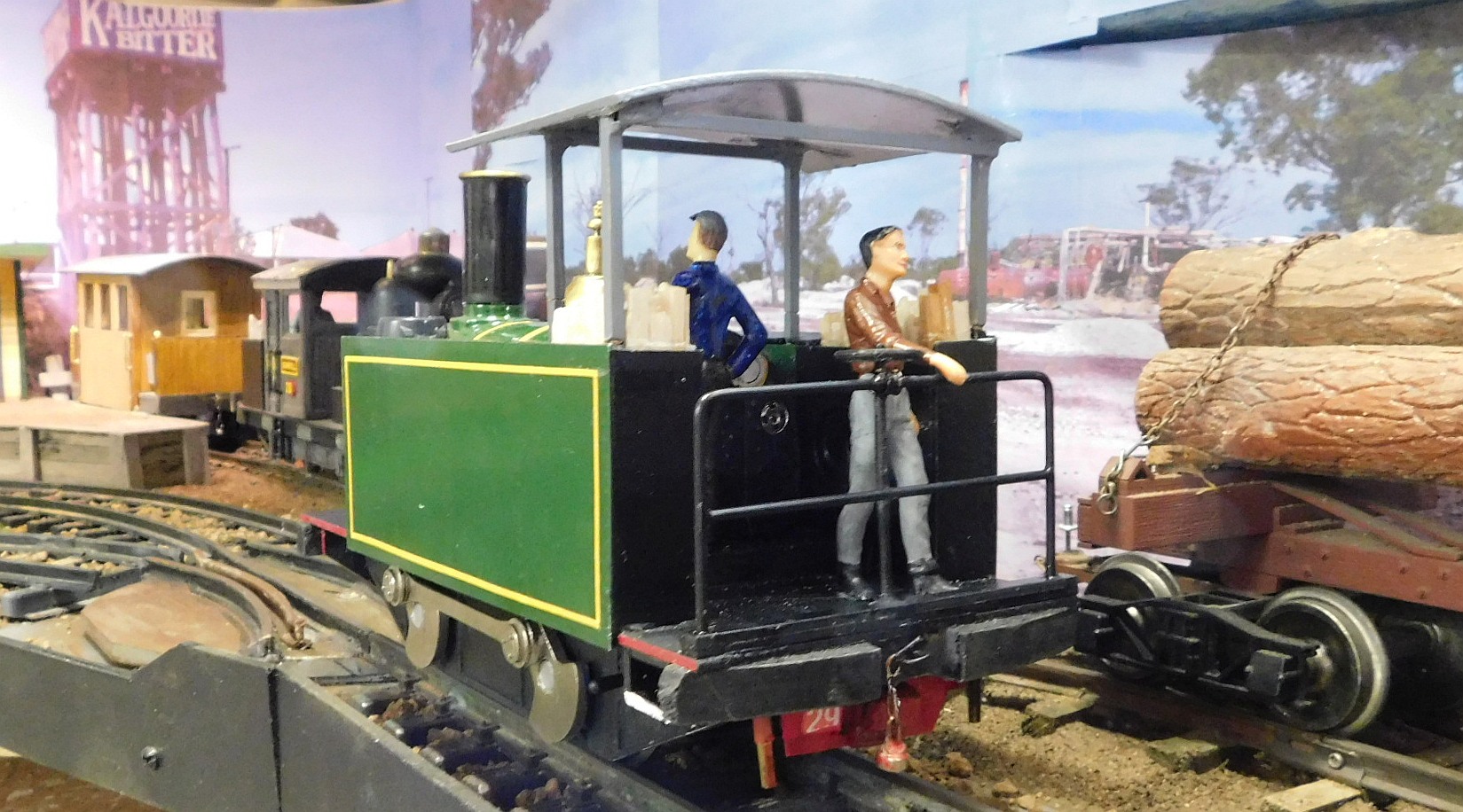

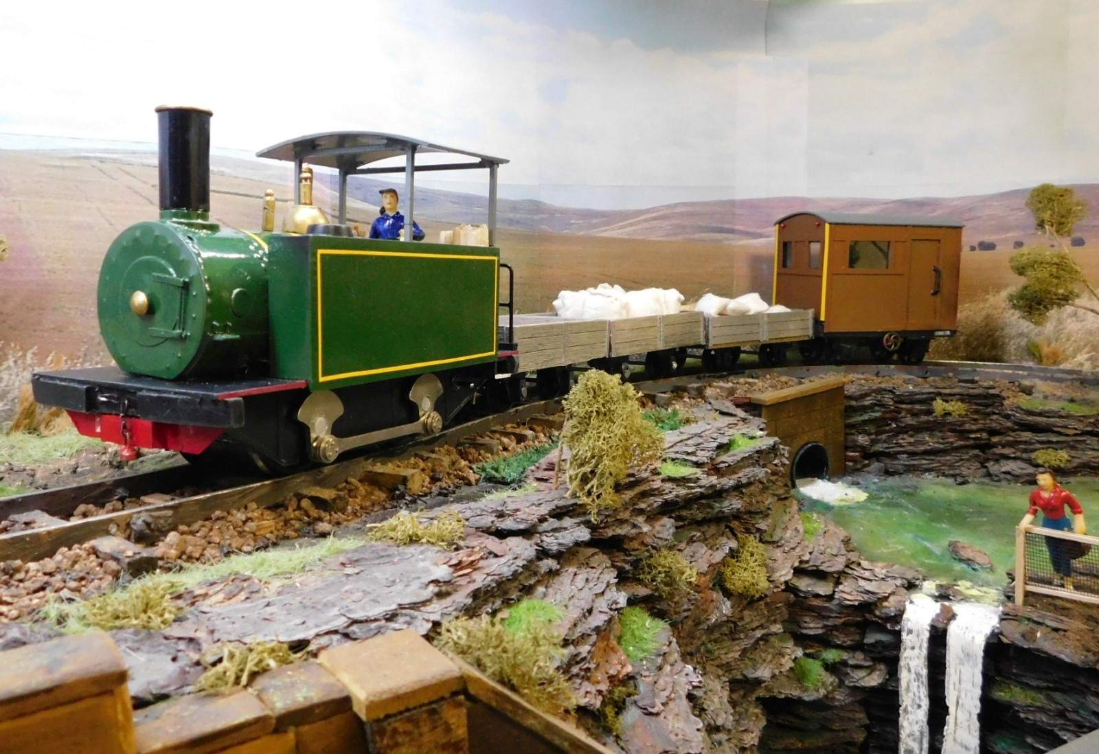

This loco is truly CURSED. After all the problems with getting everything cut, I finally have it almost complete. It just needs some numbers.
BUT as I took it for its first run outside, it stopped after 15 minutes. I finally have tracked it down to an intermittent fault in the Hobbyking transmitter. And there are none available in the store!
So I have temporarily bound it to another Tx.
It can now takes it’s place as number 29 on the Sandstone and Termite roster, as the 25th scratchbuilt loco.
So here’s a few pics on the indoor line

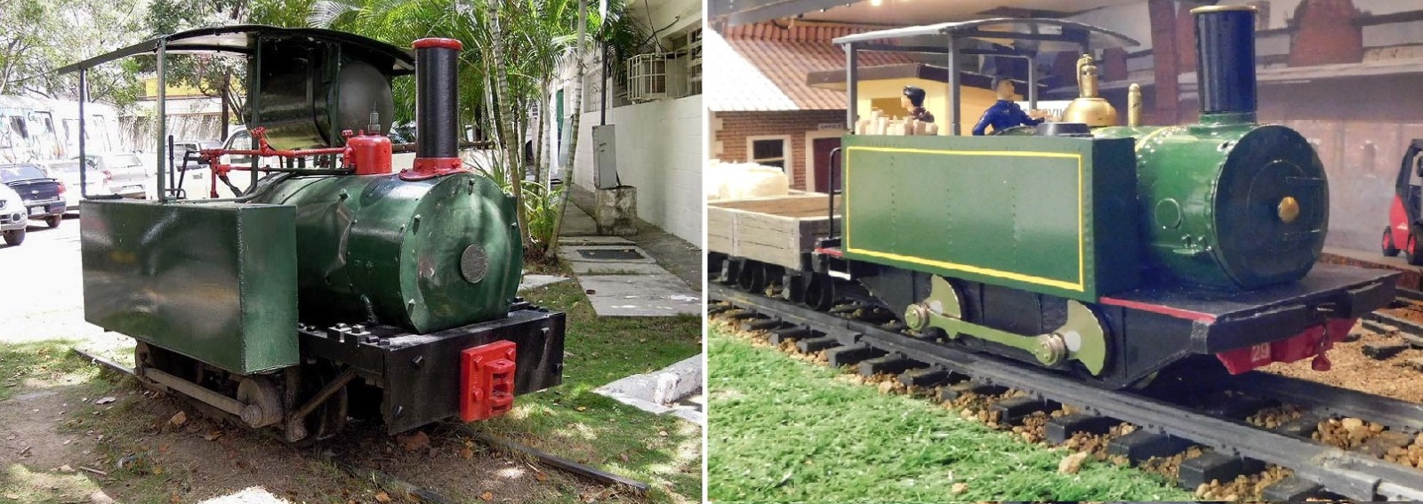

First a comparison of the prototype I used as a 'model' and my attempt.
real and model.jpg (305.24 KiB) Viewed 99709 times
No29 finished (1).JPG (413.16 KiB) Viewed 99709 times
No29 finished (2).JPG (395.31 KiB) Viewed 99709 times
No29 finished (3).JPG (382.82 KiB) Viewed 99709 times
No29 finished (4).JPG (400.01 KiB) Viewed 99709 times
and the video indoors and outdoors …
Greg from downunder.
