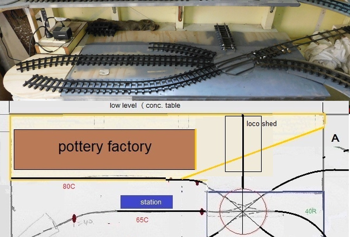

Lower station Area
I have decided that the upper level station will be called “Claymine” (because there is a clay pit there). And the lower station will be called “Pottsville” (because there is a pottery factory there !).
The Pottsville station area has virtually the same track layout as Claymine, with an engine shed added. Both have short passenger platforms, so a passenger service can be run, just to add interest to the 'clay train' workings.

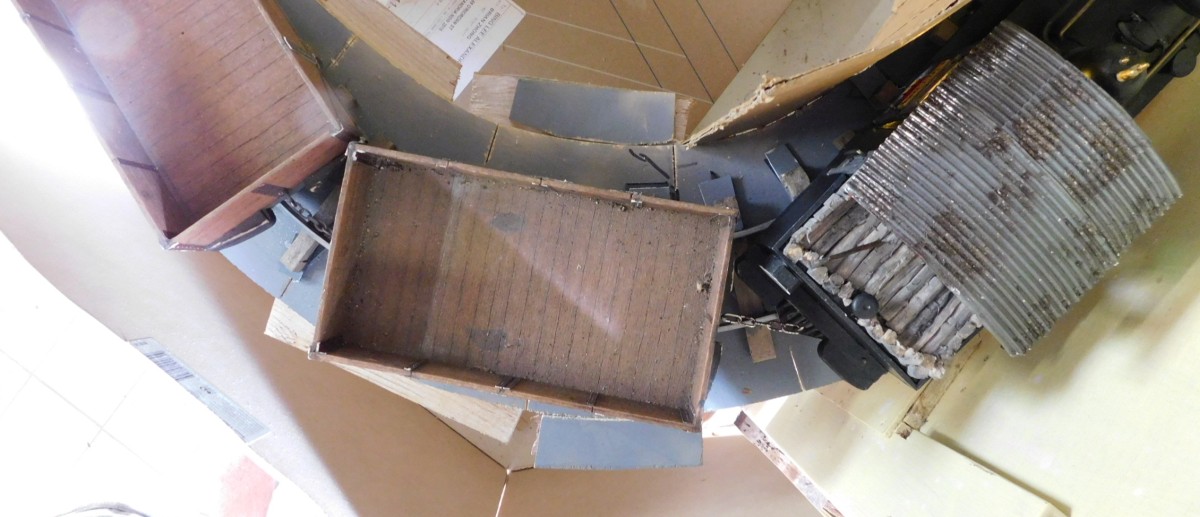

Now how is the clay transported from the mine? Shovelled onto small piles on flat wagons? In open wagons? Or in maybe in bags?

That operating session looked a lot of fun! I really like the little red brake van...
Don't know about on your side of the planet, but here clay travelled in "hoods", four wheel open wagons with tarpaulins over to keep the clay moist. What clay traffic is left goes in covered hoppers these days.

In Oz, my money would be on the clay being carried between pit and works in either V-skips, or US pattern wooden side tippers. Kilns need lots of fuel, so your railway will also need to carry in firewood and/or coal.gregh wrote: Sat Nov 19, 2022 9:07 am Now how is the clay transported from the mine? Shovelled onto small piles on flat wagons? In open wagons? Or in maybe in bags?
I doubt any Aust. pottery would have been big enough to need a railway to carry clay, unless it made bricks as well.
Both my grandfathers were brickmakers and one of the brick works also made pottery, but the brick works in that area didn't have tramways. The clay came from the clay pits some miles away by road, originally in horse drawn drays, in later years it went by road truck.

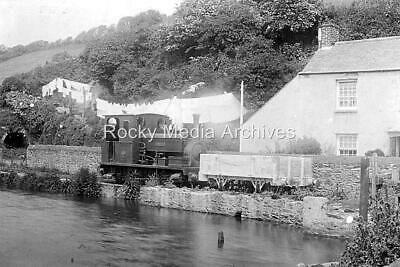

The Pentewan Railway in Cornwall used to transport China clay in open wagons. They then offloaded them into ships on elevated trestles.
Re: A tiny G gauge indoor layout
I'd forgotten about the Pentewan Railway! And that the "hoods" were for transporting clay over hundreds of miles, not along a short industrial branch line - you're right, I reckon skips, tubs or uncovered opens are much more likely...

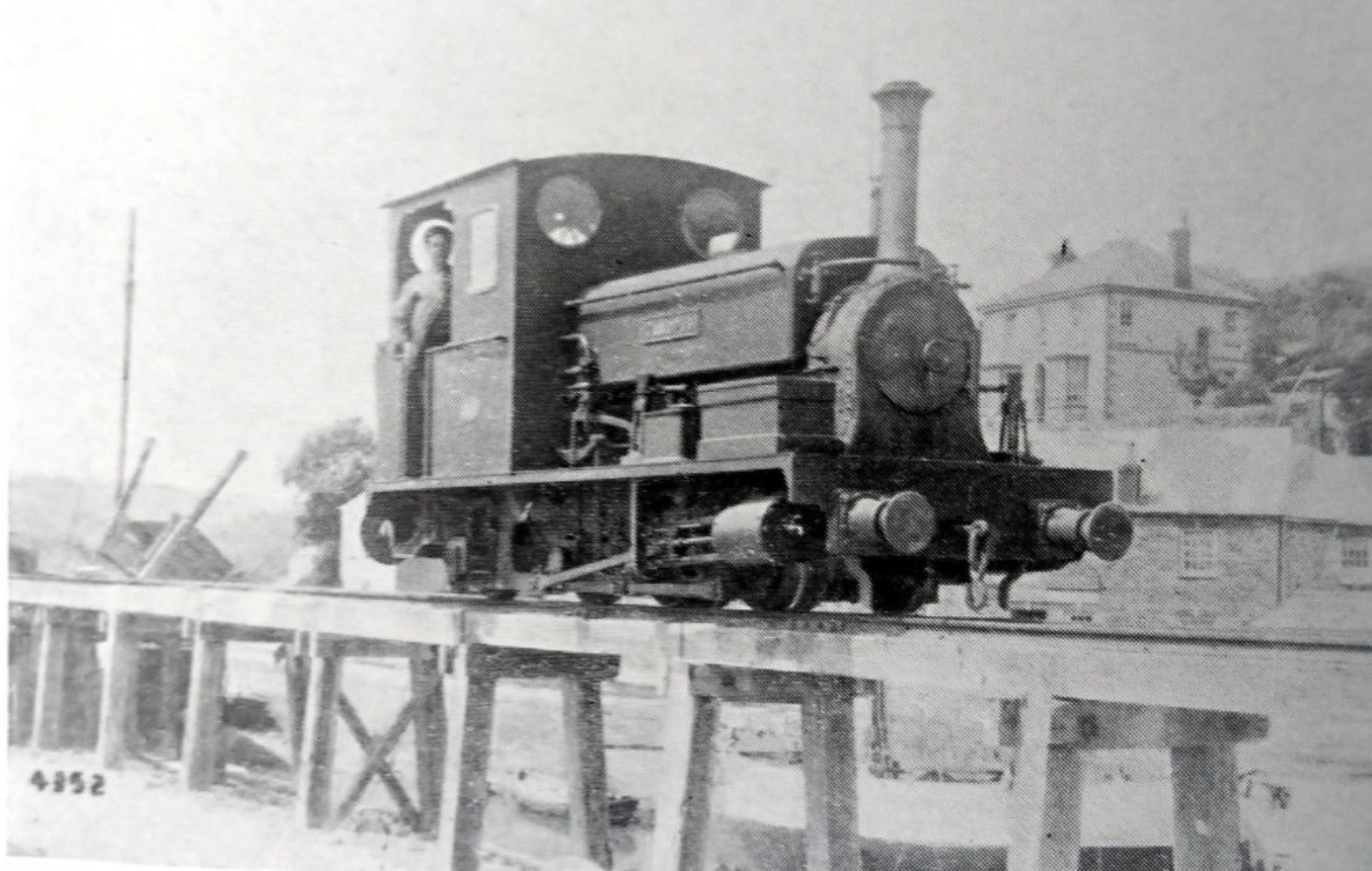

- Posts: 7978
The railway in that video is fascinating. The trestle looks very impressive for such a niche railway

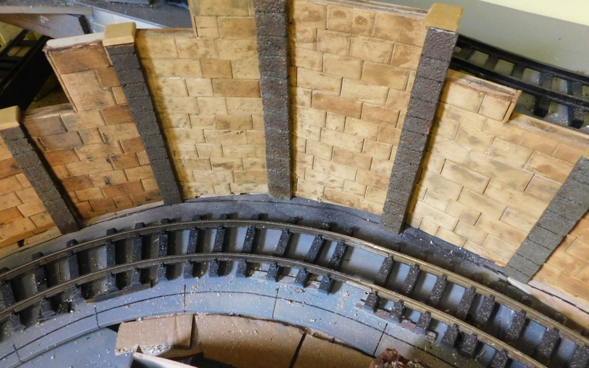

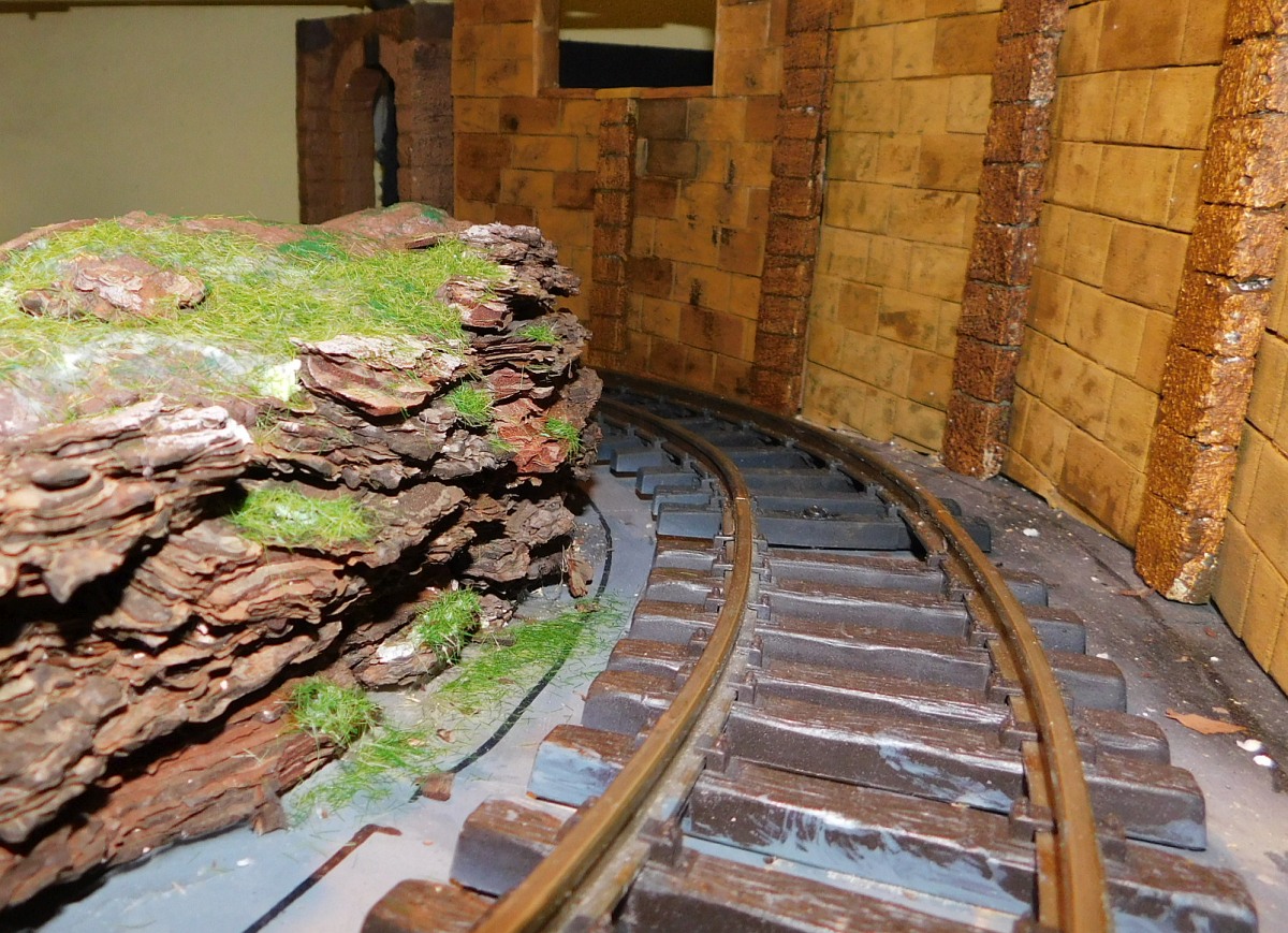

Having completed track laying, it's time to actually build some scenery. Maybe this is not the forum for this as it is no longer a garden railway, but I'll continue the progress update.
I needed a 10" high vertical wall at one location, so following Rik's blog of how he built his viaduct from individual balsa blocks, I used his method. I used big 'sandstone' blocks 20mm high and cut varying lengths from 20 to 60mm, then started gluing onto plywood. Here's the final Great Wall of Balsa. The other side of the track called for a rock cutting so I wandered down my backyard to the big pine tree and chiselled some bark of it. Then the tedious job of gluing layers on top of one another began. But it has worked out well (to my eyes anyhow).
I'm not sure I'll use the pine bark method much more as it is very slow, waiting for the glue to dry. But I do have an infinite supply of bark!
I have now tried first gluing the bark to a piece of thin black cardboard, on the bench - much easier.
I filled in behind the bark with plaster of paris, coloured brown with cement oxide.
Then the need for a 'grass' covering arose. Youtube has LOTS of videos on the use of the new (to me) static grass. To apply this you need a static applicator which you can buy for $100's or you can make one from a cheap 'Bug Zapper" thing. To cut a long story short, I built one and it didn't work! ($10 wasted!) So I just sprinkled the 'static grass' onto white PVA glue and pushed on with my fingers. So my grass all lies down! I'm going to try a rubber balloon static to see if it makes the grass stand up.
Here's a couple of pics of the results..
And this tunnel portal is carved styrofoam, covered with thin plaster. (internal walls not done yet) Now I am still looking for non-clumping, no-odour cat litter so I can ballast the track.

That is looking good, Greg. The pine bark is remarkably effective as a rock face.

The cutting made from pine bark looks good. How did you remove the resident wildlife in the bark? The pines around here are full of all sorts of creepy-crawlies.......

Love the shots of the loco creeping round the bends, and those tight clearances...
