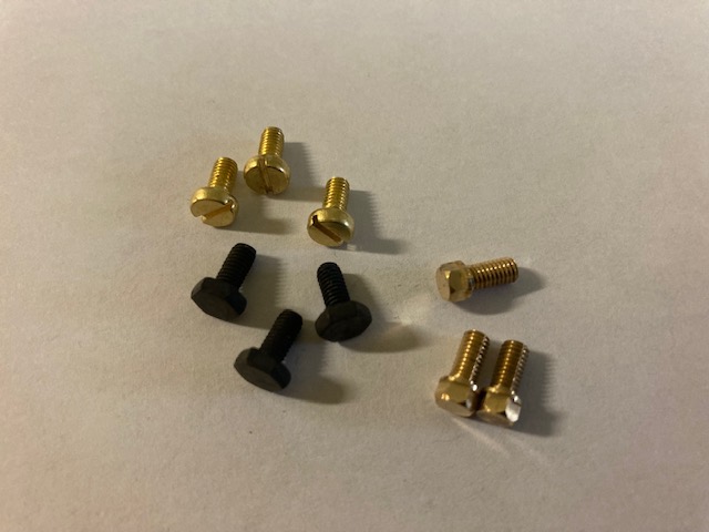

I did order some little hex head bolts (the ones in the photo are M2) which I plan to use instead of the Roundhouse cheesehead ones. And I couldn't get any cleanser without bleach locally, so I ended up ordering this 3m cleaner which has now arrived.

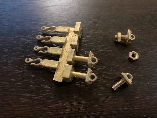

I had also purchased some decorative safety chains from SwiftSixteen. The instructions call for them to be soldered or glued in place. However. the stem of the casting looked quite close to being suitable for cutting a M3 thread, so I gave it a go and it seems to have worked. I will try to use these instead of the M3 bolts that came with the kit, to bolt the buffers and buffer beam overlays on.
Re: Newcomer Roundhouse Billy Build
Posted: Mon May 23, 2022 5:32 pm
by Old Man Aaron
Ingenious way of fitting those chain mounts. :salute:

The black M3 hex bolts that I ordered have also arrived. The M3 slotted head bolts in the photo are the ones supplied by Roundhouse for the frames and the black hex head bolts are the ones that I will be using. The heads are a little large but they should be ok. The smaller, brass, hex head bolts are the ones supplied by Roundhouse as an optional extra and I believe that these may be the ones that they use on the buffer beams of the factory-built models.
