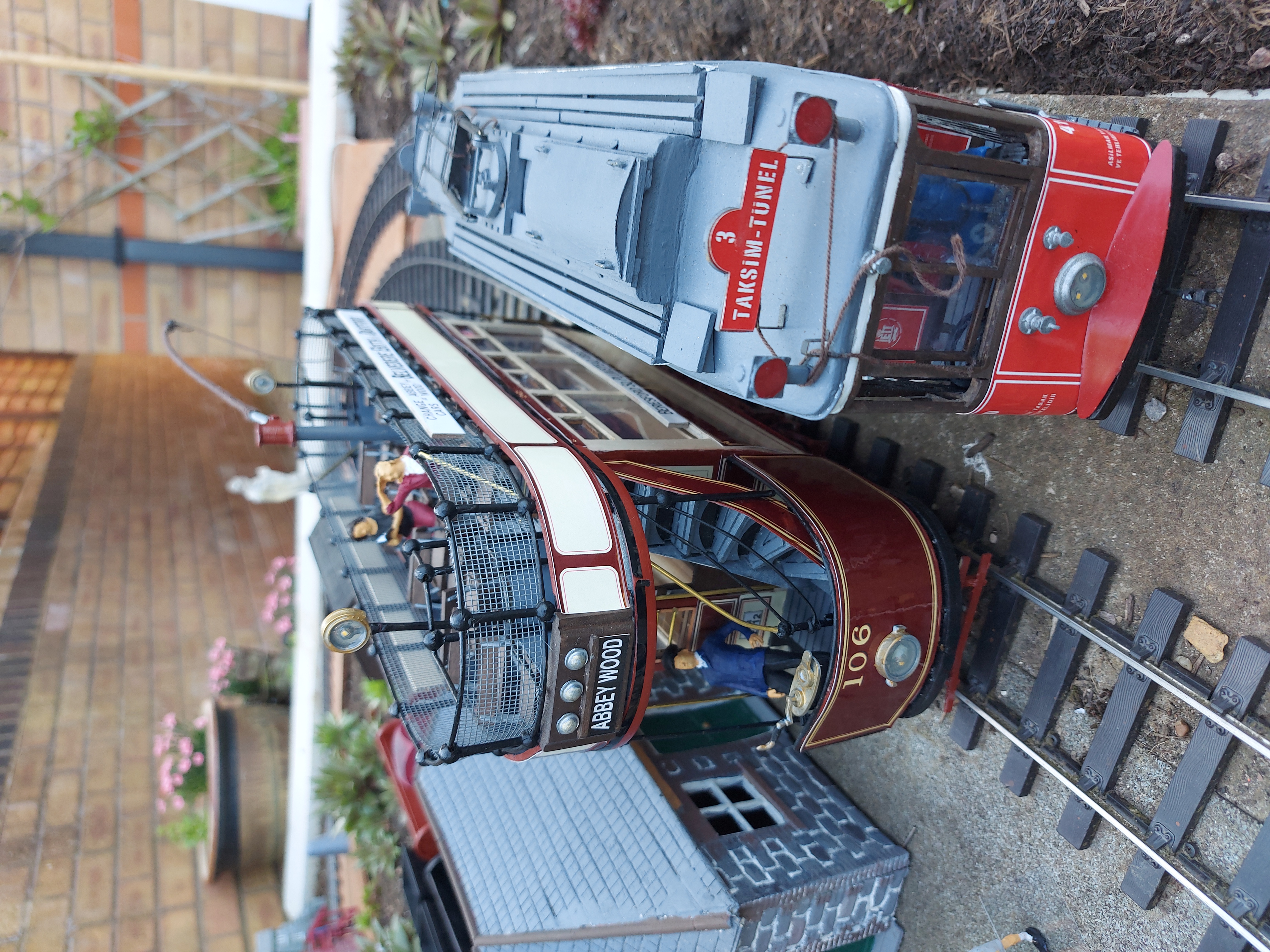

It looks like your plans are quite similar to what I've built. I also have some Occre trams, all fitted with a single Appletree motor gearbox apiece, as I don't tow trailers, and grades are reasonably flat. My other interest is narrow gauge, hence the Ffestiniog stock and Welsh station building.
I used Cliff Barker gauge 1 stainless track, which is gauge widened, and makes sharper curves more easily negotiated by the trams. He also sells individual components including rail chairs and check rail fittings, all in ABS, so making up points and crossovers is reasonably simple. I made all my points up using some old 32mm coarse scale points I was given, rebuilding them to 45mm using Cliff Barker parts. They are driven by servos in 3d printed enclosures, and seem to work very well. A couple of pictures below.
