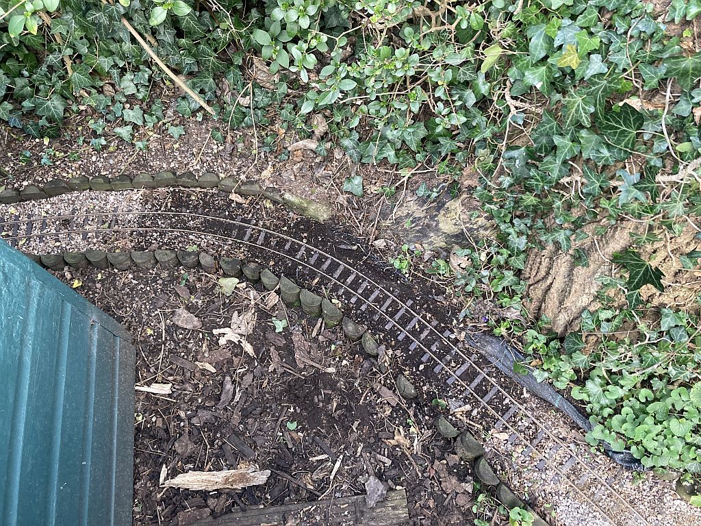

More about the track realignment. As the railway and the range of motive power I have acquired has developed its has become apparent that here and there some changes could be made to facilitate easier running, particularly for manual control steam engines.
The first change I've made is where the line runs behind the smaller shed by the hedge. The last part of the curve is perhaps a little too tight and there is a little bit of a gradient as well which doesn't help. Also it is right next to a large tree trunk and the slow growth of it over the last 6 or 7 years since I first laid the track has reduced clearance, so it really needed improving. This section of line also seems prone to having animals digging, pecking etc and the ballast keeps getting covered in debris from that and leaves and twigs.

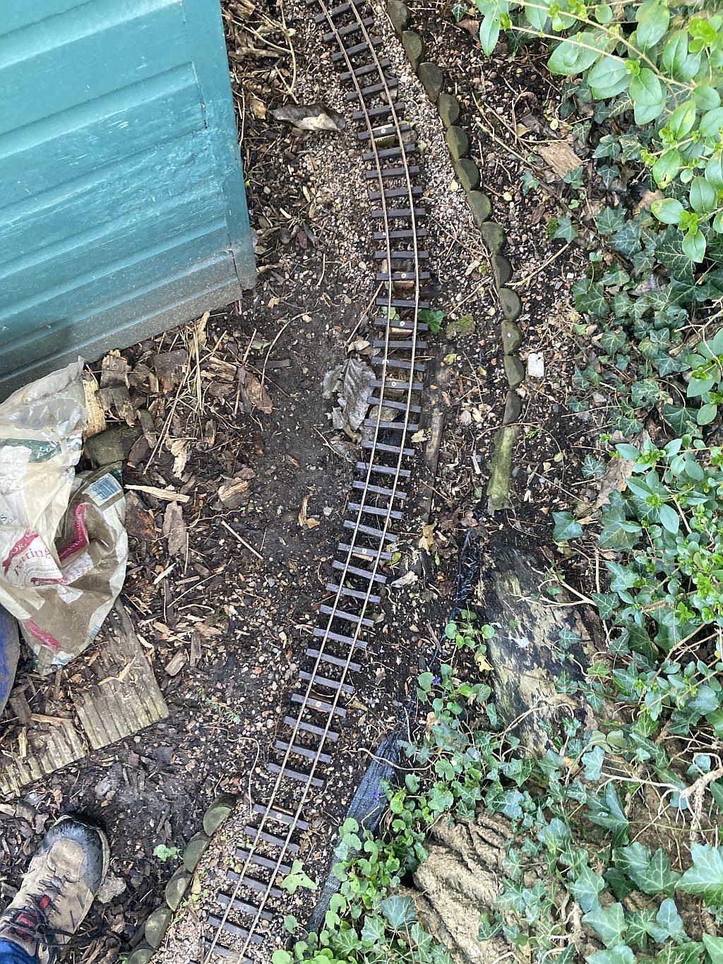

So I've slewed the track slightly, so the curve blends more into the straight section. this has allowed an increased radius in the tighter part of the curve.

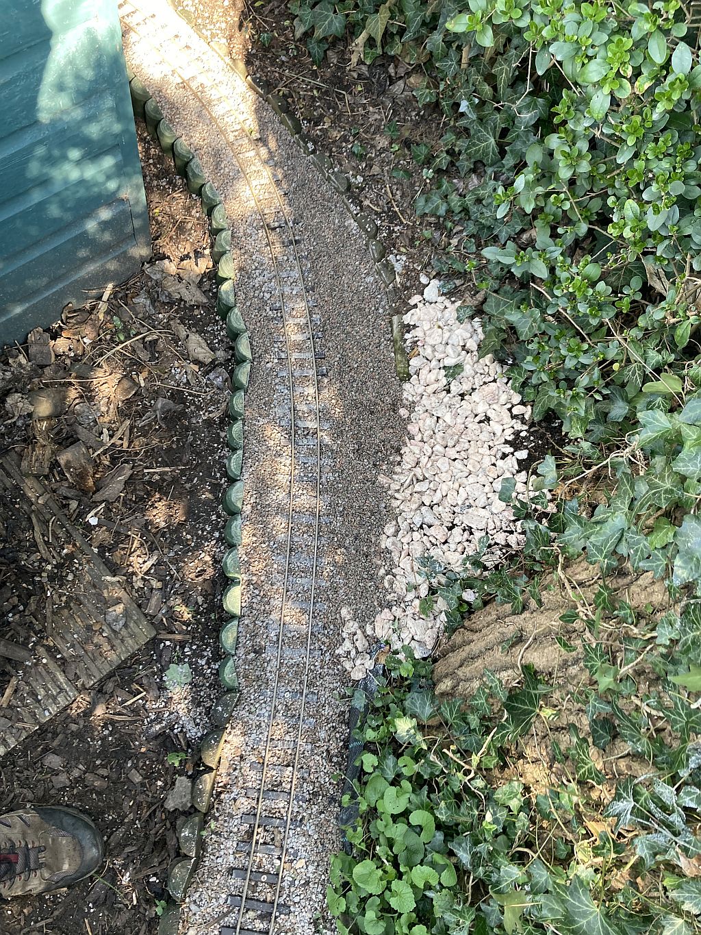

Once I had the track in place, i was able to carefully adjust the levels before final ballasting.
It looks a lot better, and so far seems to be easing the passage of trains (although I've only run a small number of trains on it yet!). I suspect I won't solve the issue of debris accumulating as this corner is a trap for anything like that.

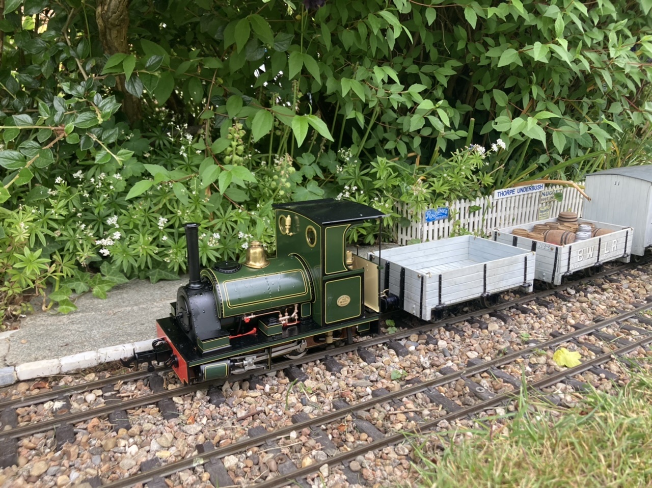

I’ve also made an impulse purchase of a new steam loco. When I say “impulse” I had been considering it for a while and trying desperately to resist…
It’s an Accucraft Cranmore Peckett.
As you will know, I have a Lilla and you might get the impression that I’m a sucker for cute saddle tanks (you’d be right! :lol: )
I love Pecketts and this is diminutive it makes Lilla look big! Now I had some misgivings about buying one as it’s manual and my experience with manual locos on my line is that they need to be followed round the garden to adjust the regulator, which can be a pain. Also the cab is small and open backed so fitting r/c without it looking obstrusive isn’t a simple task.
So it arrived and after finding it a tad temperamental at first to get steaming (the safety valve seemed to be bit sticky- something noted in at least one review of the loco, which suggests mine wasn’t a one off) it was time to see how it stretched it’s legs on a run round the garden. I couldn’t actually believe my eyes, as this pretty little engine picked its way round my rather curvy railway through the tightest radius bends and up the 1 in 38 without stopping and at a lovely leisurely pace. In fact once you find the perfect regulator setting it will do several circuits with a decent train of a few wagons without me having to even touch it even once… 8) occasionally it will slow to stop on a tight section only to pause a few seconds and then chug off. I can only recommend these sweet little locos especially if you have a line with small radius curves and gradients, it has tiny wheels and a very short wheelbase which is probably a big part of the reason for this performance.

Like the new Cranmore Peckett, it does look very nice. I myself would however prefer r/c model, mainly because whatever line I have built it never seems to come out level no matter what I do.. :lol: :lol:

That is a lovely looking little loco. Any chance of some video?
