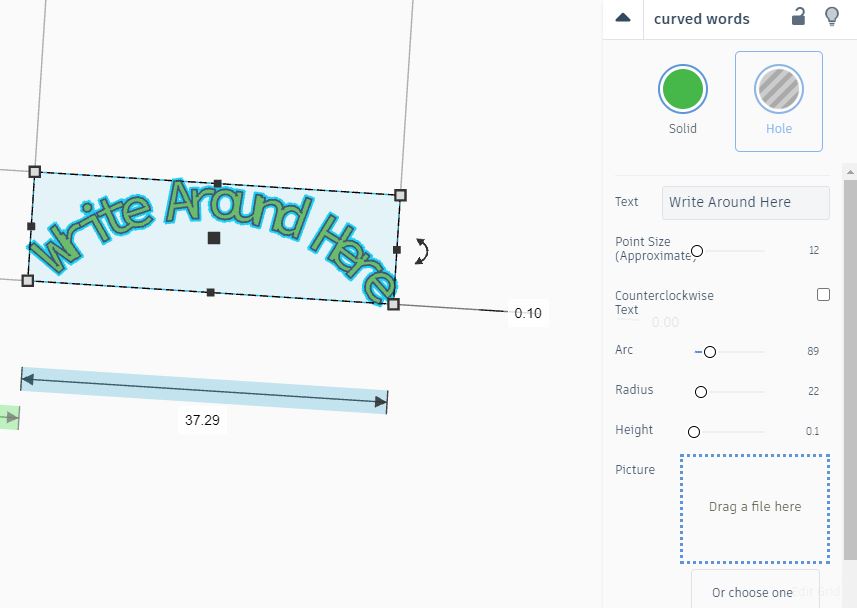

In Tinkercad for curved words I just use this, it's built in and simple to use.

-steves- wrote: Sat Jan 01, 2022 4:05 pm In Tinkercad for curved words I just use this, it's built in and simple to use.
Well that could have saved me a lot of work! (Although I'd have learned a lot less...) I looked for something like that - and couldn't find it - and indeed I still can't find it!

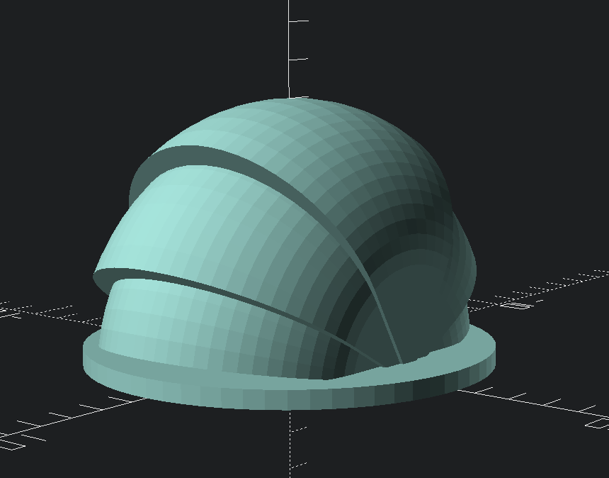

Let's come back to this:
-steves- wrote: Sun Jan 02, 2022 9:36 am The dome looks fantastic, however it's only good for a flat boiler. The dome for a round boiler needs the flare to change inline with the size of the curve of the boiler.
If you can do the code for that, it would be extremely useful, especially for those of us who struggle with any type of programming :thumbup:
Mastering OpenSCAD, excellent though it is, keeps teaching me new things that I think might be helpful with this... and then they turn out not to be. Mind you, I'm only 6 chapters in. Still an impatient corner of my brain wants to find a solution already, and I've started wondering if my approach isn't running against the grain of what OpenSCAD is good at. I've been thinking of transforming the 3D mesh, using some kind of fillet, a bit like Metalmuncher demonstrated in Fusion 360. But it seems to me the strength of OpenSCAD is being able to create a piece of geometry and then reuse it - with different parameters as needed.
So I started thinking about creating the flare in segments, changing the geometry each time to fit the boiler. E.g. take the 2D shape and just extrude it through a few degrees, then change it and extrude a few more. Making it smooth is then just a question of adding in enough steps. Steps can be a parameter so you can choose however many you want before you render.
This shows how it looks with a deliberate low number of steps (36) so you can see the changes.
With 360 steps it looks a lot more smooth. It does take an awfully long time to render. ~40 minutes on my ageing Intel MacBook Pro. So much for not being computationally intensive. :roll: There's bound to still be a much better way to do this.
Here's the code - the parameters are the number of steps, the width of the actual flare, the full radius of the dome/chimney (to the outer edge of the flare), and the radius of the boiler it will sit on.
Code: Select all

This is just a proof of concept. I haven't given any thought to how to print it - but probably the best way would be to add this code to the boiler and chimney/dome and print them as one piece. Failing that it would need some sort of collar to strengthen the edges, I'd think.

Wow! That looks excellent!! Even with the rendering time, it's a lot better than I could achieve with TinkerCAD.

ge_rik wrote: Sun Jan 02, 2022 5:35 pm Wow! That looks excellent!! Even with the rendering time, it's a lot better than I could achieve with TinkerCAD.
I also have an old (7 years old and not high spec) laptop and it took less than 10 mins to render, so no issues there, it gives a great finish and easy to change, liking it so far :D

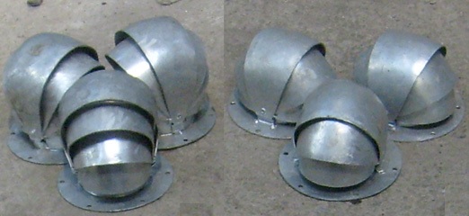

Simon
How would you go about something like this? I can't even think of where to start, even in Tinkercad :(
I have had success with your domes and flares. I can now print any dome I like with minimal changes, I can't thank you enough for that :thumbup:

Post by metalmuncher » Wed Jan 05, 2022 6:48 pm
-steves- wrote: Wed Jan 05, 2022 1:28 pm Simon
I've had a bit of a go a that one. Just three "orange segment" shapes stuck together.
Not quite perfectly proportioned, maybe a bit of unequal scaling of the shells would make it better. I also didn't bother making the shells thin, depending on print scale such thin structures might not be easily printable, but the thin wall could be added relatively easily.
Code: Select all
$fn=64;
module ShellShape(width, straightlen, angle){
    rotate([90,90+angle/2,0])
        rotate_extrude(angle=angle)
            translate([-straightlen,-0,0])
                union(){
                    translate([0,-width/2,0])
                        square([straightlen,width]);
                    difference(){
                        circle(d=width);
                            square([width/2,width]);
union(){
    cylinder(d=11, h=0.5);
    ShellShape(8  ,3  ,60);
    ShellShape(7.8,2.5,120);
    ShellShape(7.4,2  ,160);

-steves- wrote: Wed Jan 05, 2022 1:28 pm I have had success with your domes and flares. I can now print any dome I like with minimal changes, I can't thank you enough for that :thumbup:
Excellent! I'm still finding OpenSCAD fascinating, and enjoying the new uses it can be put to...
metalmuncher wrote: Wed Jan 05, 2022 6:48 pm
-steves- wrote: Wed Jan 05, 2022 1:28 pm How would you go about something like this? I can't even think of where to start, even in Tinkercad :(
Oh wow, this is great. I just stared at Steve's pics and scratched my head.
One thing I noticed is that the pivot point in the shells is not at the absolute tip of the 'segments'. So I had a fiddle adding in bluntness factor. I don't think it's helped much, it's made it more complicated and made the model worse at the same time! I had to add in a factor to make sure it disproportionately affected the 'top' shell since 'blunting' the shells with very large angles doesn't make much sense. Having looked up Ash's Patent Carriage Ventilators (I wasn't familiar with them) it looks to me like it's necessary to model the inner shells in two parts, bringing them closer together along the x-axis to give that almost parabolic cross-section in the x-z plane. But I'm too tired to do any more fiddling tonight!
Code: Select all
topShellAngle = 50; // [20:5:80]
secondShellAngle = 110;  // [80:5:140]
thirdShellangle = 160;   // [140:5:180]
bluntness = 0; // [0:0.5:5]
// Decrements in the radius of each shell
redrad = 0.2; // [0.1:0.1:0.5]
angles = [topShellAngle,secondShellAngle,thirdShellangle,180];
module ShellShape(width, straightlen, angle, bluntness){
    pf=bluntness*pow((1-angle/180),2);
    difference() {
        translate([0,0,-pf])
                    translate([-straightlen-pf,-0,0])
                        union(){
                                square([straightlen+pf,width]);
                            difference(){
                                circle(d=width);
            translate([-straightlen-pf-width/2-1,-width/2-1,-pf])
                cube([2*(straightlen+pf)+width+2,width+2,pf]);
union(){
    for (i=[0:3]) {
        ShellShape(8-redrad*i,3-0.5*i,angles[i],bluntness);
$fn=64;
-steves-
Posts: 2473
Re: Using OpenSCAD to produce drawings for 3D Printing

How do you guys do this? I must admit I tried reading through the code to see how to make it bigger / smaller and I just don't have a clue, completely lost me on this one, but very well done :thumbup:
Posts: 6069
Post by philipy » Thu Jan 06, 2022 9:15 am
-steves- wrote: Thu Jan 06, 2022 9:10 am OMG! 8)
Glad it's not just me. :oops: :shock:
I think I could see how to do this in Sketchup. I'd have a go but I'm a bit tied up with the contractors loco atm.
