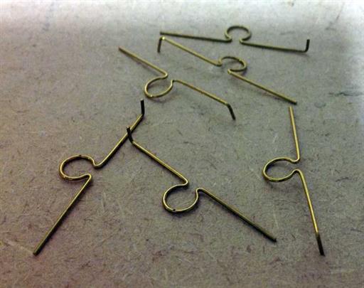

The problem with omega loops, is in the garden, they rust quite quickly..
I have wondered if link, possibly with the pins included, could be 3D printed, and include an omega loop in the print?
I guess the choice of filament material, would be key to this being possible?

Phil.P wrote: Fri Mar 12, 2021 1:25 pm The problem with omega loops, is in the garden, they rust quite quickly..
I always used brass ones :)

I've also used brass ones in the garden on manual points, but I think the tension/pressure balance could be a problem with servos. On my fairly short working rodding runs there is sufficient flex in the brass rods to allow some push pull flexibilty.
I'm not sure that the standard ABS would be man enough for printed omega loops of a sensible size, and PLA would be too rigid. I guess that Nylon or PetG filament might work but I've no experience of them myself. These days there are other more exotic materials but no idea what.
I do have PLA 3D printed angle cranks in my rodding runs and they seem to be OK.

What are Omega Loops?
Omega is a letter in the greek alphabet and is the traditional symbol for electrical Resistance, although commonly an upper case R is used now since that is available on the keyboard.
An omega loop uses the same basic shape formed in wire, and because of its shape it acts as a kind of spring since it is flexible enough to expand or contract by a small amount in a lateral direction.

I am very familiar with omega (ohm) as a measure of resistance but had never heard of an omega loop

I'm just a simple electrical engineer and don't have a great grasp of mechanics. Can someone explain how using a spring between the servo and the throwbar will reduce the force on the points blades when they are pushed against the fixed rail?
Maybe the idea of a spring is relevant if the driving force is not a servo, but say a a solenoid, that can be pushed 'back' by the spring when the moving rail hits the fixed rail, thus removing/reducing the force?
Now what if a SERVO is driving a spring between the servo and throwbar? As the servo starts to move it will compress the spring until the throwbar moves. The spring then expands a little. Once the throwbar is right across to the fixed rail, and the servo keeps moving, the spring compresses. When the servo gets to the end of its 'commanded' position, the spring is still compressed.
So isn't the force pushing on the throwbar through the spring the same as the case with no spring?
Maybe one idea is to allow the whole turnout to move a little and not be fixed down.

Greg, I don't understand the full mechanics of the loop, but my understanding is:
1) it takes the shock out of solenoid activated points
2) where the solenoid throw is greater than the point throw, it prevents shunting the track
3) having a "slight" spring tension on the point rail helps hold the rail in place
These are the only ones I can remember, as I was introduced to these over 40 years ago, it maybe with modern technology they are no longer needed.

gregh wrote: Sun Mar 14, 2021 12:17 am I'm just a simple electrical engineer and don't have a great grasp of mechanics. Can someone explain how using a spring between the servo and the throwbar will reduce the force on the points blades when they are pushed against the fixed rail?
With a spring in the throwbar, the force on the point blade will be set by the strength of the spring and the amount of spring deflection. Which will depend on the difference between how far the point blades move and how far the throw bar moves. If the throwbar moves so far that the spring is closed up, then the force will be whatever the servo can apply.
The omega loop is just a simple spring that can be easily fabricated by the average modeller from a piece of wire, using a pair of pliers. It doesn't have to be omega shaped, a zig zag will do the same job. Whatever is used is there to provide some longitudinal flexibility in the throw rod.
An omega loop is also there to take up any minor mismatch between the point blade throw and the throw of whatever mechanism is used to move the point blades, whether it be a manual lever, a solenoid etc. They are easily adjusted with pliers during the final setup so the point blade is held against the stock rail at each end of the travel with just enough force to ensure it doesn't open when a wheel hits it from the facing direction.
Modern devices used in the small scales like Tortoise motors, etc. don't need them, as the sideways flexibility of the drive rod does the same thing. Omega loops aren't needed with Peco points either, as the built in over centre spring does the same job of holding the blades against the stock rail.
Omega loops were once commonly used in HO and other small scales in the days of H&M solenoids, etc. Not sure how you'd go about using an omega loop in the garden scales, as the point rods need to be fairly heavy and wouldn't provide enough flexibility to be much use, I would have thought.
My garden track turnouts use 1/16" brass rod for the rodding and I made the rodding and tie bars adjustable, in much the same way as a real VR ng turnout. The point levers I use lock when thrown, so I don't need any springing to hold the point blades closed.
The only r/c servos I use are in steam locos and I make those linkages adjustable. That could be done for turnouts as well and I've seen adjustable linkages available in my local r/c shop.
I hope that all makes sense.

GTB wrote: Sun Mar 14, 2021 11:48 am
Thanks for the long story, Graeme.
But surely it doesn't matter if the spring is 'closed up', which I'm assuming you mean is squashed as far as it will go.
If the spring is in any compression, won't the force still be as you state above?
