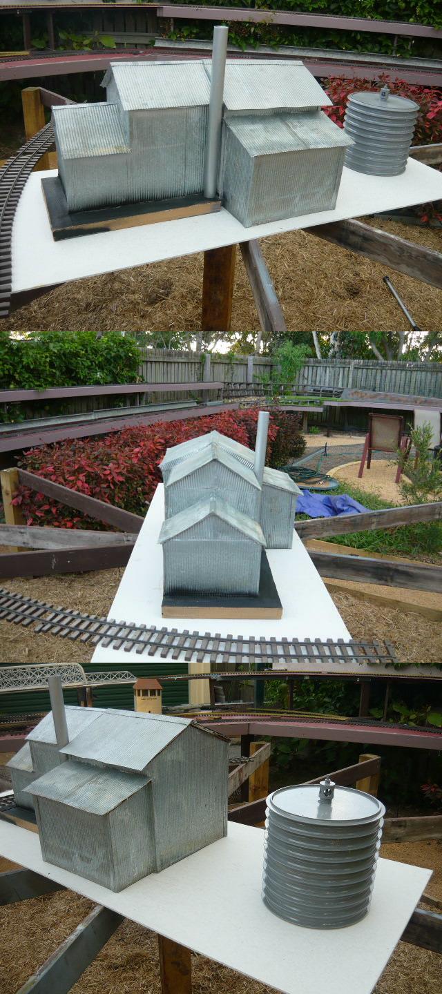

The sugar mill is progressing.
I was going to put in a rum distillery, as in what is just down the road a bit, that would use the molasses but have decided to an ethanol plant might make an interesting addition.
I am looking at putting the big tank, which will be the ethanol fermenter, on a separate board that can cover an access hatch.
I still have to make 'the tipper' building which will sit astride where the rail is and the 'carrier' conveyor that takes the cane into the mill.
I made the mill with no openings to keep the weather out as much as possible, might paint some windows on it later but looking at the mill down the road there are not many openings at all.

It certainly looks like it will be at home on a sugar cane plantation. I think there's a corrugated iron appreciation society in Australia....

That corrugated and galvanised iron is a real find. It's always satisfying when you find something that can be repurposed and look absolutely right.
It's a shame it's not available for 16mm modelling, I'm sure there would be a demand lfor it. And the mill looks 'the biz'. I can almost feel the relentless Aussie sun beating down on it.

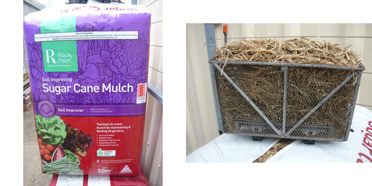

I have been looking for something to simulate cut sugar cane for my train of cane bins. Turns out I had the perfect material right under my nose, well underfoot any way.
Its Sugar Cane Mulch I use it to control weeds in my garden beds I but it by the bale at the garden shops.
I did not even use glue to hold it in place, it just packs down when the train is run and if I lose any I can always top the bin up.
This will come in handy when I am doing shunting for the mill as I can just empty the train bin contents into a bucket to get an empty to send back out to the farms.
Another upside is that it adds weight to the wagon.

I'm sure there's a word for that .... serendipitous, apposite, fortuitous .....
Or maybe - clever! ( with the R rolled ..... )

It looks very good and realistic, and could use similar in my cane wagons, I assume though it will need replacing every year.

No it should not need replacing if it is kept dry and with no contact with soils, I have had sugar cane mulch last for over 3 years lying on the ground.Jimmyb wrote: Wed May 05, 2021 7:58 am It looks very good and realistic, and could use similar in my cane wagons, I assume though it will need replacing every year.
For SWMBO's rose garden it is replaced on a yearly basis when they are pruned in winter, what I do is throw pelletised chook manure over the old stuff and refresh over the top with the new. The old stuff just rots into the ground hence the claim of it being a "soil improver".
I used raffia for my "whole stick" wagons.

The problem being, I would guess Sugar Cane Mulch, will not be that common in British Garden Centres?

You could use pea straw or any other straw that is available, just may have to shred it a bit with scissors.Phil.P wrote: Wed May 05, 2021 7:58 pm The problem being, I would guess Sugar Cane Mulch, will not be that common in British Garden Centres?

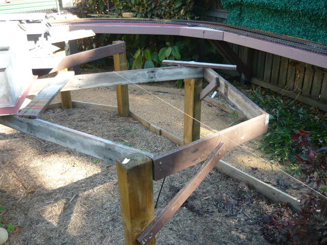

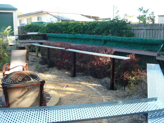

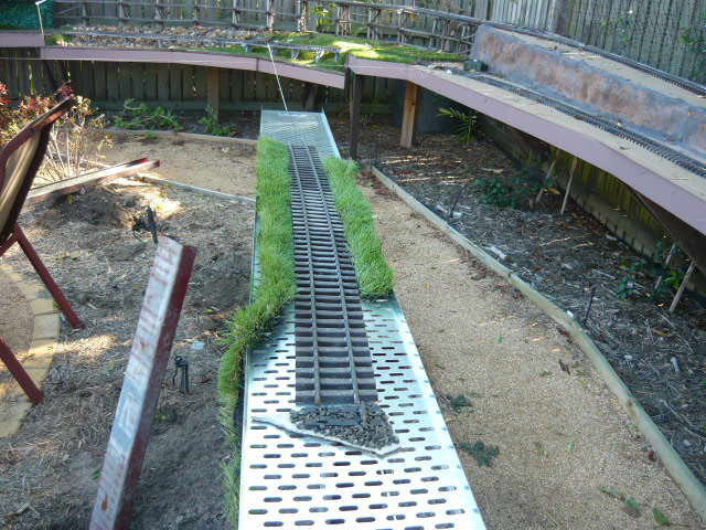

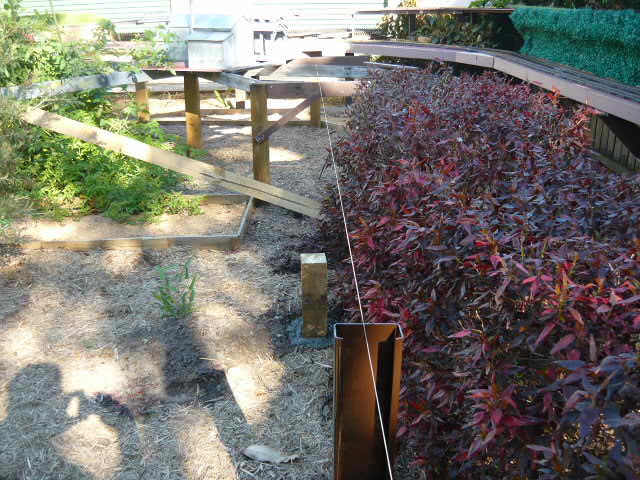

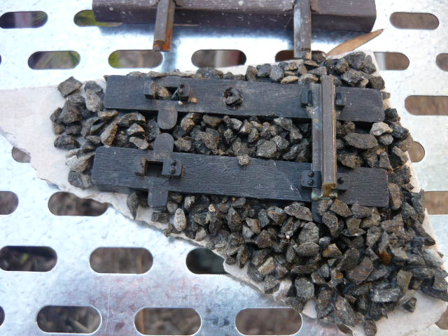

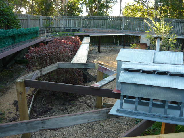

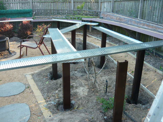

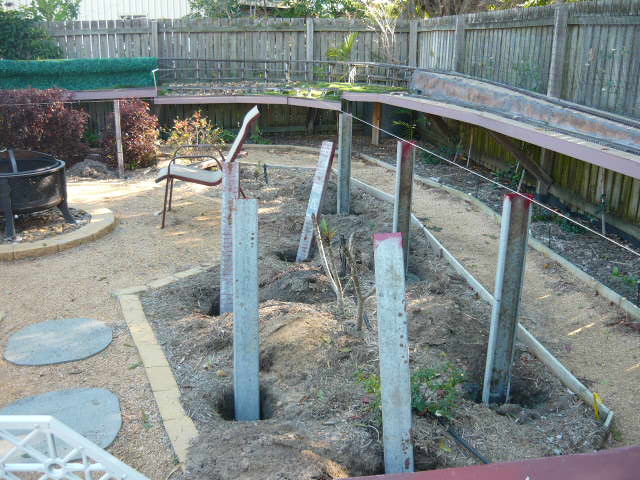

Bit of progress has been made on the line out to the farms (Geino's farm).
Posts have been concreted in (more to do).
The line will be supported using 225mm cable tray as a roadbed, a layer of weed mat or shaded mesh will be laid down and the track will be cable tied to the tray.
Either side of the track will be artificial turf with between the sleeper having 7mm metal gravel to simulate ballast.
I have some ballast on trial since April and it has stood up well to the climate.
Entry to the mill framework Looking along the hedge toward mill entry The farms area Tray, track, turf trial Ballast trial piece

Looking good Graeme. I wonder how long it will be before there is more railway than garden?
- GAP
- Posts: 894
Re: The Ringbalin "Cane Line"
This will about the limit, SWMBO has set a boundary over which I dare not cross.ge_rik wrote: Sat Oct 02, 2021 12:22 pm Looking good Graeme. I wonder how long it will be before there is more railway than garden?![]()
Plus I have run out of material (steel from old layout and timber from dismantled house deck) and have had to resort to spending money

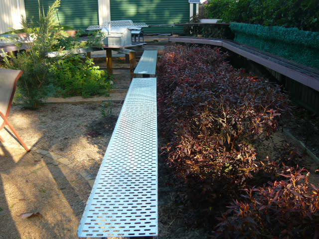

Some more progress made all the posts are in and its time to lay the cable tray.
