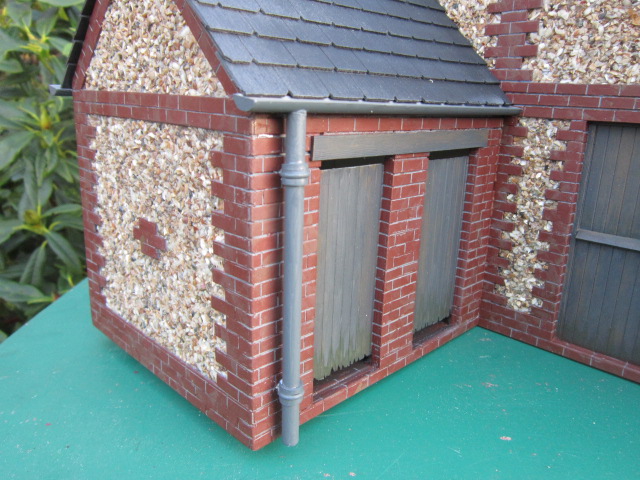

Looking good Aaron. I'm in awe of your patience doing the lettering by hand, and using picture hanger eyes as drain pipe brackets - what a great idea! That's something I always struggle with. Thanks for the tip :thumbup:

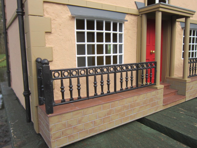

I have tracked down some pictures of down-pipes I fitted to my structures back in 2016 (mentioned on my Time to build a railway thread) where I described using picture screw-eyes with the addition of a small collar of plastic tube either side. This helps to make the 'bracket' more realistic.....

Funny you say that, Peter - I think that's where I got the idea. :study:
