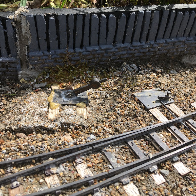

Having volunteered to have a "mini meeting" running session last week I felt a few modifications were needed. Firstly the points I laid last year had lost some of their springiness, the brass over centre springs were not holding the point blades firmly. So I replaced each one with a stainless steel "U" shaped spring made from 1mm diameter wire. The older points on the first section I built had been made before I worked out the benefit of an over centre spring, and I dismantled all those point levers and modified them:
You can see a clean brass plate sticking up to hold the fixed end of the spring , a shiny spring and an extra hole in the lever itself, in the photo above, which is the point leading into the engine shed.

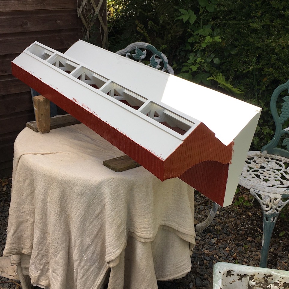

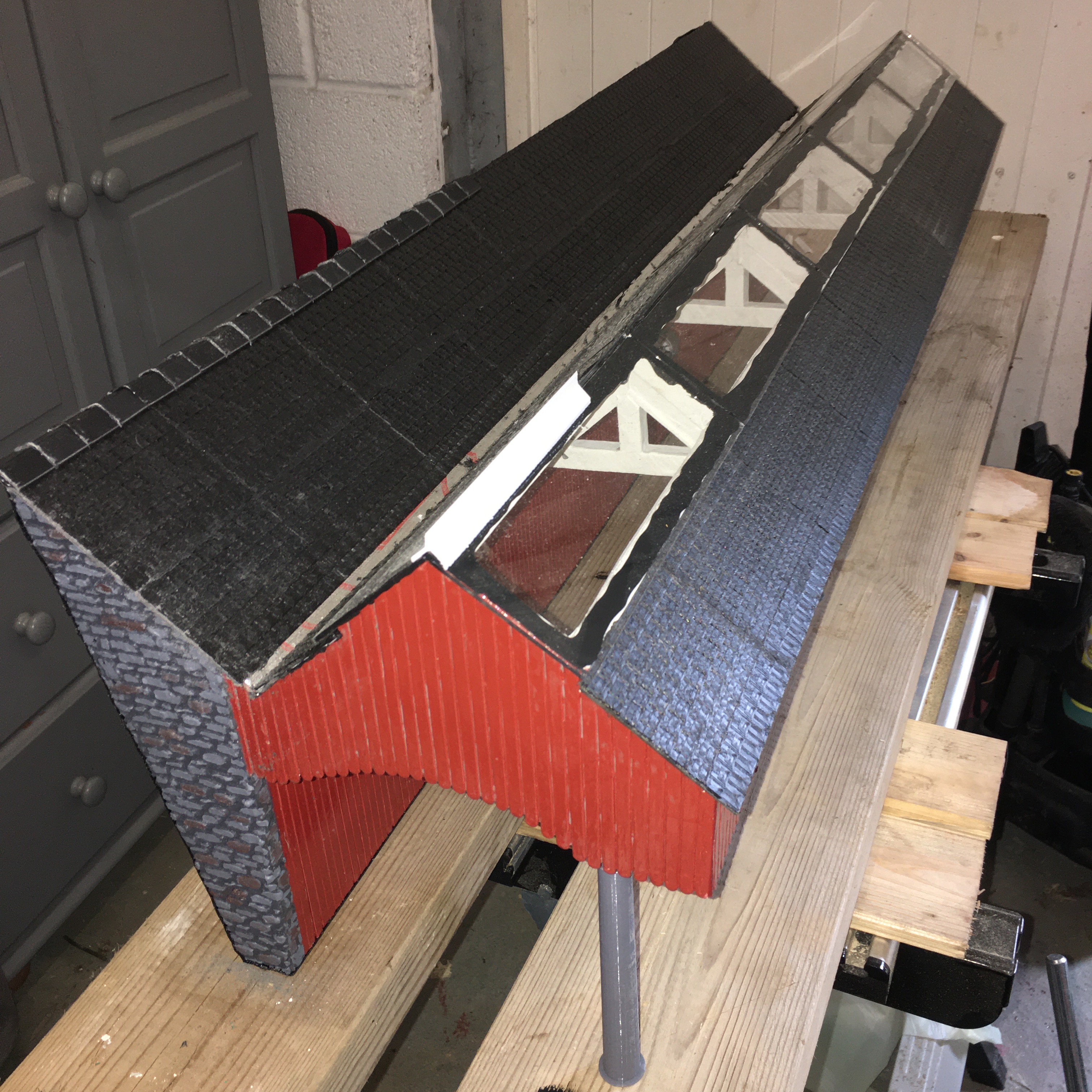

I have been working on the station building. The printed slate sections are all glued on, and 2mm thick perspex added to the top section. I have started to add printed ridge tiles over the glazed section and at the very back.
I am not sure that I have got the glazing right. I cant remember what I had intended to do when I started it - but I had intended to glaze it like this. It is the black adhesive I am dissatisfied with. Perhaps when I have added all the glazing bars set at 32mm centres along it it will draw the eye away from the black.

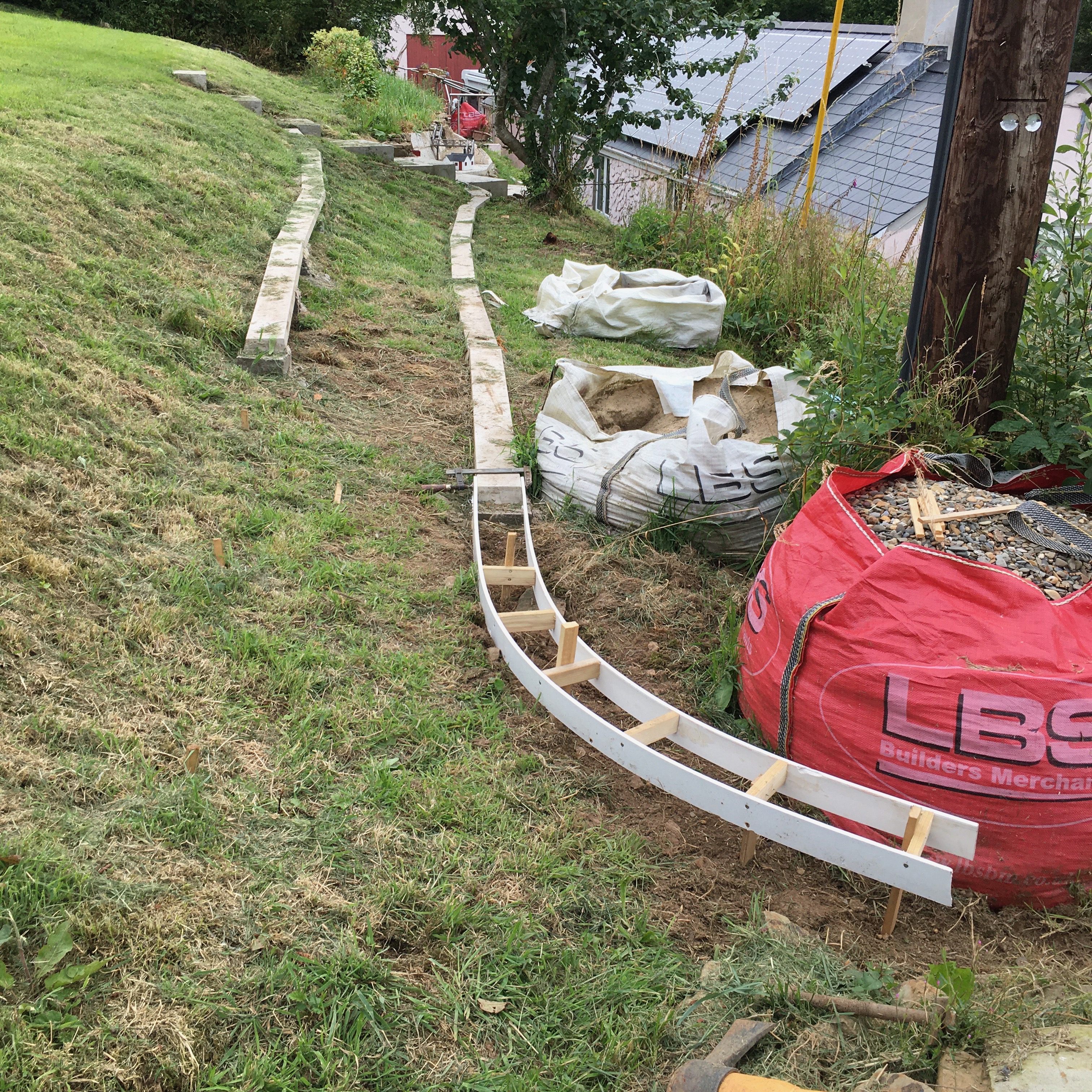

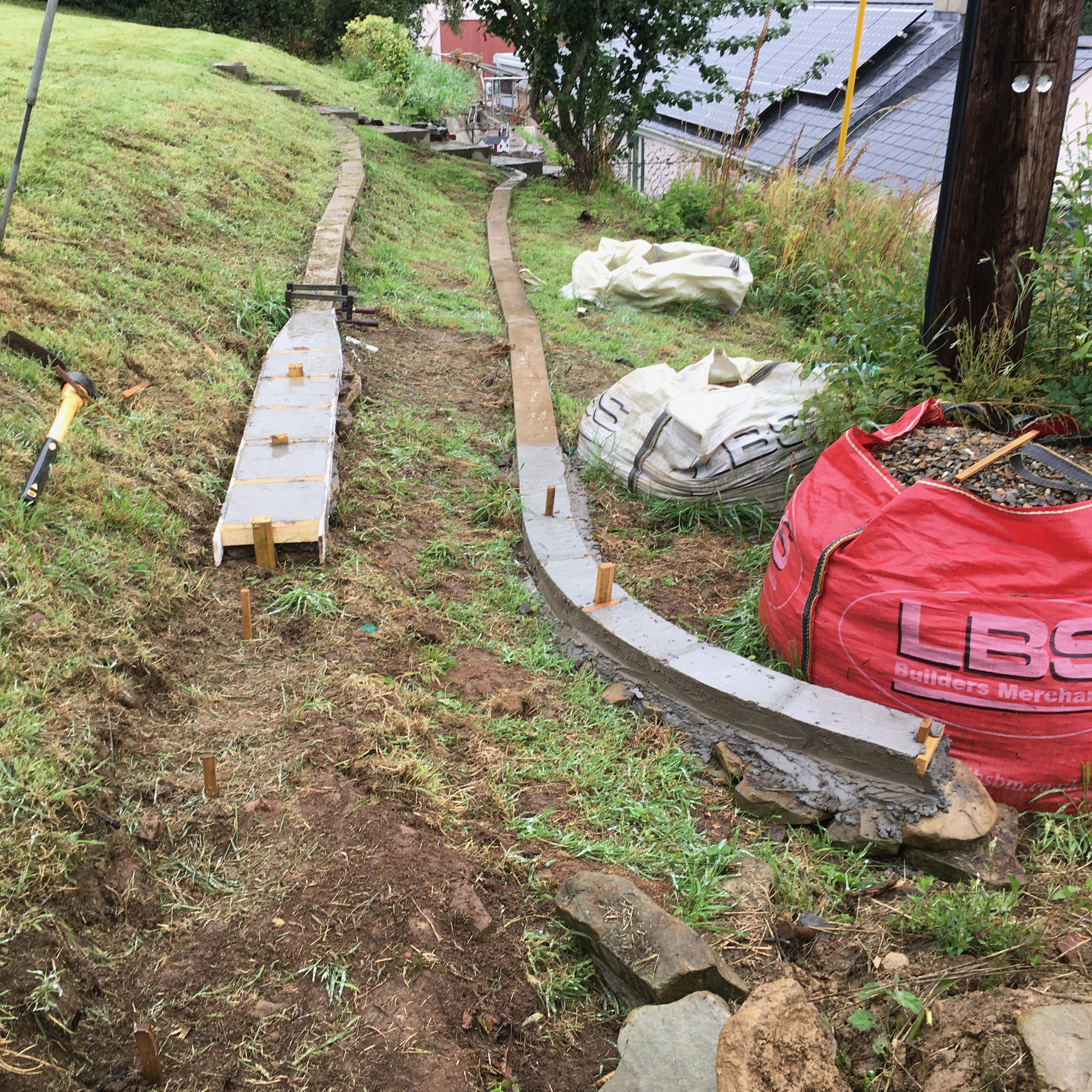

And I have finally got back to extending the railway. The lower side has reached the point where it starts the 5ft radius circle to reverse the direction to link up with the upper section.
While I have used concrete gravel boards for the "straight" sections I am going to cast the curved parts in situ. When I say straight I am not trying to make them dead straight - more ambling along the contour like the real thing. So the shuttering is in place and the spirit level used to check the rise and the level accross the formation. Just rocks to pile into the bottom and concrete to mix. Then I can make a passing place in the other leg before that also starts to curve over the void.
How to deal with the void? The loop is going to be on part of the garden which is sloping down to the road sharply. I think I am going to make a wooden tresel viaduct for that part. Not very north wales slate railway - but I think it will be the swiftest way and involve the least effort. We will see.

- Posts: 728
- Location: Staffs. UK
Trevor,
Station is looking good, and the permanent-way, permanent!
For the station roof-lights:
Perhaps thin horizontal frame-members, before the verticals, to disguise the adhesive?
Just a thought?
Just a thought?

A valid thought - I will experiment
- Posts: 1196
I agree with Phil, some horizontals would do the trick. It's all coming together well.

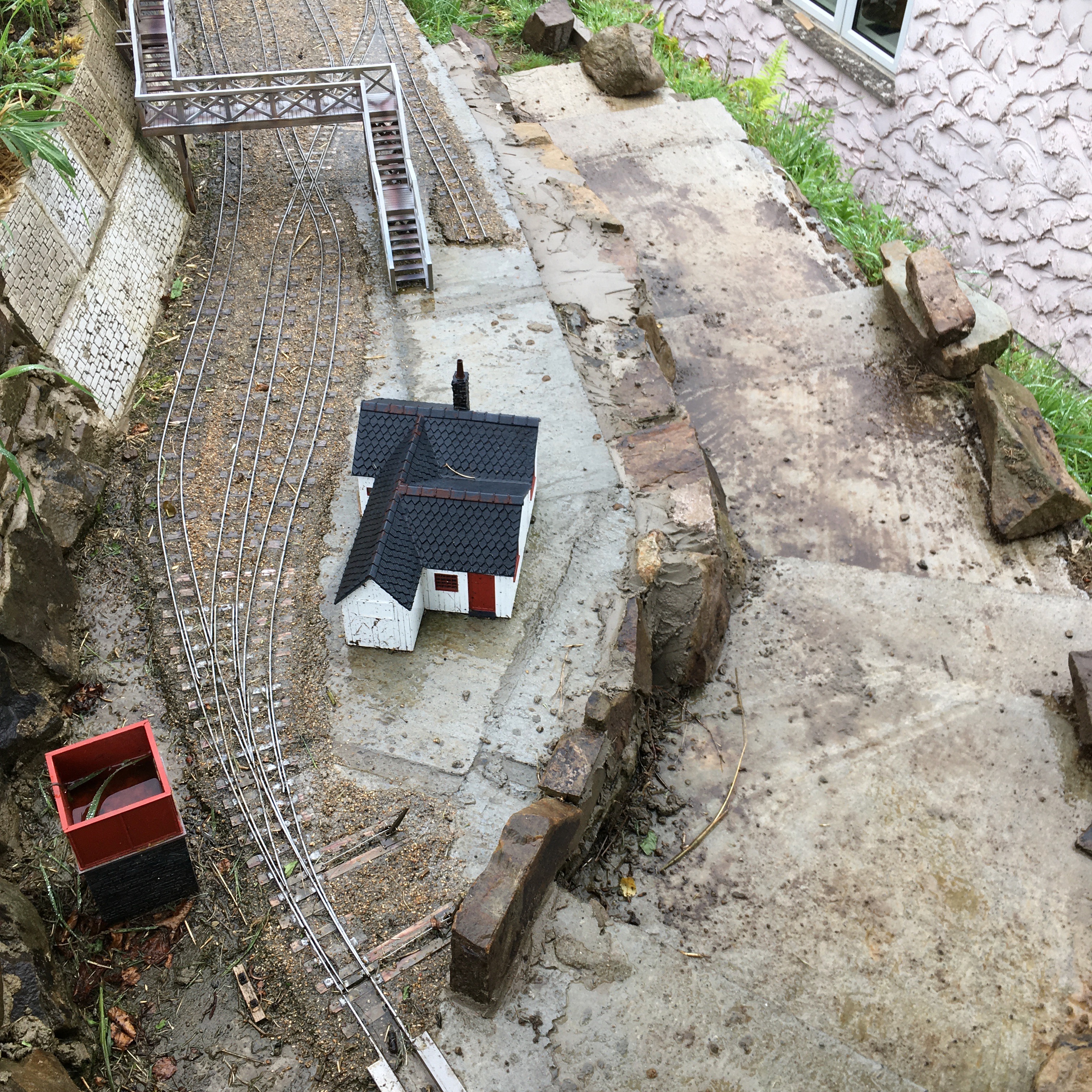

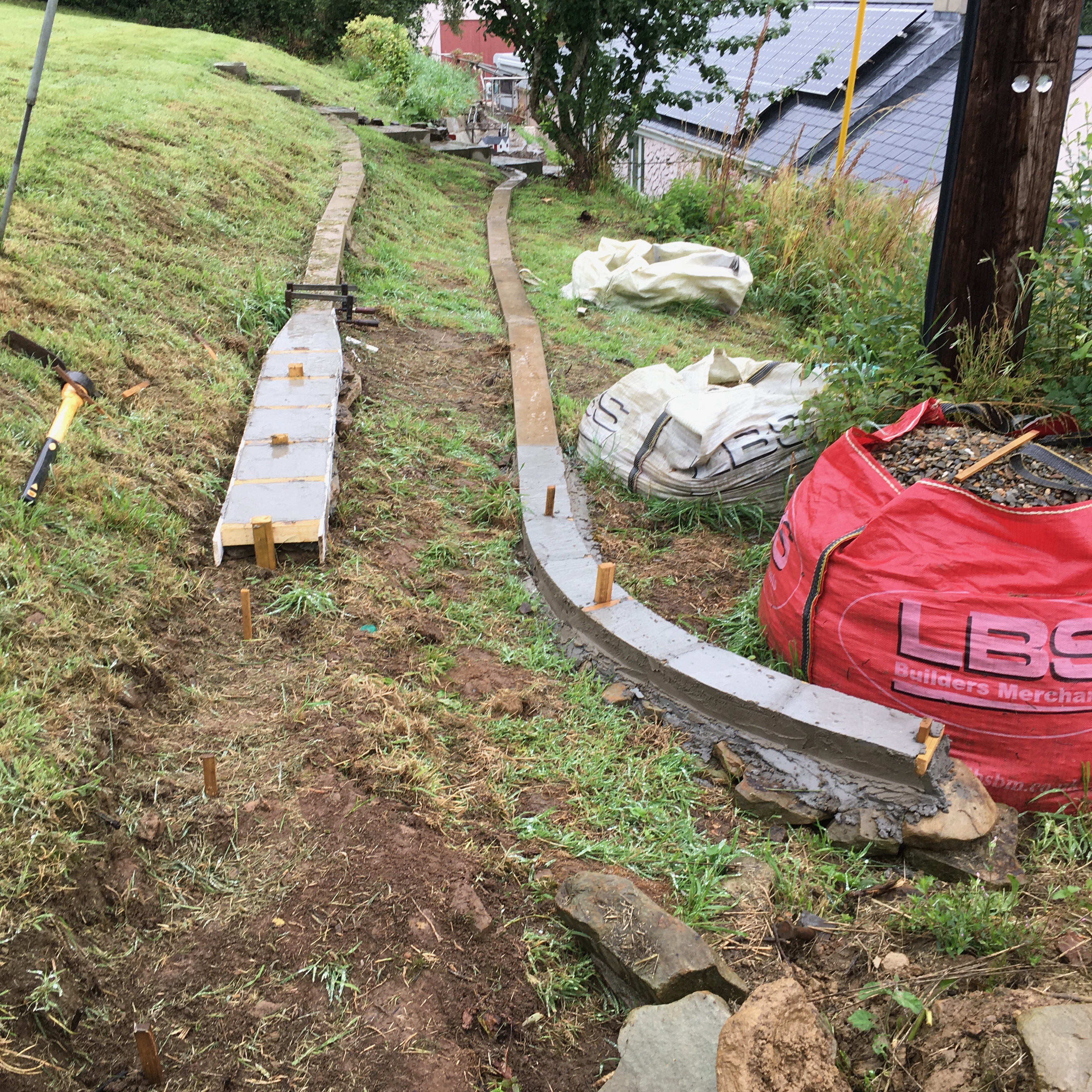

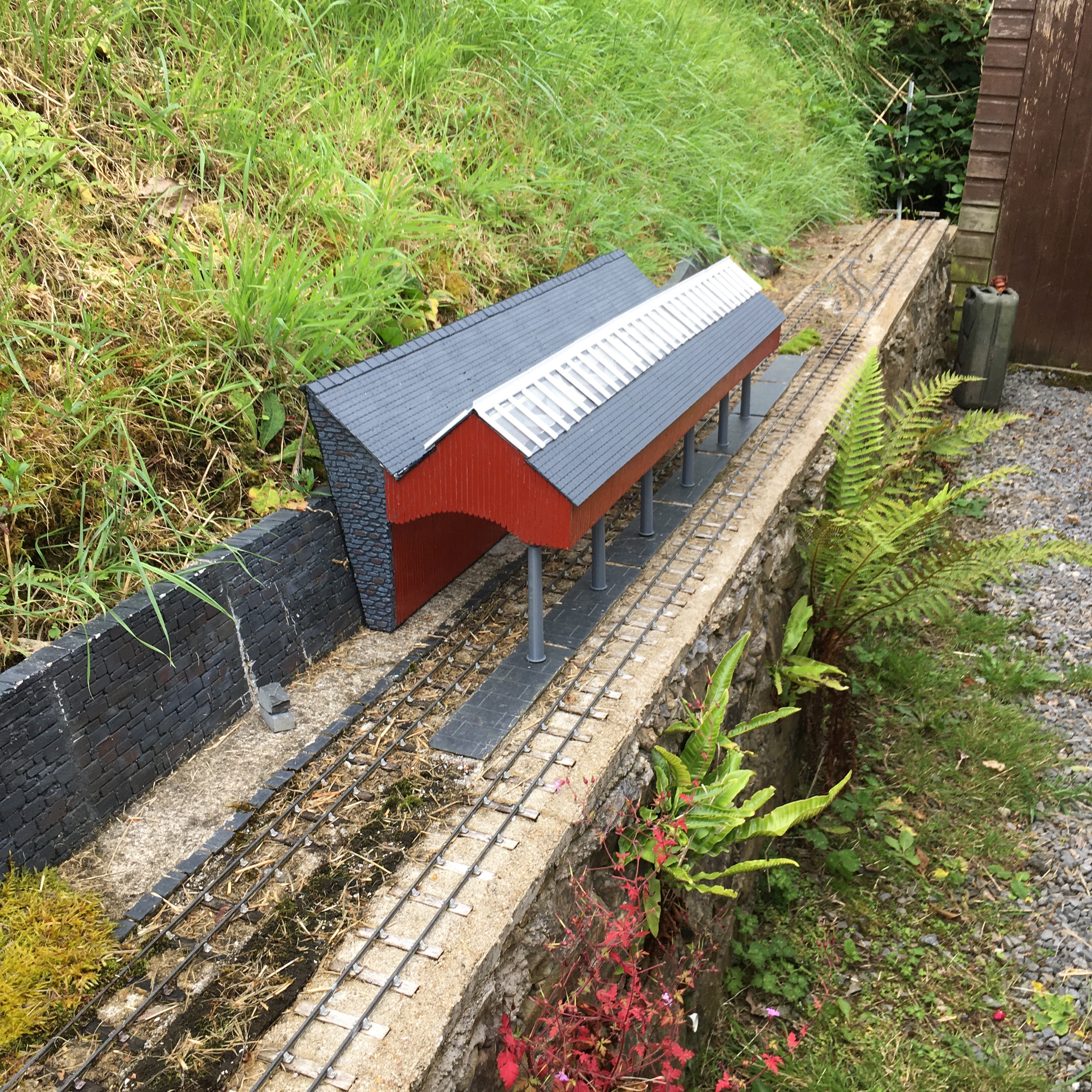

Still making slow progress.
The station building is now in place on the line. The black mastic isn't very obvious - at least not unless you are up close to it. I will live with it for now. The vertical glazing bars do tend to draw your attention away from the black edges.
The extension is moving towards the void:
So the first part of the curve is in place and the first half of the passing loop is shuttered and poured.

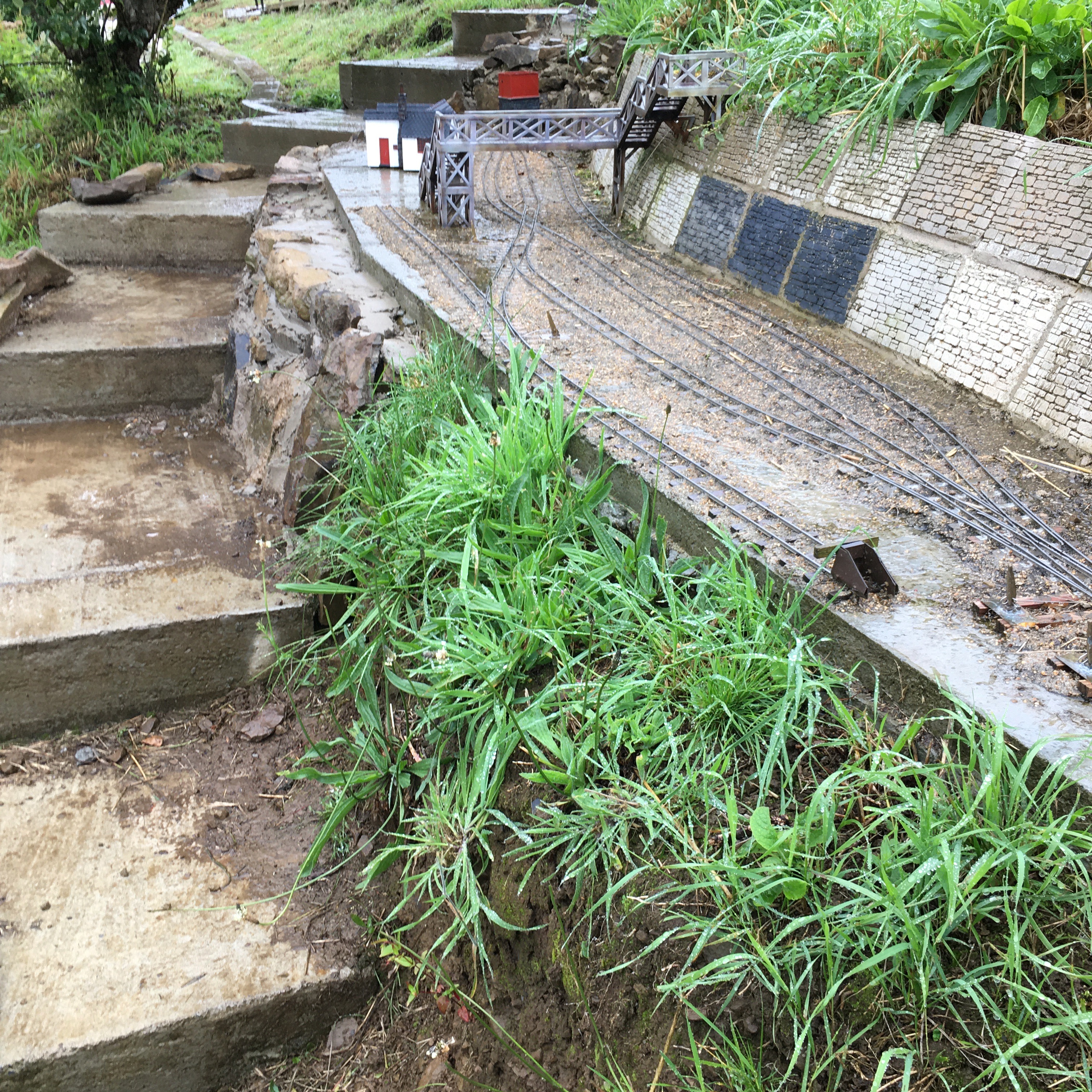

I am also going back to finish the earlier extension. Some form of finish is required on the vertical bank or wall which is between the railway and the footpath. I had intended to use wooden half posts - but I just happen to have mounds of stone from old buildings (and from the ground) and it seems an obvious way to face the surface - if somewhat time consuming. I have to find a way of keeping the weeds down, and covering the soil with something solid will do that. So I have started at the station end - as much because I want a wider shelf for the railway at the station - so that seems like an incentive to get started.
So half of the station area has a wall under it. When the other half is walled I can make a concrete extension to the shelf and re-lay the siding and nearest passing loop. That will make room for the goods shed which is ready fit.
This isn't as a result of my making a mistake but having found more information as to how that unusual track layout was actually used, which changes where I want to fit the goods shed. It should be on the nearest loop, beyond the footbridge, not over the siding - in the foreground of the following photo:
This shows the wall better than the last photo. It looks like the wall makes the steps narrower but actually I have removed soil before building, so it isn't actually narrower - but more vertical. so there is a wider shelf for the station without loosing much width on the steps. You can also see the need to control the growth in the foreground!
- Posts: 6075
Looks fine in the picture, and once your weather has done it's worst, I doubt that even you will notice!Trevor Thompson wrote: Sat Aug 14, 2021 9:28 am The station building is now in place on the line. The black mastic isn't very obvious - at least not unless you are up close to it. I will live with it for now. The vertical glazing bars do tend to draw your attention away from the black edges.
It's all looking really good IMO and it doesn't seem slow progress to me, given how many labour intensive bits you are working on at the same time.
- Posts: 5731
All looking very tidy Trevor. At first I was concerned about narrowing the path, which is already quite tight, but you have addressed that with some excavation work.
- Posts: 8052
I was very intrigued by the use of that diamond crossing beneath the footbridge. Was there a particular reason the tracks needed to cross over like that? I'd have thought that arrangement shortens the length of the passing loops. As you say it is unusual.Trevor Thompson wrote: Sat Aug 14, 2021 9:40 am This isn't as a result of my making a mistake but having found more information as to how that unusual track layout was actually used, which changes where I want to fit the goods shed. It should be on the nearest loop, beyond the footbridge, not over the siding .......
I'd be interested to know that too, most intriguing... Love the curved three-way point what a beast!ge_rik wrote: Sat Aug 14, 2021 5:26 pm
The whole layout's looking very good indeed, like the new Corris-esque station very much. Something like that's on my list if I ever return to freelance modelling...
