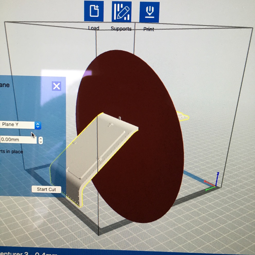

So another approach. Im going to cut it into three parts and print each flat on the bed. This slicing software allows me to position a cutting plane where I want to cut it and then cut:
I have cut it twice and laid all three parts flat on the bed. Added the supports. This time the supports are much shorter. Less time. Less filament. Less electricity:

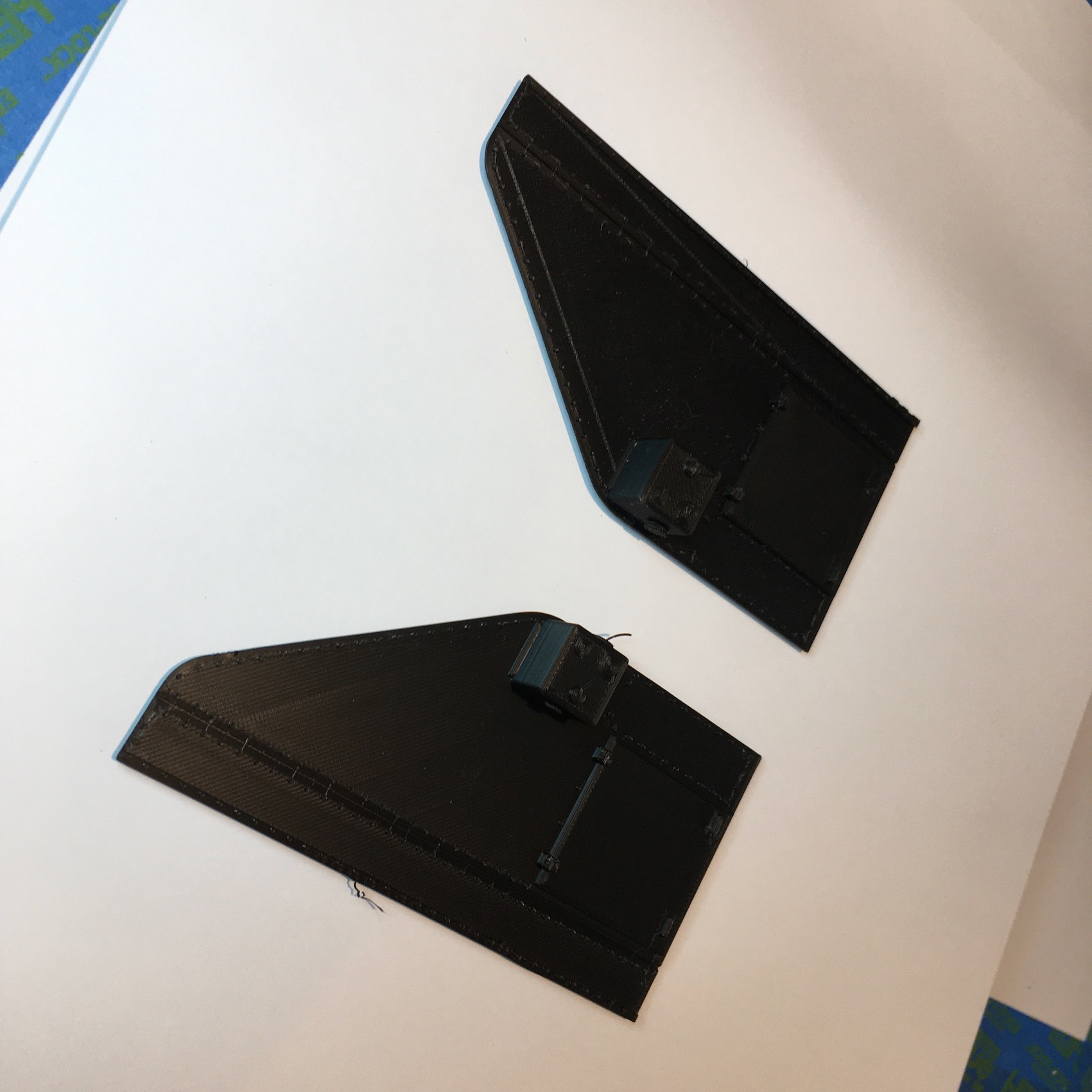

The last photo on the last but one post showed the spectacle plate printing.
Let me share the results with you:
Firstly the print was mostly successful. The top surface is really good:
The only minor issue is that 3 rivets are not there. You might just be able to see them on the right under the window as you look at it. That was caused by the three rivets sitting in space a short distance away from the plate. I went back into Sketchup and lowered them onto the surface. However I am not satisfied with the reverse face:
You should be able to see the lines of filament passing diagonally between the spectacle plates. many of them are loose - not attached to the rest of the model. This spectacle plate is also a bit thin. Too flimsy. It is probably the result of tracing off the drawing, which encourages me to make things to scale thicknesses. I had the same issue with the footplate and that was certainly caused by tracing it.

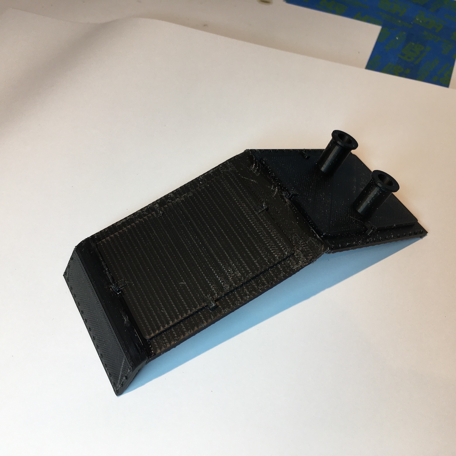

The engine box lid and top has now printed. Here is the result straight out of the printer:
This has worked as well as I had hoped it would. The surface is very smooth - and ready to just paint. However when I print things on their side like this (roofs are normally printed this way around) there is a tendency for the layers of the model to part. It isn't visible in this photo but it started to show as I handled it. The solution is to bruch acetone over both sides of the component. It makes the surface unevenly shiny - but doesn't otherwise effect the surface finish like it would do if you did the same to an Aifix model with solvent glue. the square lumps on the model are the supports that th eprinter uses to support overhangs while it prints them> They just fall off when you rub a finger over them. They are not attached at the side just at top and bottom.

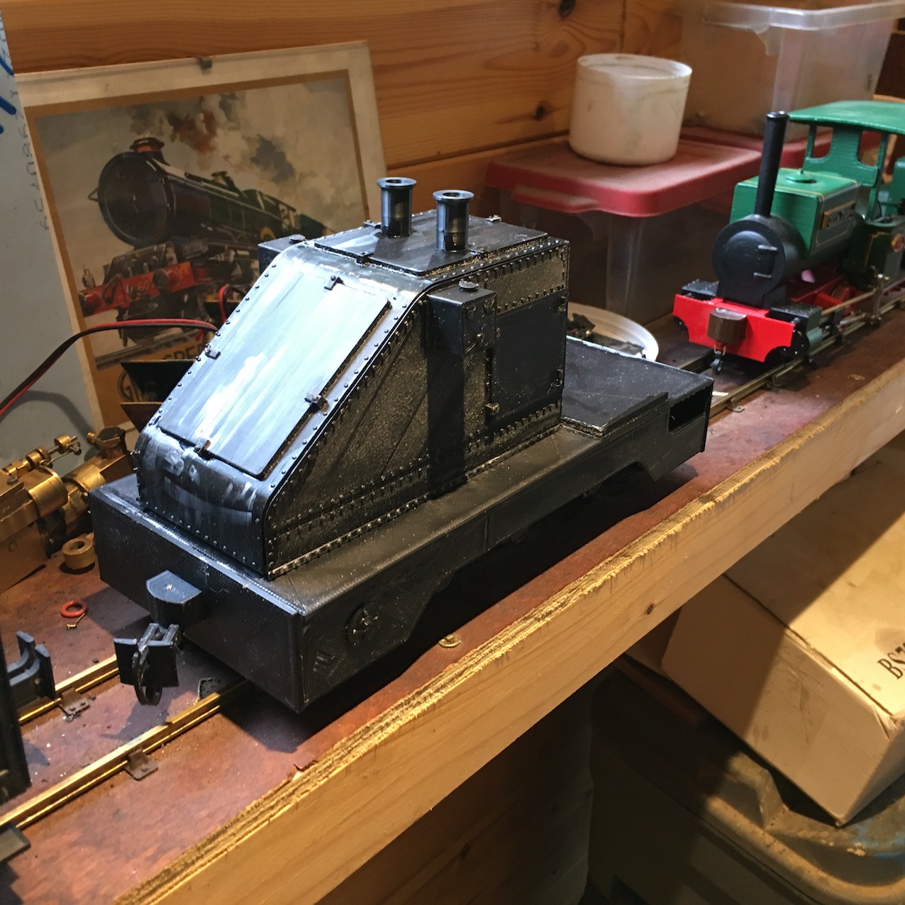

So the same part with the supports removed, and fitted into position on the chassis:
I have yet to work out how I will fix the engine cover to the chassis. Perhaps 2 frames glued inside the engine box and screws holding it down from underneath. I could just glue it on after fitting the batteries. Decisions regarding batteries and radio control have to be taken first:
It is beginning to look like a loco (but it is a pretty ungainly looking thing!)

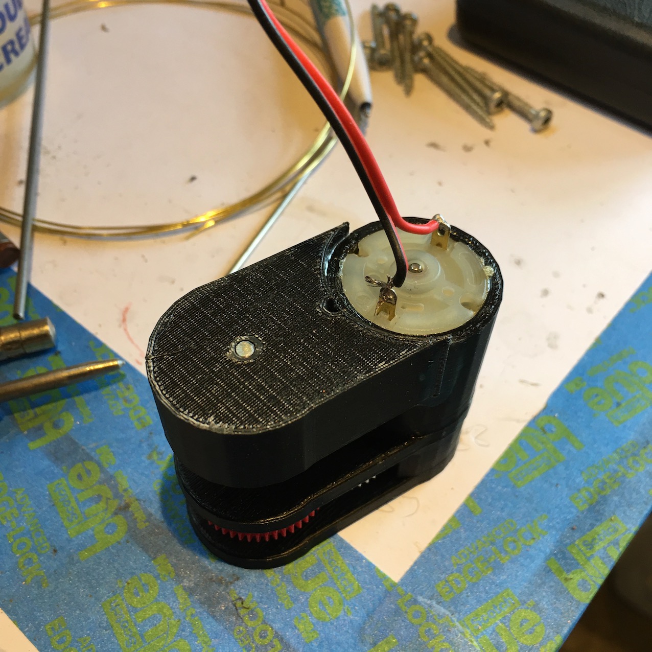

Have to print the redesigned gearbox next.

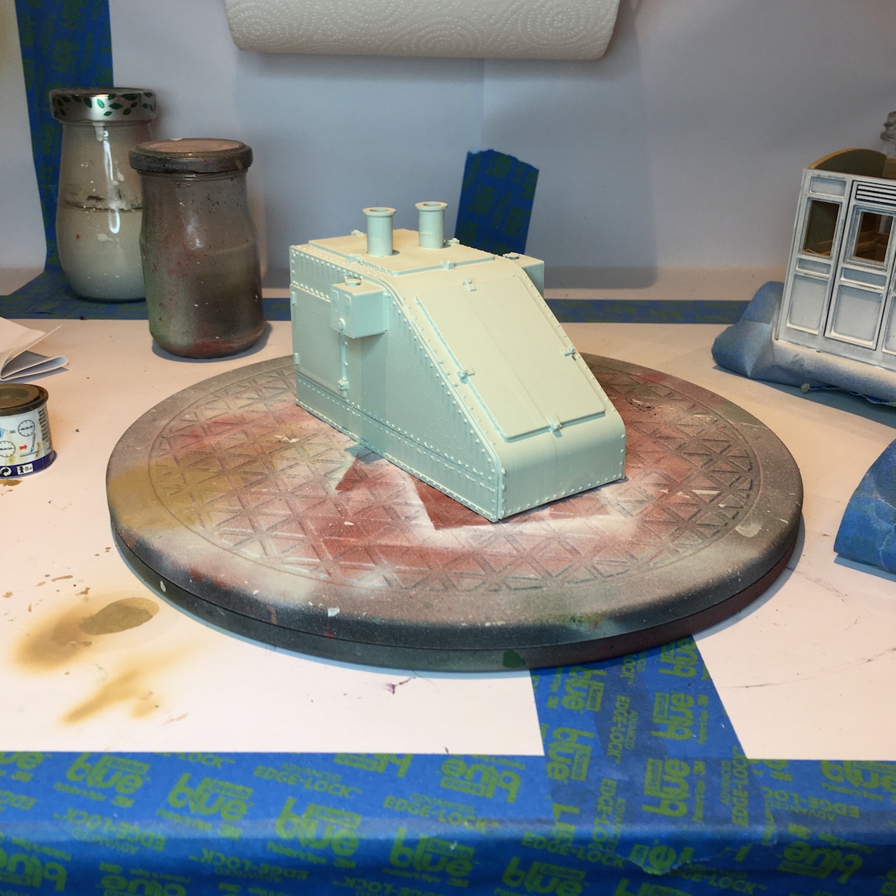

I thought you might like to see what the engine casing looks like when ti has some paint on it. So a thin coat of Valejo acrylic polyurethane airbrush primer, followed by a single coat of thinned Humbrol matt Eggshell blue which I found in the box of paints:
And showing more of the front:
The coach in the background has had a very thin coat of the same primer. The locomotive seems to have been painted in a light green, and had the makers name on it in large white letters. So there are a few more coats of paint to go yet - and that can wait until the model is nearly complete!

The gearbox.
It consists of three parts as shown in this view:
They were printed with the side which is on the right of each component flat on th ebed. Printing small parts like this at 5 degrees higher than default makes the face nearest the bed solid and clean. It does make it harder to separate from the raft. The holes for the shafts were opened up with a 3mm drill and then reamed 3mm. Sounds wrong but the plastic cuts undersize. To assemble 3mm shafts were temporarily inserted to align the holes and the end cover bonded to the motor housing:
When that was solid the third component was added. It did need a bit of filing on its mating face because it was an interference fit! It was gently held in the vice and bonded into place:
Note that this third part is thicker because it locates the chain wheel and gear. It is also glued on so as the whole assembly just fits between the frames. That means it can be glued in with my usual acetone. The gears have now been assembled onto their shafts:
The red gears and sprocket are an interference fit on the 3mm shaft, and the grey one a free fit. That meant that the upper shaft was just pressed into the tight hole. However the lower shaft required its holes drilling out to 3.2mm. I said it cuts undersize! The motor has been fitted and lightly bonded into place:
Finally the assembly was fitted into the frames on 4415. It needed the chain shortening by 2 links, but that means there is less slack in the chain:
