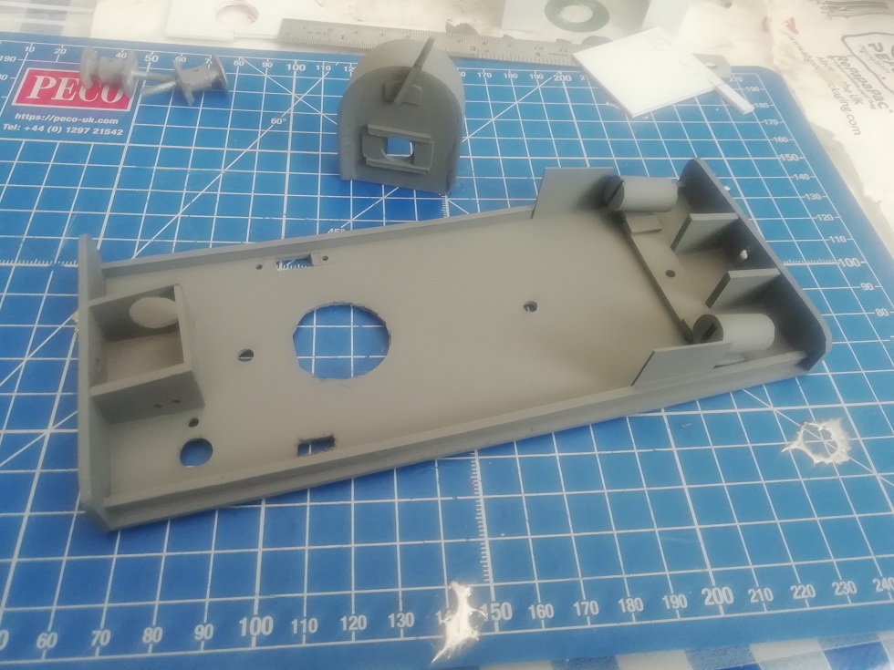

I haven't had as much time as I would like to work on the Bagnall recently (know the feeling, eh?) but have at least managed to get some work done to complete the chassis. The photo shows the underside of the chassis, now in primer, with the motor block removed for painting, with holes added for the various switches and connections. I spent some time deciding where these should go, given the loco's limited internal space. On the underside of the loco will be the DPDT switch (to switch between run and charge) and the charge socket. The speed controller will be mounted through the cab floor (hoping to disguise it as a handbrake standard) and the reversing switch on top of the tank extensions inside the cab. The inside of the boiler will house the 3x NIMH AA cells, which it's just the right diameter for. The temptation is to forget about all this and crack on with building the body, as I don't really enjoy wiring, but it certainly seemed wise to consider all of this before putting the whole thing together.
Also in this photo is the 'firebox' with a home-made regulator handle, so at least the driver will have something to hold on to. I'm also incorporating a light-up 'fire' using a flickering orange LED. Might come across as something of a gimick, but I think it will add a bit of interest and life to the model.
Hope everyone else's projects are going well, and wishing you a good weekend.
Tom

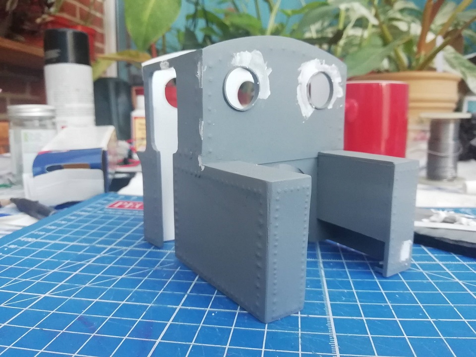

Posted: Mon Jun 22, 2020 6:08 pm
by Tom85
A quick update. The cab / tanks assembly has now been given a first coat of primer, after which I've been applying filler to rectify small deficiencies, mostly around the spectacle plate inserts (made from strips of 0.5mm plasticard). Also shown is the underside, with M3 square bolts added. I decided it would be a good idea to be able to detach the body from the chassis easily, in case of any future wiring problems (quite likely given my soldering 'skills') or, perhaps, the addition of radio control.
